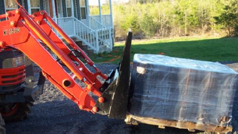

It’s baffling to me to read complaints that the 1590's lack of lifting and rollback power. I've handled pallets of paving stones (400 pavers * 7 lbs 5 ounces per brick, 2950+ pounds) with my loader. I was able to unload the pallets (pickup only able to haul one at a time) and transport them from staging area to work areas as needed. The loader had no problem lifting the pallets but it did not have sufficient rollback power to level them. The loader did hold the pallets at a constant angle (shown in the picture) from the height of the pickup bed down to the transport height.
My educated guess would be when designing the 1590 the engineers assumed loads would extend no further then the bucket edge. It would explain why they set rollback power only sufficient to curl the max load 19" inches from the pivot points. When we add a QA plate and use pallet forks or bale spears to lift loads 3', 4' or 5' away from the bucket pins we are applying loads that exceed the design specifications. It would have been nice if the original design considered these loads, but it didn’t and the specifications reflect this fact.
As this tractor represented a significant amount of money to me I spent a lot of time comparing the technical specifications of various tractors and FEL combinations. The 1590 delivered with my tractor meets or exceeds the published specifications. I don’t claim the 1590 design is perfect, rollback power and angle could be improved, and like most American males I want more. I don't expect Kioti or KVM to upgrade my loader to a new specification level for free, though that would be nice. It would be a smart investment in customer loyalty to supply the upgrade kits at cost to current owners.
