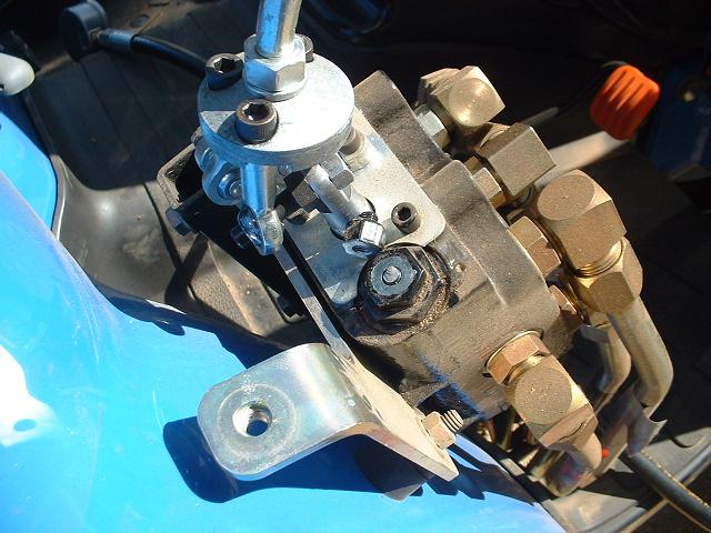

Please add me in line for the test gauge also. I have a TC33D/SS with 7308 and cannot lift the front end with the boom cylinders even with a 5ft. box scraper on the rear 3 point. I cranked in the FEL screw enough so that the relief there didn't pop any more, but I still could not lift the front end, so I am wondering if my main system pressure is low. I would like to try the gauge to see if I am able to get 1800psi in the FEL circuit.

After reading this post I checked to see if my TC33D would raise the tires off of the ground and found that it would not. I had a spare male disconnect nipple so I put together a gauge setup of my own to try. I found that my relief valve was tripping at 1600. I adjusted it to 1900 and it will now lift the front tires off the ground. I would like to check to see where the main system relief is set. Does anyone know where to check it at?

Everything checked out A OK. /forums/images/graemlins/cool.gif 1700 PSI @ 1000 RPM (idle) and 1875 PSI @ 2600 RPM. Didn't touch a thing. Thanks again for the use of your guage. Hope it works as well for everyone else as it did for me. /forums/images/graemlins/grin.gif

I cant believe it! Made first adjustment and went from 1600 to about 1800. Went to make another to get to 1850 and the dang set screw sheared off! (see attachment) I've bled alot of brakes and know how to do this. The allen head screw is just pot metal. Oh well I am now able to lift the front end. Thanks Spencer for the use of your nice setup. Thanks Rip for the excellent instructions. TC33 no longer needs the gauge so Boomer33 please send me a pm with your address. Thanks
Dave
