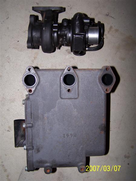

As you can see in this pic, the suitcase is a little bigger than the turbo.

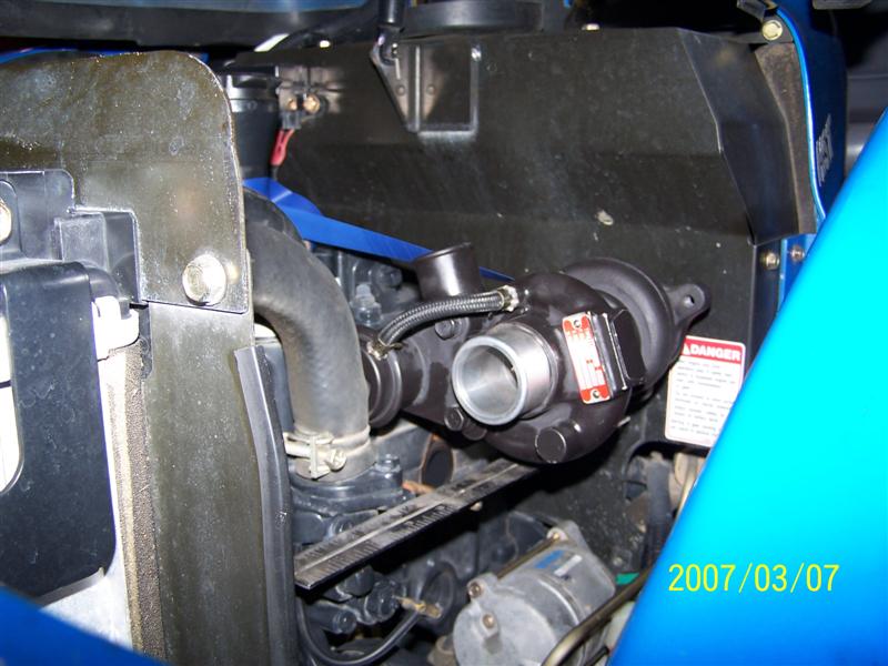

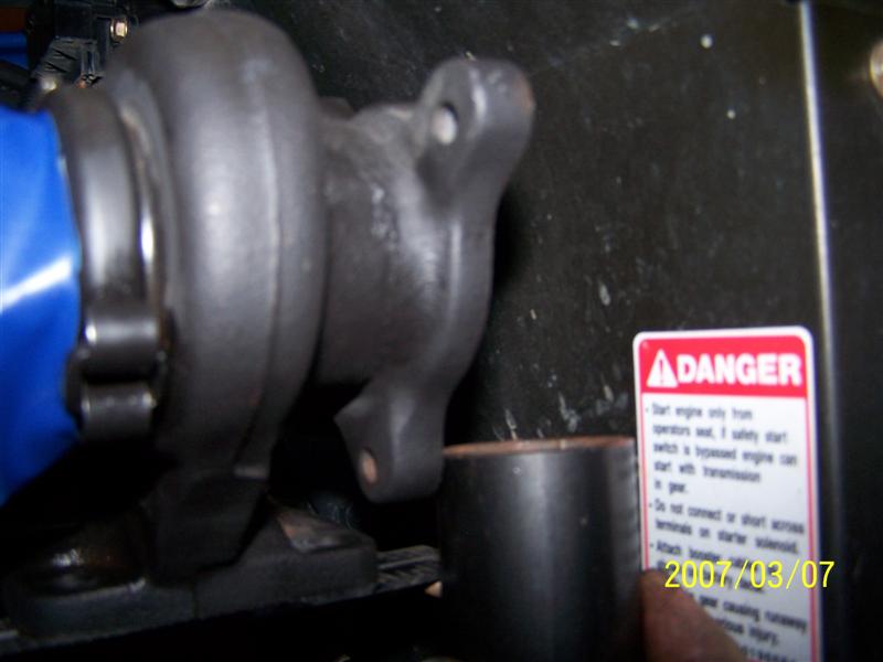

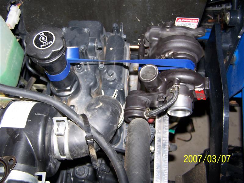

Here are a couple of pics looking at roughly how the turbo will set in place. I may end up having it set up a little higher than this because of how the manifold may end up fitting after fabrication.

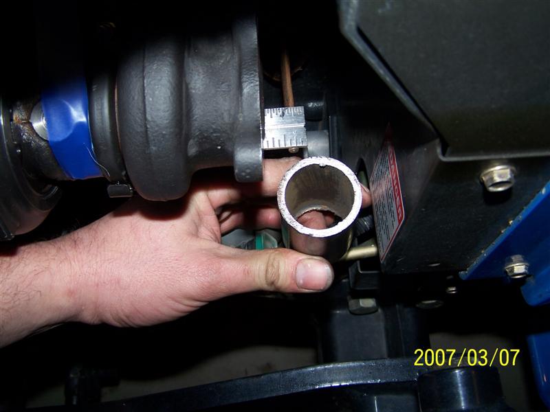

As in one of the earlier pics, you saw the exhaust outlet side of the turbo. I will need to fab up a plate with a elbow to cover that as the guy I bought the turbo from did not have the turbo exhaust manifold. This should not be any big deal, however I only have a limited space between the turbo and the firewall.
The next couple of pics will give you an idea of the space. I'll be using 1-3/4 pipe for the exhaust outlet. This is the same stuff that I used to make my vertical exhaust set-up. So, the exhaust will come off the turbo and continue down between the side hood shroud with a slight "kick out" to go past the starter and the power steering lines. It will then tie into the existing tail pipe.
You'll notice that there is nowhere for a muffler. Unless I can find something small to fit in somewhere, there won't be one! Several poeple I've talked to said that the turbo will muffle the exhaust some. I wear earplugs anyways so whatever. You should hear the turbo whine!

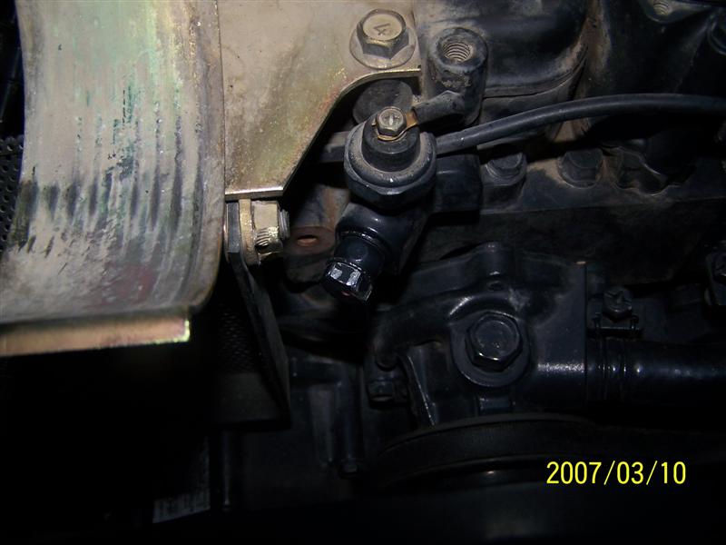

Now for the BIG problem! That is trying to get a oil supply to and from the turbo. In looking over the engine and leafing through the service manual, I found a tube that runs from the right lower side (looking forward) of the block up to the front of the valve cover. This is is where the oil pressure sending unit is and also this supplies oil to the rocker arms, rocker arm shaft and pushrod guides. Since I want to T-off of this location, I was concerned that there will be enough volume/pressure to supply everything. I decided that it would be best to increase the size of that line. The line is held at both ends by a 8mm banjo bolt type fitting. The size of the line itself is only 1/8" id aprox...real small. According to the service manual oil psi for this engine 45-60 psi.
The idea I had was to use 1/4" jic fittings into 1/4" hyd lines with associated fittings to connect everything. Keep in mind, the orfice openings on the engine and the turbo are very small so I am confident that volume won't be an issue
The problem is finding a fitting to go from 8mm 1.25 pitch thread into 1/4" jic. What I had to do is to get a 1/4" pipe thread to 1/4" jic fitting and have the pipe thread side turned down on a lathe to be able to run a 8mm die over it. The old man is a machinist and he is working on it now, should have the fittings on Monday. He said that there "should be enough" material to be able to turn it down and thread it. I won't have the lines made up until after the turbo is mounted. If this does not work, it may throw a wrench into the entire project. Another option is to use a 12v scavenge pump. but those are expensive and I don't want to rely on something electrical to supply oil.
If you guys have a plan B for oil supply let me know.
A pic of where the existing line goes into the OP sensor/valve cover.

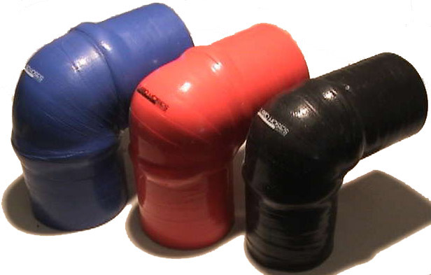

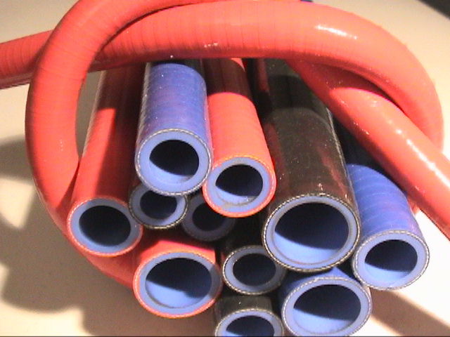

As far as connecting the turbo from the original air cleaner and then to the intake, I plan to use silicone hose made for such a thing. It will be a matter of getting the right bends, adapters etc. The most common color these come in is blue!
Sample pic of hose.
