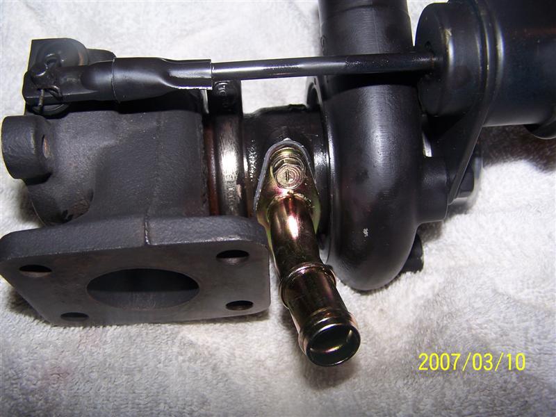

Today I recieved the fitting that goes on the bottom of the turbo for the return line. It is much larger than the supply line. So I figure that given the size of the return line, there should not be any problems with mounting a fitting below the oil level in the pan. If any there is any back-up in the return line, there would be some "storage" in the line to give gravity a chance.
Here's a pic of the oil return fitting which is 1/2" i.d. This will go straight vertical to the pan, so there should not be any problem with oil returning and backup into the center section of the turbo.

Mega_Me said:
...The concern with going in under the oil level is if gravity won't feed it well back into the pan, it could back up into the turbo and oil could seep past the seals....
If gravity won't feed it with the outlet below the oil level in the pan, gravity won't feed it with the outlet above the oil level either.
The gravity head draining the oil from the TC will be the difference in vertical height of the inlet above the outlet of the drain tube if the outlet is above the oil level. It will be the difference in height of the inlet above the oil level in the pan if the outlet is below the oil level. That means that you'll have more gravity head to drain the oil from the tube with the outlet below the oil level.
With the drain tube outlet below the oil level, oil won't back up in the drain tube unless the oil pan is pressurized to an absolute pressure greater than that existing at the inlet of the drain tube in the TC. The crankcase breather should prevent that from happening. Oil backing up in the drain tube for any other reason, i.e. the oil temperature in the drain tube is so low that the oil won't flow, or the outlet of the drain tube is plugged for some reason, would restrict the drain regardless of whether the outlet is above or below the level in the oil pan.
   / NH "T"urbo "C"harged 24DA #26
I was on a good turbo website today...Welcome to TurboByGarrett.com and they mention that in a wet sump system like yours the oil return should be above the oil level in the pan.

It was a good idea while it lasted. It seems that the oil return line has thrown a wrench in the whole deal. It will have to go to the oil pan, but in order to get the pan off so I can weld in a bung, the engine will have to be pulled......not going to do that.
I like the idea of the sandwich plate, but I'm afraid of the pressure on the return line??
