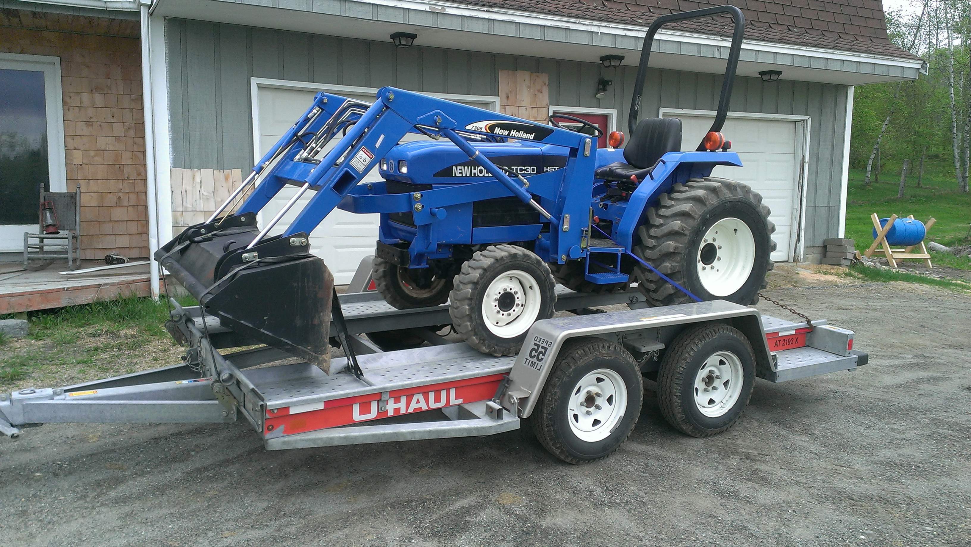

I'm picking up a 2003 NH TC30 4x4 w/R4 tires this weekend. Can anyone provide the measurement between the two rear tires and the measurement between the two front tires? The U-Haul auto transport trailer I hope will do the job has an open mid-span of 39". MAX width is not a problem. It's the 39" opening running fore/aft on the trailer that has me concerned.

I recently bought a TC30 as well and rented the large Uhaul auto transport trailer to get it home. The tractor BARELY fits on the trailer but it does fit. Your rear tires will be half off the ramps. Just be careful loading it and and chain t down tight and you should be fine.

Mariner, THANKS for the reply! Any chance you have a pic of the tractor/trailer from the rear so I can see how the rear tires fit once on the trailer? Jack
   / NH TC30 dimensions #6
I don't. Sorry. If you blow the picture up you can see the rear tire sitting on the ramp. I think they're about 1/4 or a little more off the ramps. Just go slow loading and unloading as there's not much room for error with the loading ramps. They do swing in a little which helps.
Got it. Thanks again!
