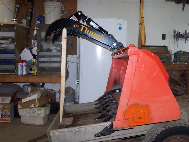

I installed my Green's Machine Thumb myself;third function installed by my dealer.I have the ability to weld and lots of tools.I welded an
angle iron to the top of the bucket with nuts welded to the bottom(for easy removal of thumb).I realize every-one doesn't have these capabilities.Very minor job for a weld shop. A little effort will save a lot of money.
