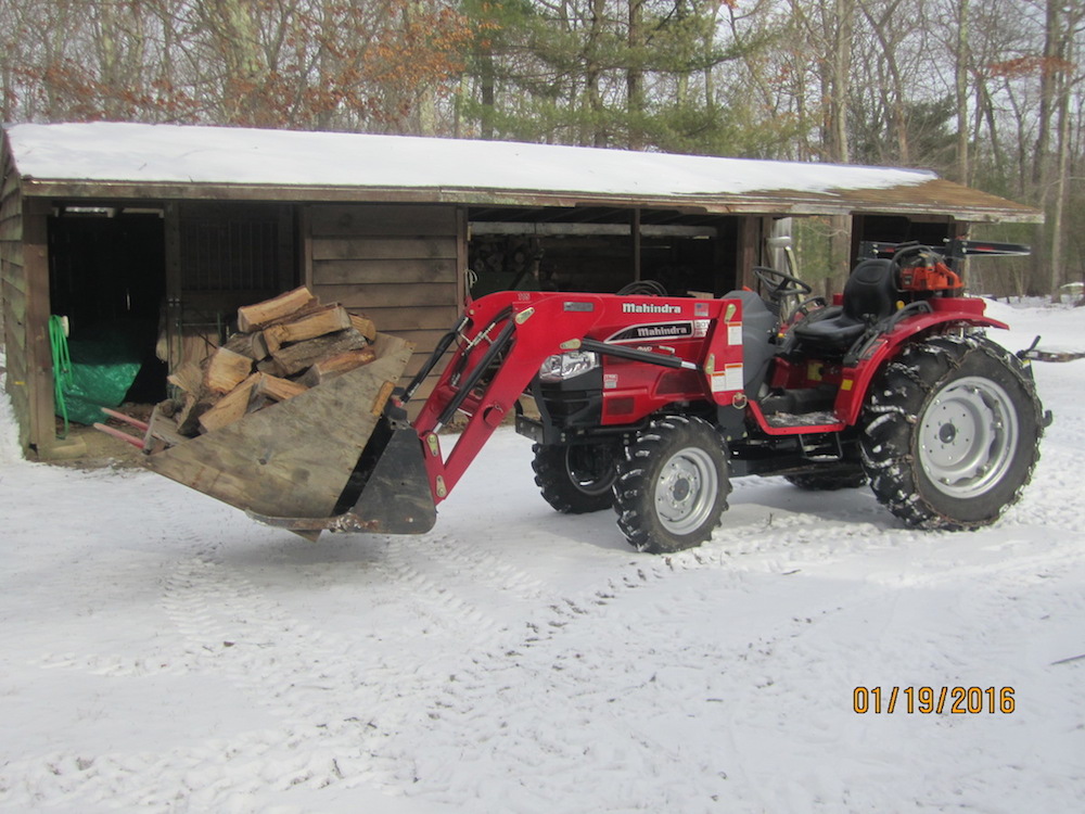

Hmm. Just in case you've misinterpreted. I actually "down sized" my previous recommendation. At first, thinking you were going to log your land of 180 acres, I recommended a 4000-5000 (before the fel and weighting) lb machine so you could take out larger loads if going greater cycle distances especially if you were going to feed a wood boiler.
Now that you've added additional thoughts, I am now saying you would only need a 2500 lb machine . This would be more of an overall tractor that you could use around the house to save your back. After the fel is added along with loaded tires, this tractor will now approach 4000 lbs. This size will do a lot of work for you without being gargantuan.

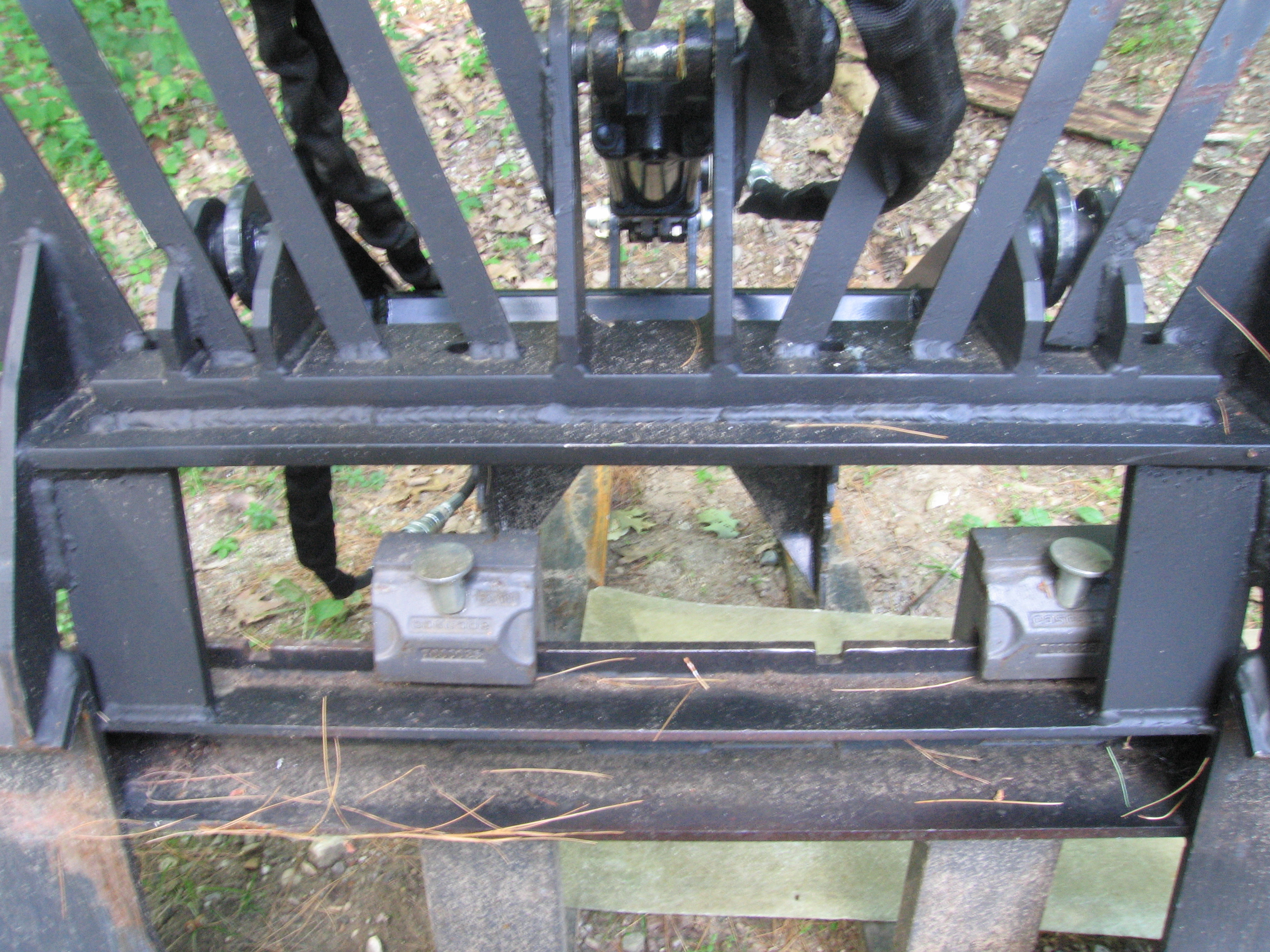

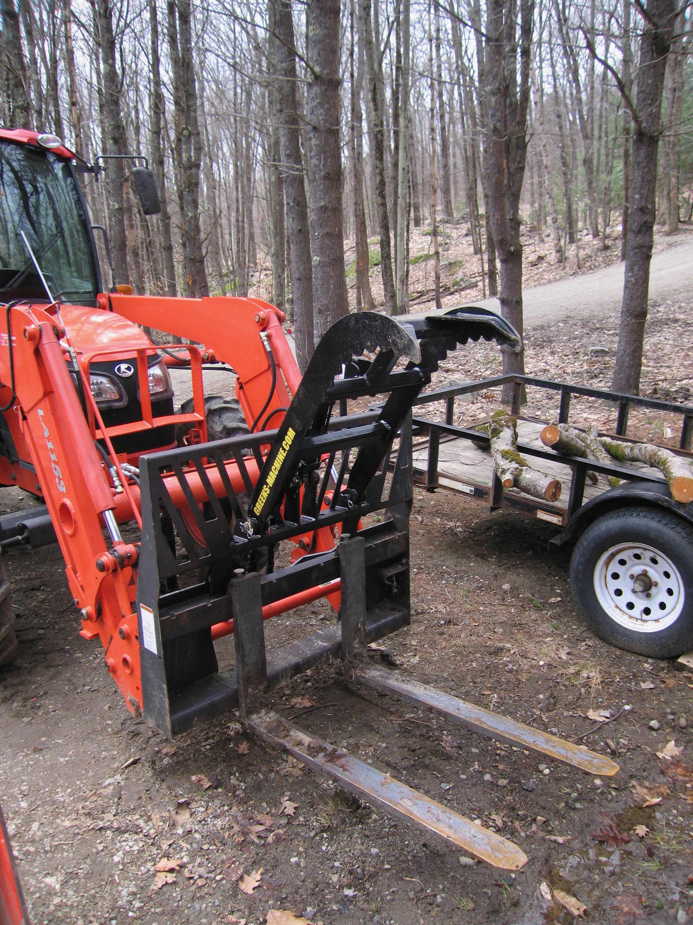

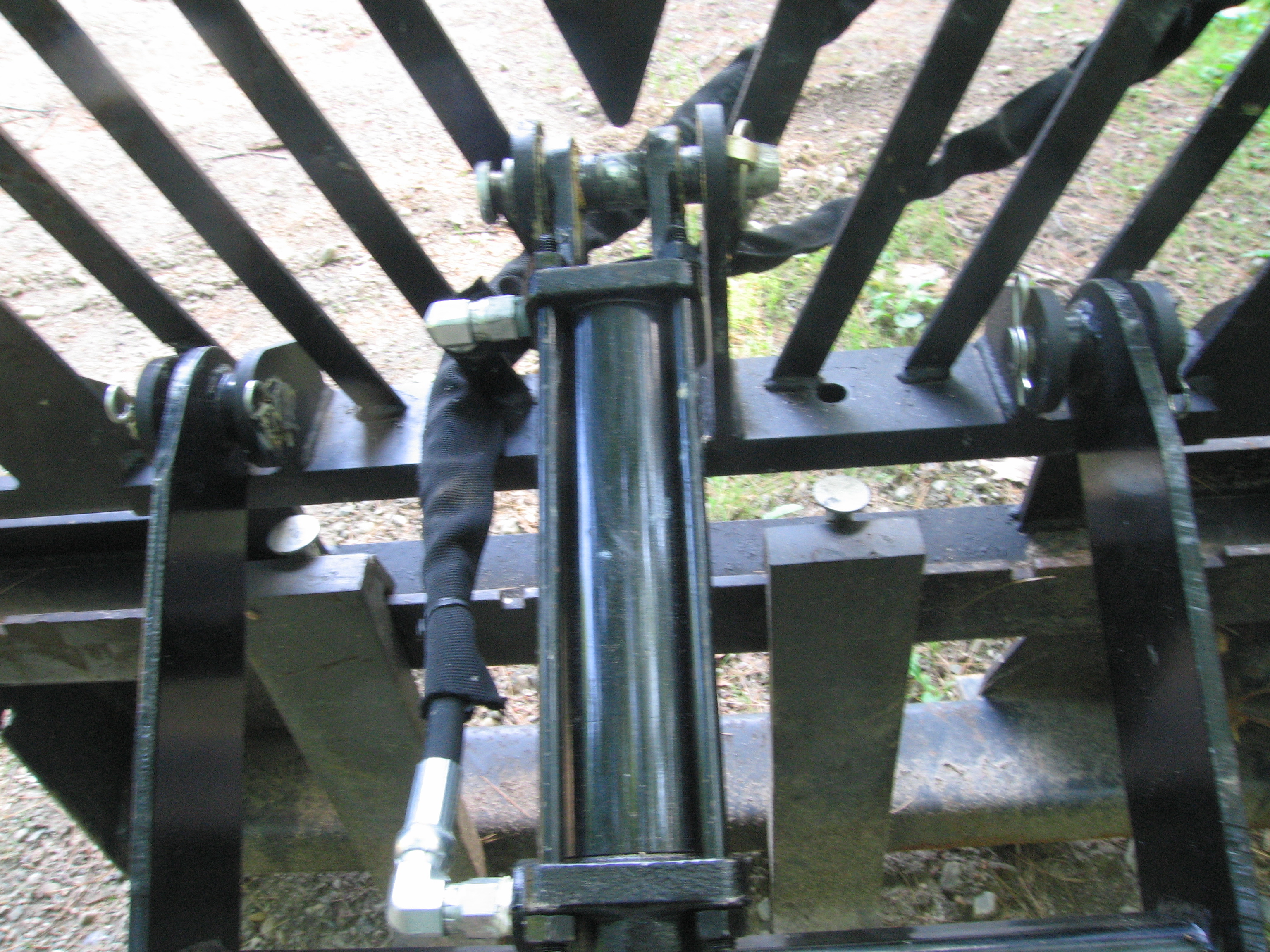

I had mine welded into my forks as bolting was not really feasible with the fork backer it has
