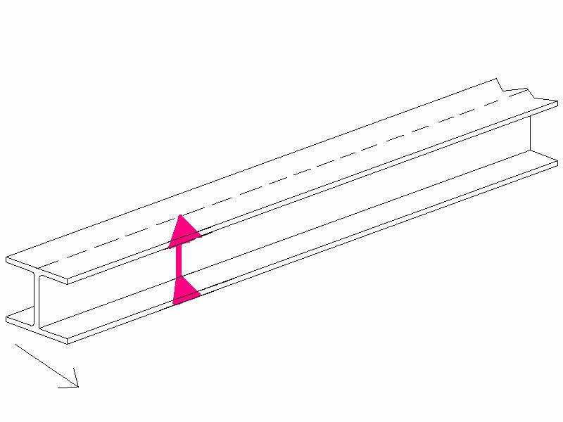

Not quite sure I understand your question. For most of my preheating needs I use a propane weed burner. Only time I use a rosebud for heat shrinking is to straighten beams. For tube, pipe, angle iron, C-channel, plate, etc, etc, I use a large cutting tip. Every once in a great while I'll use a small welding tip. Unless I'm mistaken here, I don't see you having to straighten any beams for awhile.;)

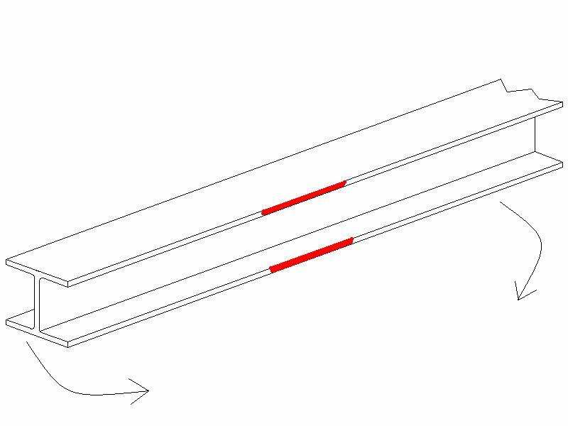

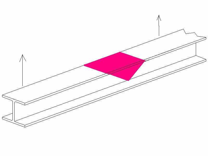

All depends on the volume, or the area mass you want to heat. I've straightened beams using two #12 rosebuds. But how many guys here do that for a living much less at home?
