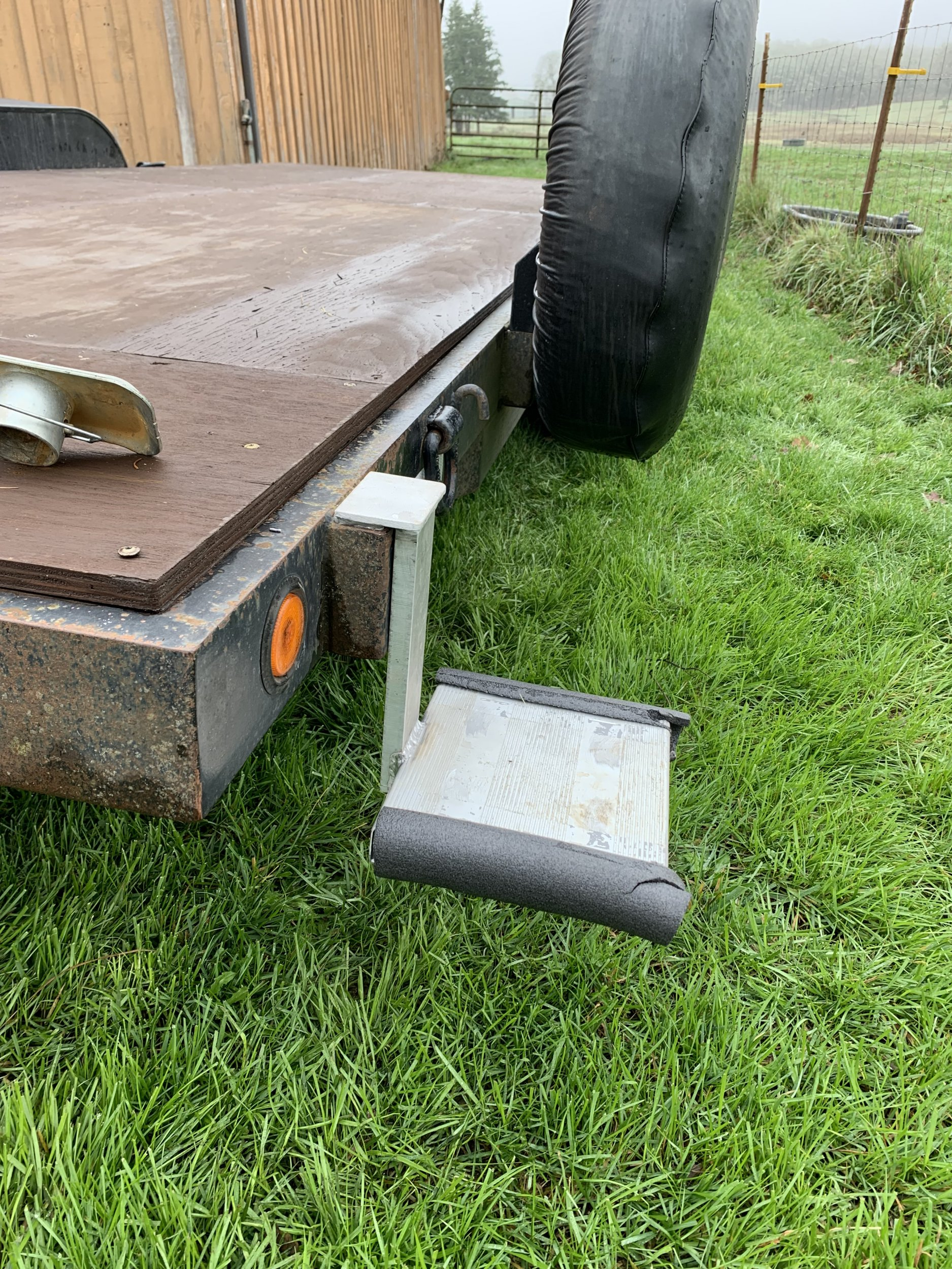

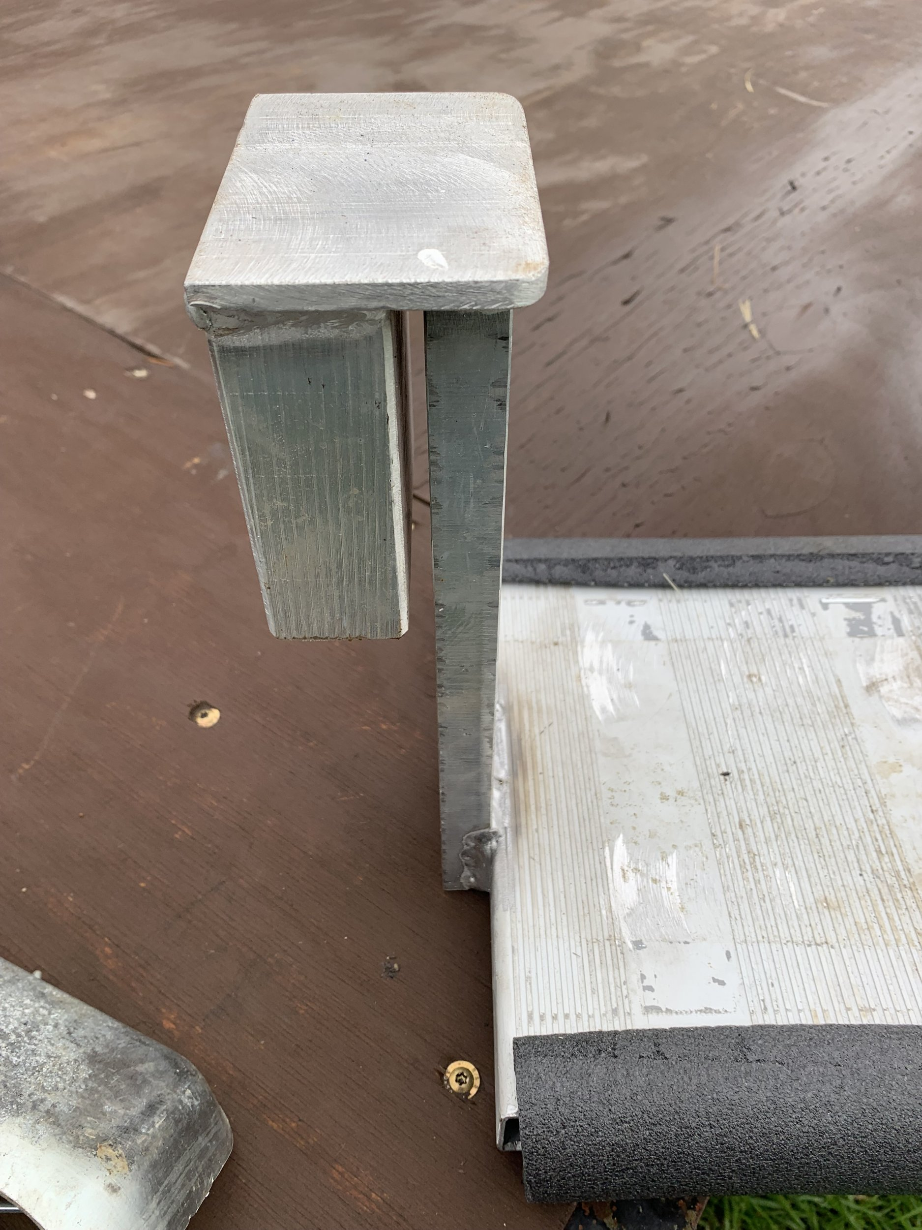

This was a "been gonna" project for a while. I made a mock up out of wood and screws.
I went to the scrap yard and bought the aluminum I wanted.
I cut it all to size, took it to a job shop and had it stuck together for 45 bucks.
The side pocke insert piece is solid, so is the outer lowering piece. Doesn't have to be but it is what I could find to fit just right.
The space between both sides of the pocket doesn't have to be too snug.
I remove it when I am on the road.
When I am on and off the trailer, the jump from the deck is more than I want to do consistantly.
The plumbing insulation on the sides is handy when I have it sitting in the barn and I don't knock my shins when squeaking by.
I do use Gorilla tape to hold the insulation on, but removed it for sharing the photos.
If you wanted to, you could make the outer piece out of a couple pieces of rectangular tubing, drill holes and make it adjustable.

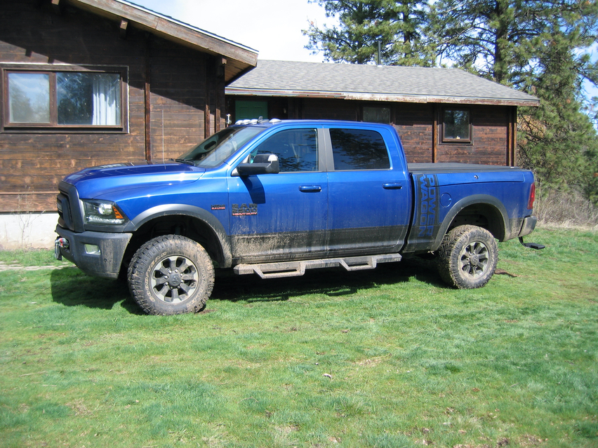

I have the same AmpStep on my Tundra long bed. I wouldn't be with out it. My veterinarian has a couple AmpSteps on either side of the front of his Tundra Supercab and likes them opposed to running boards.
