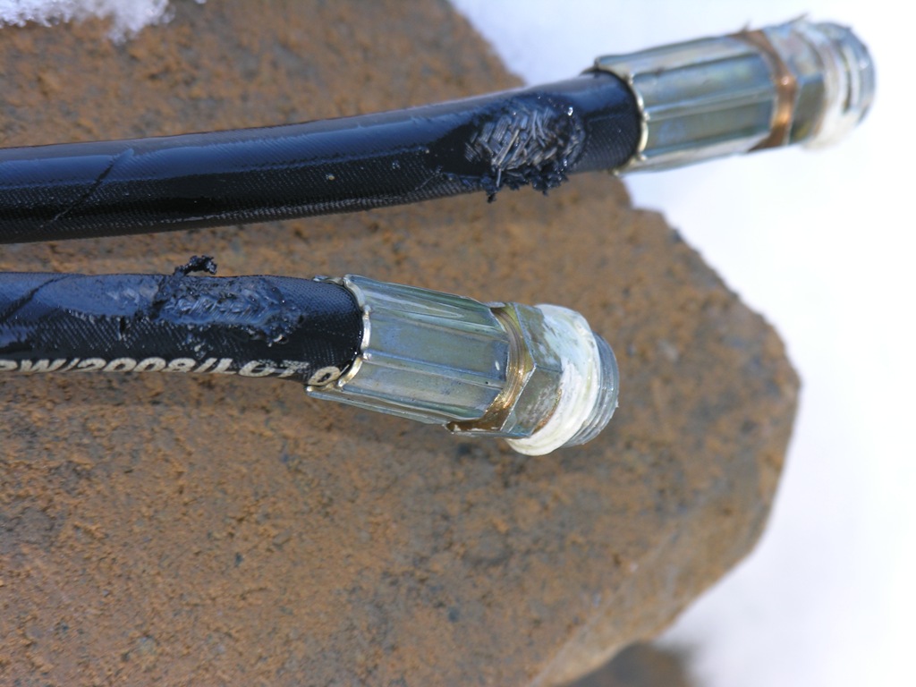

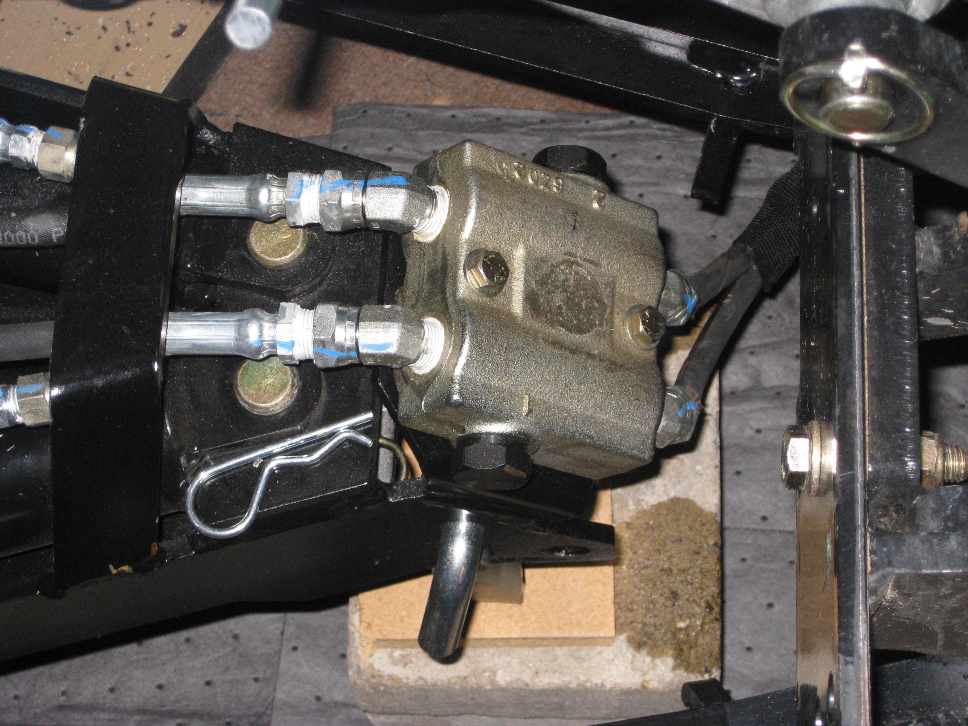

The hose is one of these two that connect to the pressure relief valve. I will take the hose off this week and get it replaced/repaired. There is a leak a little bit beyond the connector

Yep, i actually got a bit lazy and went to my local dealer and they repaired them both and sold em a tube of liquid tape for ~20 bucks. When i took the hoses off, both of them were punctured - or should I say smashed. i dunno what I hit, but I will be looking at putting some metal in the way to protect those hoses in the future.:rolleyes:

Yep it is a 366, the hoses are exposed and I think i dumped it down on some snow covered bricks or rocks Here is a pic of the hoses before they got fixed.

You need to check things...those hoses are worn through-that damage was not caused by a one time incident. They are rubbing something. Obviously Dutch knows something;)
