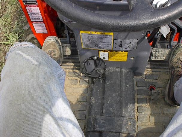

</font><font color="blue" class="small">( I have not even seen a gear drive in our area (northern VA). Want to check one out. Cant find pics of gear drive in brochure or website. Want to see the pedal/gear lever layout. Is it still an 'open' floor plan. I do like the operator room on the CK20H. Ease of mount/dismount is important to me. Will do lots of pulling/dragging with whatever tractor I get.)</font>
Here are a couple of photos of the CK20 GEAR platform/operator area. Hope this helps you. Gerard

thanks Gerard, looks like the only change is the small foot throttle.
