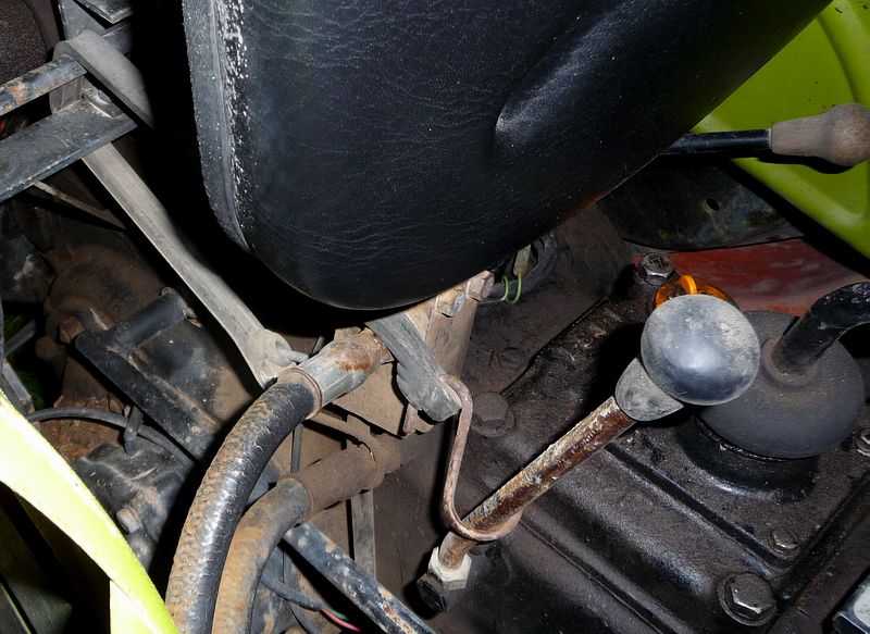

Me too. I have had this 'hack' on my YM240 so long I forgot about it. This bungee assists the weak detent spring/ball to stay in high range.
I took the bungee off when I bought the tractor to see what would happen. Nothing, until I was roading it fast down a rough dirt lane. When the driveline went slack lurching over a bump it slipped to Neutral a couple of times over a couple of months. That was scary going downhill. I put the bungee back on.
The hook slides down to the nut when the lever is forward (low range) so it has no effect there and doesn't tug the lever upward.
In seven years using this it hasn't jumped out of gear yet. Someday if I have to split the tractor I'll replace the detent spring/ball parts to get it right. Meanwhile - this simply works.
284 - I saw you were online and just remembered this, so I just now went out in the dark and took the picture. :D
