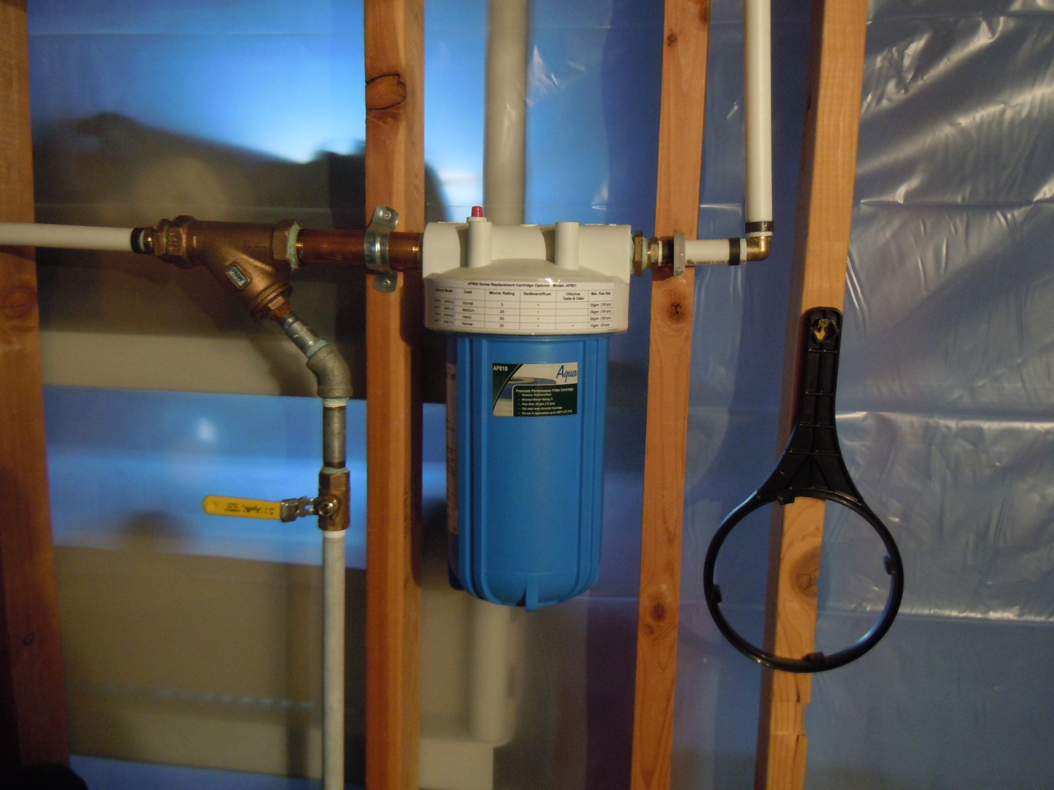

I had sediment problems for years until I installed a Y strainer and filter for the whole house. It didn't cost very much but sure has made a difference in valves lasting longer without any problems.
Every month or so I open the valve under the Y strainer and blow out any sediment. The filter lasts about 1-2 years.

I do have similar in Washington with well water... also have a basement.
The areas with the problems are rentals in San Francisco... water lines are exposed outside and then run under a slab... or into a 12" crawl space.
The only way to add would be outside between the meter and the house and with some that would be on the sidewalk.
So far the only problems have been in the homes with upgraded mixing valves.
