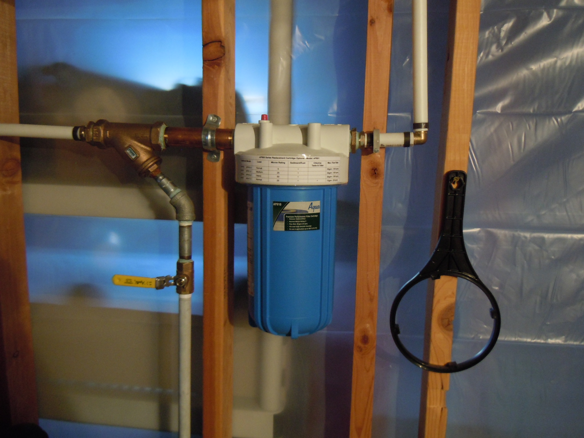

I had sediment problems for years until I installed a Y strainer and filter for the whole house. It didn't cost very much but sure has made a difference in valves lasting longer without any problems.
Every month or so I open the valve under the Y strainer and blow out any sediment. The filter lasts about 1-2 years.
I also added one of those that I installed to filter water as it came into our summer house. Turns out, in my case, that the sediment problems I was having were related more to deteriorating galvanized pipe inside. Bummer. Now in the process of bypassing all the old plumbing with PEX.
