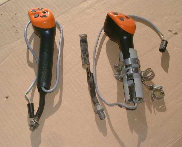

Well, I figured this would be the best place for my first post. Thanks to this thread I was able to find that my TC40D also was on the verge of failing at just over 400 hours. I went to the dealer armed with all the useful information I had found in reading the entire thread (yes I read the whole thing) and found that they actually had three of these parts in stock. Unfortunately 2 out of the 3 were of the old "weak" style. Anyway thanks to everyone on this site for all the great information and for saving me the experience of the "No Joy Joystick".

So... Does your dealer now have only two of the shafts that are the old (bad) type? Did you get the "new and improved" version? I sure hope so. It makes a B-I-G difference. /forums/images/graemlins/cool.gif

No need, RaT. That new joystick has cured all the problems of the old one. Once I replaced the whole assembly with the new design (see attachment), it works like a champ. ...and I don't have any plans to replace the tractor that I still love. 1050 hours and counting.

Then it happened swift and sure, the deed that killed the day,
Jim looked down to see in his hand a joystick broken away,
"No, no!" came his cry, "Not possible; how could this be?"
"My brand new tractor is broken. This just can't happen to me."
So reality swiftly displaced disbelief; and attitude took a flip,
Doubt changed to a scowl, and a sneer curled out his lip,
One look at the mangled steel with it's broken jagged tail,
Jim said,"There's no joy in this joystick. It was designed to fail."
With busted joystick in hand, off to the dealer he flew,
"I'll get this replaced under warranty and be as good as new."
And the dealer shook his hand and smiled with all the normal cheer,
"It must have been a bad part. We have another here."
Jim raced back home, a joyful man, with all his confidence in place,
He could not wait to fix his mighty friend and get back into the "race,"
And he swore he saw the TC smile as he approached the shop with glee,
The joy returned; the day was saved; all things were as meant to be.
But mighty Murphy will not be scoffed; he knows he'll always win,
And so it was that few hours passed and tragedy struck again,
For the second joystick, though new, was no better than the first,
It failed again, same way, same place, and with it failed Jim's trust.
So with a firm conviction that the designer was a jerk,
Jim set out with teeth-clenched determination to make this failure work,
And he gathered up his trusty tools, searching far and wide,
Hose clamps, duct tape, and glue, the jury rigger's pride.
And when he finished he stood back in satisfaction,
Two brief words, "It'll work" summed up the contraption,
With a grip on the joystick his joyful attitude soared,
It stood firm and strong unlike what it had been before.

There was no more fixing, the damage was done,
Only one thing to do. Bite the bullet; order a new one.
So off to the smiling dealer Jim repeated the trip,
And returned home with a complete joystick in his grip.
But what joy arose as he unwrapped his prize,
This joystick had been modified by an engineer wise,
With a stronger backbone it could take all the abuse,
He raced through the installation, quickly putting it to use.
