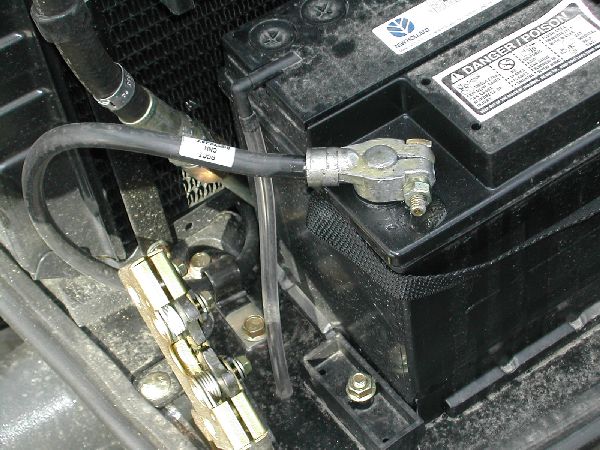

I have an '03 TC35, and the battery spits like a mad tomcat. I covered it with a piece of plastic until I can find a maintenance free battery that and has the right hold-down lugs and post configuration.
   / No Joy Joystick #137
haveblue; Maybe you'd want to get a setup like on the newer DA models. The battery has a different lid on it with a drain similar to what motorcycles use. I did have to extend the drain down below the frame so any spillage would drip below the frame /forums/images/graemlins/grin.gif
