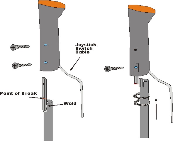

Sorry about your joystick, Gary. Believe me, to quote a former President, "I feel your pain." Here is an illustration attached which shows how I <font color=blue>temporarily fixed</font color=blue> my joystick. Actually, it's been <font color=blue>fixed</font color=blue> /w3tcompact/icons/crazy.gif this way for 200 hours and I've experienced no more problems. It ain't pretty, but it works. If New Holland would just re-engineer that piece of bar stock with the screw holes in it, the problem would go away. It's not rocket science, but evidently, it's not New Holland science either./w3tcompact/icons/mad.gif I hope you get your's fixed soon.

AAARRRGGGHHHH! I have 280 hours on my TC45D and am on No-Joy-Joystick number 3!
Refering to your diagram, the last one that I broke I had a friend of mine weld up. He thickened and strengthened it with extra weld material up past the bottom bolt hole where they always break. I also have a backup new one in case the welded one fails.
This is what is refered to as VEing (Value Engineering)
JT

"Value engineering" is exactly what I thought when I first saw my broken joystick. Now I think it's "no brain engineering" since if they had just used a longer rod and eliminated the welded piece of flat metal, this problem could have been avoided. It would simplify the manufacturing process since they would eliminate one part (the flat bar) and one manufacturing operation (welding). There would still be room for the turtle-rabbit switch wire and the whole assembly would be much stronger. As a matter of fact, the non-DEElux models have the round rod threaded at the top with a round ball on it. Maybe they couldn't figure out how to drill two screw holes in a round rod./w3tcompact/icons/laugh.gif

Have any of you guys been able to closely examine the failures ? I was wondering if it looks like a metallurgy ( spelled wrong ?? ) issue like poor steel manufacturing, or a mechanical issue like not enough beef. The lack of beef should be easy to address. The steel .... not so easy. With the level of technical ability shown here, someone must have access to the right equipment to tell.
My TC35D has not shown any problems. I have disassembled it and looked it over to see if there was any sign of stress. Couldn't see anything.
