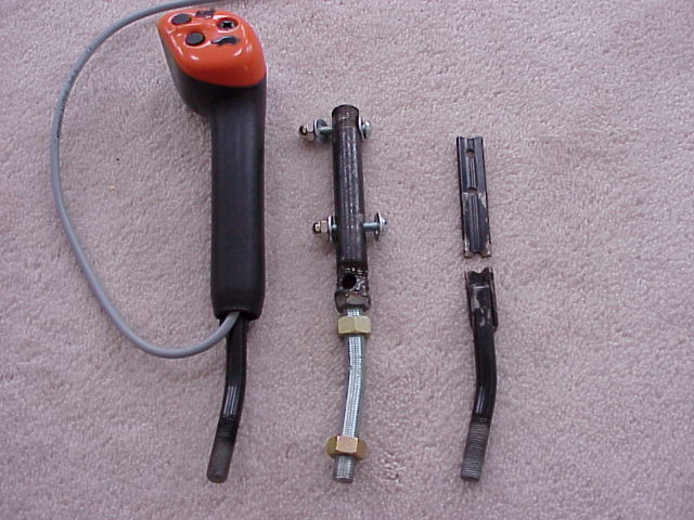

Hi all,
Add my 35D to the list. Broke at 350 hours, during the big snow storm of this weekend in WV. Rigged it for a while with hose clamp, but that only lasted a day. Ended up using the remaining piece of rod to work the loader yesterday. Contacted the dealer today, and they are ordering the replacement assembly, shipping to my place and I will make the swap. Warranty ends this June.
   / No Joy Joystick #36
Hi all,
I just went through the replacement process, and figured why replace it with something that will only break at the worst possible time. I figured I could do a better job at a replacement, So-- I went to the local hardware store and matched up some all thread 7/16" x20 thread, and small 4" long pipe and made my new one. I took the piece of pipe and welded the nut which matched the all-thread that I used. I then drilled three holes in the pipe. I matched the holes from the joystick handle and drilled the pipe. I also drilled a hole in the pipe near the bottom, to pass the control cable through the pipe. (I needed to cut the control cable at the bottom to make it small enough to pass through the pipe. I then soldered it back together once it was fed through the pipe.) I then drilled the joysick holes all the way through the other side. After bending the all-thread to match the original part, it turned out great. The joystick is now attached to a complete piece of pipe, with two 1/4" nuts/bolts. Although I made two of them, since I had the material, I doubt that it will EVER break!!

   / No Joy Joystick #38
Hi JINMAN and all,
I took some photos of the design that I came up with for the Joystick on my TC35D. First let me say that I'm sure that there is room for improvement. Let me also say that I am NOT a welder, but I can usually make metal stick. I will need to make three seperate posts since I was not able to place all three pictures with text on one Word 97 document.
So, The first post will show the original piece that broke, my replacement design and also the complete replacement supplied by NH.

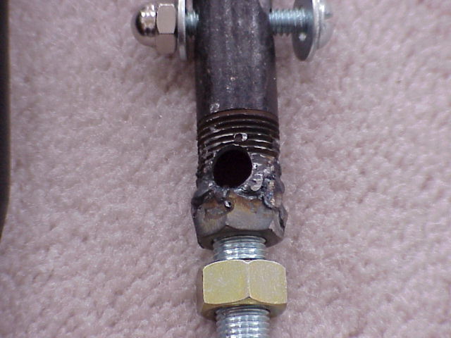

The second photo will show a close up of my terrible welding, but more importantly the hole drilled that is necessary to route the control cable through to the top of the joystick.

   / No Joy Joystick #39
Here is a photo of the hole necesssary to route the control cable.

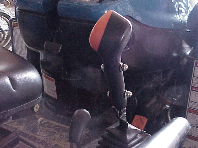

   / No Joy Joystick #40
Here's a picture of the finished product.
