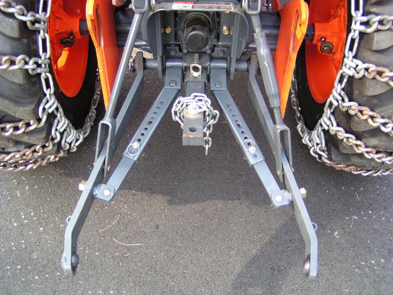

I have always wanted to get rid of those miserable 3ph arm adjusting turnbuckles after seeing this setup on Tim 8561's tractor. Ronnie Bowman at Tractorsmart knew exactly what I needed and I had the parts in just a few days. Here is a picture of the new installation on my B7500:

Nice, Joe! I'd like to order a set for the B7610. Do they have a part number? Do you have a link to a page that lists them? If you don't mind my askin', how much did they cost?

Hi Bob-
Sorry, I don't have a link or part numbers. I just called Ronnie at Tractorsmart and told him I needed all the parts for the telescoping adjusters like comes on a B2710 or B2910. The cost was $125.40 plus $8.60 UPS to NH. I don't know if they are a direct replacement for a B7610 but Ronnie will probably know.
Sure is nice not having to deal with those pesky turnbuckles. The telescoping adjusters stay spread while backing up to an implement.

Here you go. Here is a list of parts for the B7610. The B2910 is a direct replacement. Many thanks go to Dan for providing the pdf file.

I can confirm they also work well on the BX 2200, MUCH better then the turn buckles. Requires a little modification, grinding the ends if I recall, but an easy conversion. The cost has sure gone up, I think it was less then $75 a few years ago.:mad:

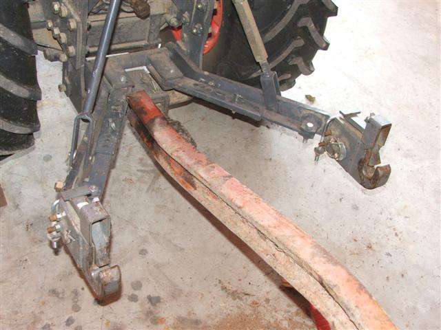

/ No more turnbuckles! #15
The only thing left for you to change is the pins that Kubota supplies with those arms. I have the type that have the bail wire attached and all you do is to insert the pin and pull the bail wire over the end. I like them better, since the are faster than dealing with cotter pins. I made the change over a few years ago and it has worked flawlessly on my BX22. Only wish that it didn't have to be removed to install the backhoe. :(
