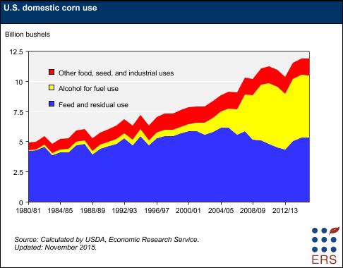

Greenpower, not correct! Ethanol is about 40% of corn production. Per USDA;
There also is a large amount of corn that gets exported, which the chart appears to not include. Still though with the 40% number you give, there is corn that is left to rot, and would be even more of it without ethanol production, unless farmers find a substitute crop with a purpose (market)
And while that is true, what gets overlooked in many of those little charts is that, of the the corn used for ethanol production, out the back end of the ethanol plant comes corn oil, livestock protein feed supplements (which are highly desired for poultry and livestock feed producers), polymers for plastics, etc. Corn that goes into ethanol production is not lost to anything else. In fact, if it were not for the ethanol production plants, it would be harder and more costly to get the separate products mentioned. Ethanol production is more than just ethanol. Anyone who lives near something like the Blair, NE biofuels plant need to see what is going on there. A major refinery complex that produces a lot of products from corn that requires a constant flow of truck and rail cars. I haul many truckloads of livestock feed supplements from it to feed mills and poultry operations.
