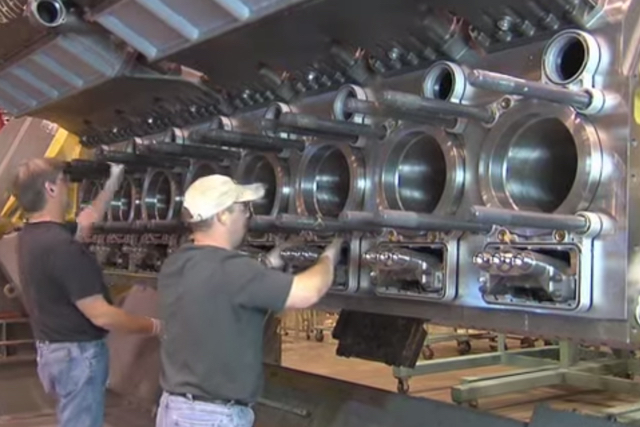

Look at a mining dump truck, locomotive, or ship. To put it simple for dumb dumbs, bigger job, bigger engines, more cylinders. Hate to be so direct, but some people will argue anything. HS
Yes some people will (especially when they think they are right even if they are wrong)...
