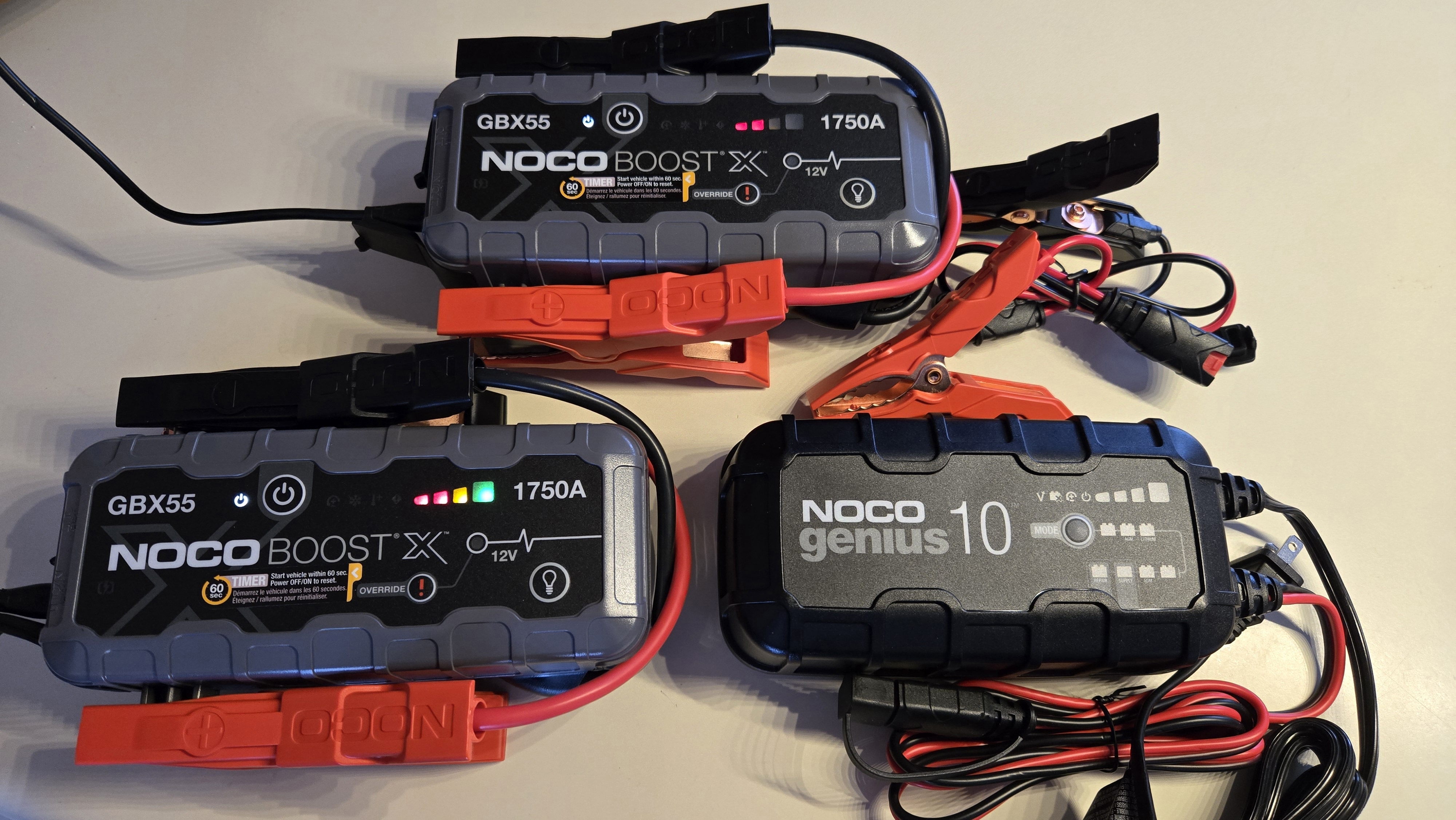

A reminder for those buying a NOCO GENIUS 1: This model is not water resistant. It is rated IP 60 (protected from dust intrusion, but the 0 means no water protection). It should be considered for indoor use only. Even if protected from rain/splashes, condensation can become an issue.
The rest of their Genius series of charger/maintainers are rated IP 65 (protected from water projected from a nozzle from any direction).
Their GEN series is rated at IP 68 (protected from immersion up to 1 meter deep). They are designed for onboard mounting on a vehicle.
I have a several pieces of equipment with small batteries that recommend charging at 1.5 Amps or less (UTV, motorcycle, forwarding trailer). It's hard finding a reputable, low amperage charger that is at least somewhat waterproof for these batteries (and especially one that has selectable charging profiles for both flooded lead acid and AGM batteries), so I have not mounted a charger on-board any of them yet.

When using the Noco Genius 2 as a charger/battery minder, do you always unplug the Noco every time you connect to a battery?
I have one on the tractor which is more convenient to leave plugged in to AC because of the electric outlet location.
Can I leave the Noco plugged in...disconnect it from my tractor battery, use the tractor...and then just reconnect the Noco to the battery without ever unplugging AC to the Noco?
Anyone aware if it will damage the Noco doing this?
   / Noco Chargers best sale yet
#20
its fine the unit will just go in standby mode till you reconnect
