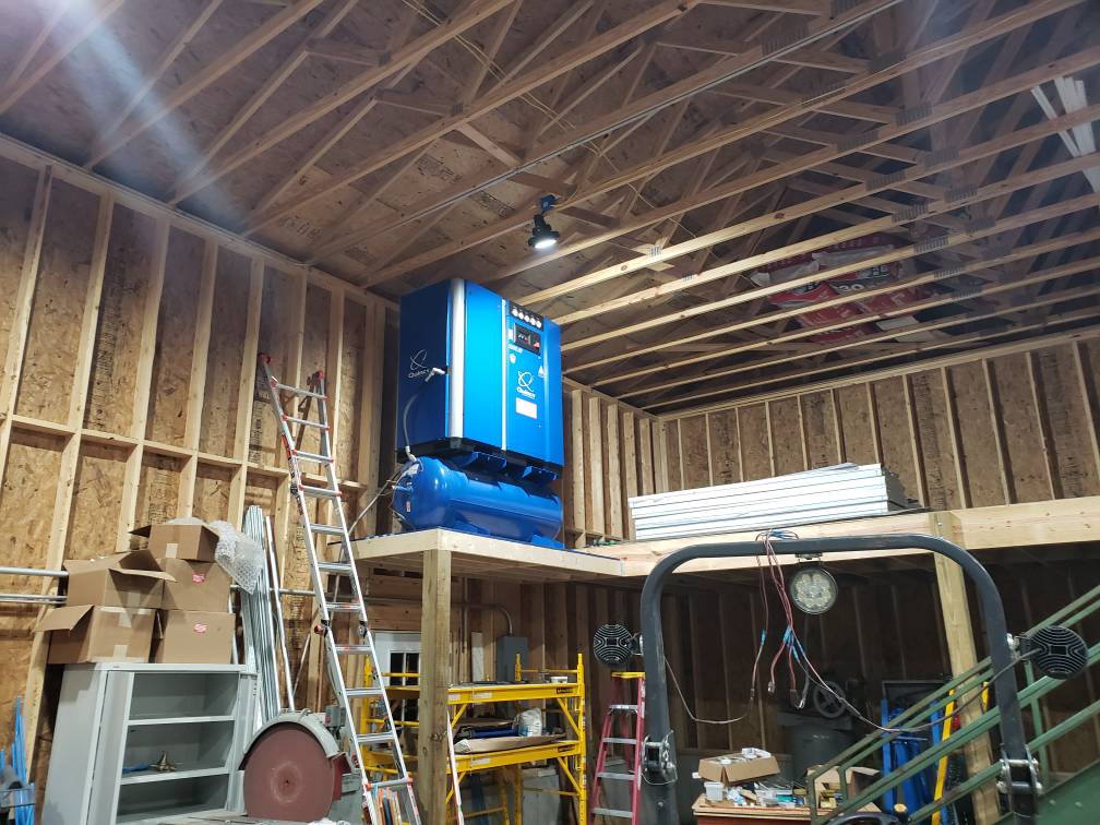

I put my compressor outside at my old house, my buddy has his compressors outside at his body shop. Only time he had an issue was when the auto drain clogged up and filled the tank with about 50gal of water!
Doesn't seem to have a problem in the winter, but it does get a lot of use so the heat probably helps.
Or just do what I did and get a screw compressor, nice and quiet! you can stand under it and have a conversation. 1551788628.jpeg
