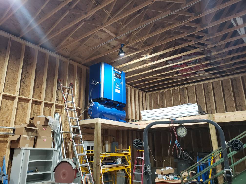

Or just do what I did and get a screw compressor, nice and quiet! you can stand under it and have a conversation. 1551788628.jpeg
