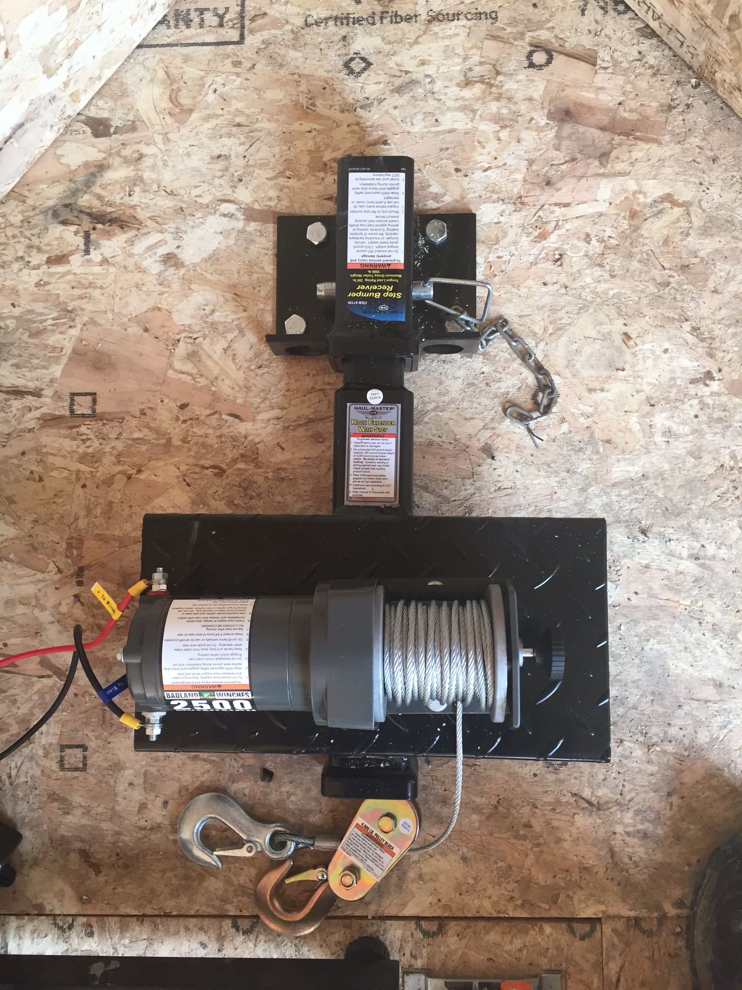

A light winch could be mounted on a trailer coupler. Mount a ball wherever it might get used.
Bruce
   / Non permanent winch fastening?
#13

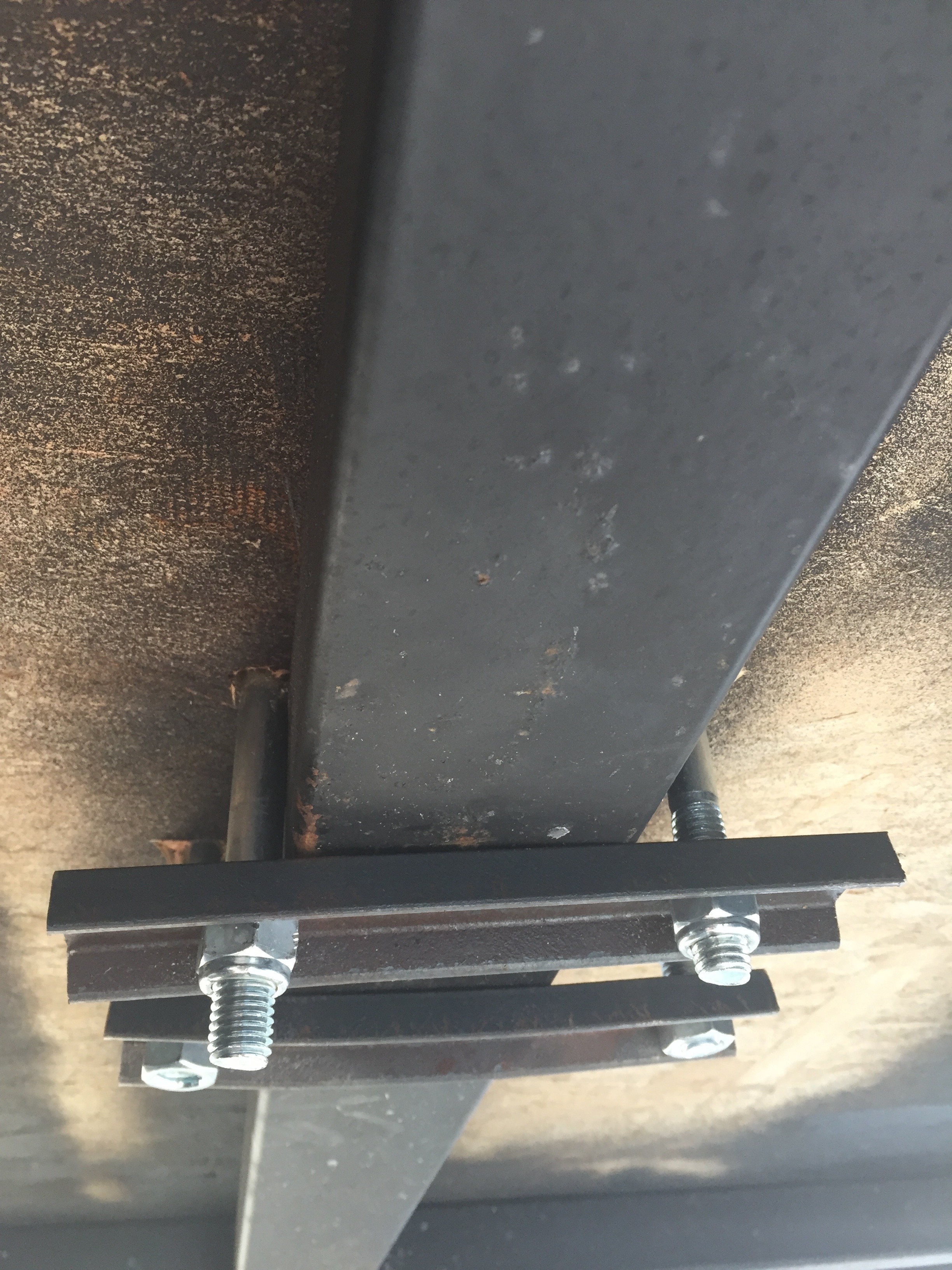

I pretty much went with the 2 parts I pictured earlier. No proper size U bolts were available at the local hardware store, so I went with some 1/2" threaded rod. Will use some channel iron that I have laying around as the bottom leg of the U, under the frame member. Will try to get some pics in the future. Just getting ready to go out and tackle it now.

Not looking like factory or a pro fabricator from the bottom, but plenty sturdy nonetheless. Looks good enough from the top side.
Easily removable if needed in the truck hitch receiver.
