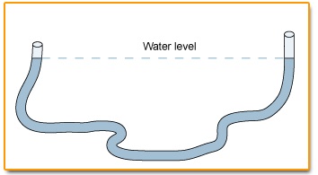

Garden hose and some fittings to attach some clear tubing to the ends.

If you want cheap and have time to diddle with it, how about a water level? All you need to make one is a garden hose, 4-5 feet of clear tubing, a few hose fittings and you're done - I did one several years ago, I can save you one PITA by suggesting CAPS for both pieces of clear tubing - just remember to loosen both caps once the hose is in place, or it will LIE to you... Steve

I have a lot of dirt to move and was hoping for something that I could use for grade work. Wouldn't the hose be hard to grade with?
