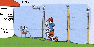

Level is easy and cheap to get with a water hose in construction. Plumb is a little more difficult to obtain, years ago I used a transit for this but while good enough for me I am curious what you use? A lot of accuracy can be lost in the transfer and measurements from pencil to the finished product.
My Topcon laser is a slope laser that I would not find necessary for construction/building work, I would use a less costly unit for that. My grade work is checked by the feds and in real life by the water flowing across a field, the higher the accuracy I can obtain is important. Now meeting the fed spec's is easy enough but watching the water flow across the field is the true test, it quickly becomes evident whether you are close or no cigar. I need more improvement for sure but I am working on it.
/ non pro building sight level???? #53
A minor variation on the garden hose tubing I've used for the last 50 or so years is aquarium air line tubing, a gallon jug of water and food dye .
You can get 500 feet of tubing at Amazon for $40 and 10 "Y"'s for $5.
To me the advantage of airline tubing over garden hose is that the air line tubing is real easy to roll up and carry, tape to a stick, and with the food dye easy to see the level. I've only personally used it for 60 or so foot runs but it works on gravity.
The main disadvantage is that it does not work below freezing. You have to add alcohol :) to the water.
Thanks for that tip - I have an upcoming drainage project and I think this would be much easier to use than the transit, especially with multiple tees. That way, I can have multiple gages reading at different locations at the same time. I'm going to get some 3/16" clear rigid tubing and a bundle of yardsticks to flesh out the gage set.
I was going to use garden hose, but as I added up the pieces it was starting to get expensive. The air tubing & fittings really brings the cost down to a level that's easy for me to justify.

Don't forget the dish soap!
A drop or two in the water breaks the surface tension and helps " level" the meniscus.
Also, Don't actually use the water level "actively". That is, lowering the hose adds volume, and both ends have the water level go down. Just string the water level to posts, and then measure from the observed water line. Chasing the tail is a fools mission. ;-)
