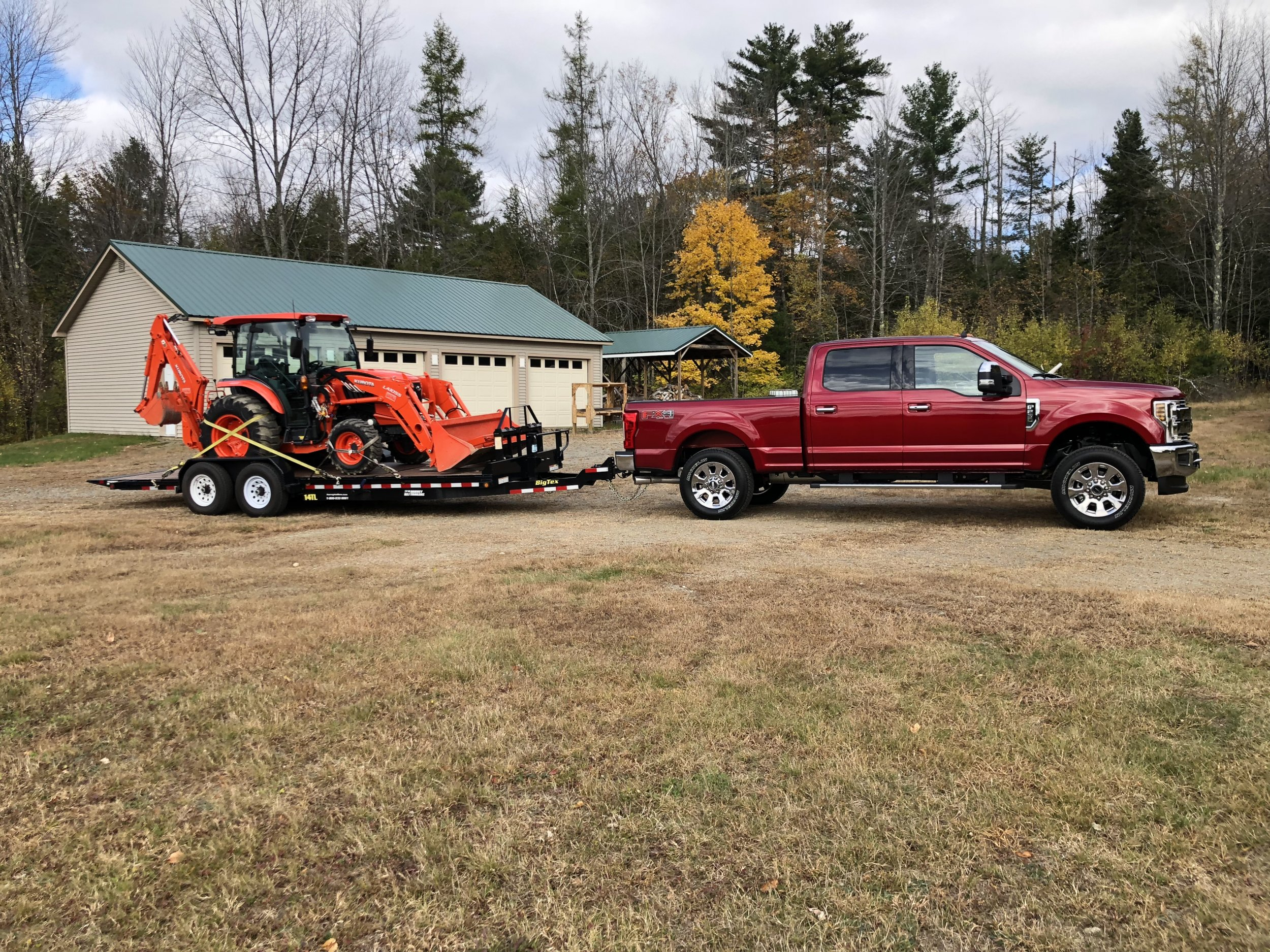

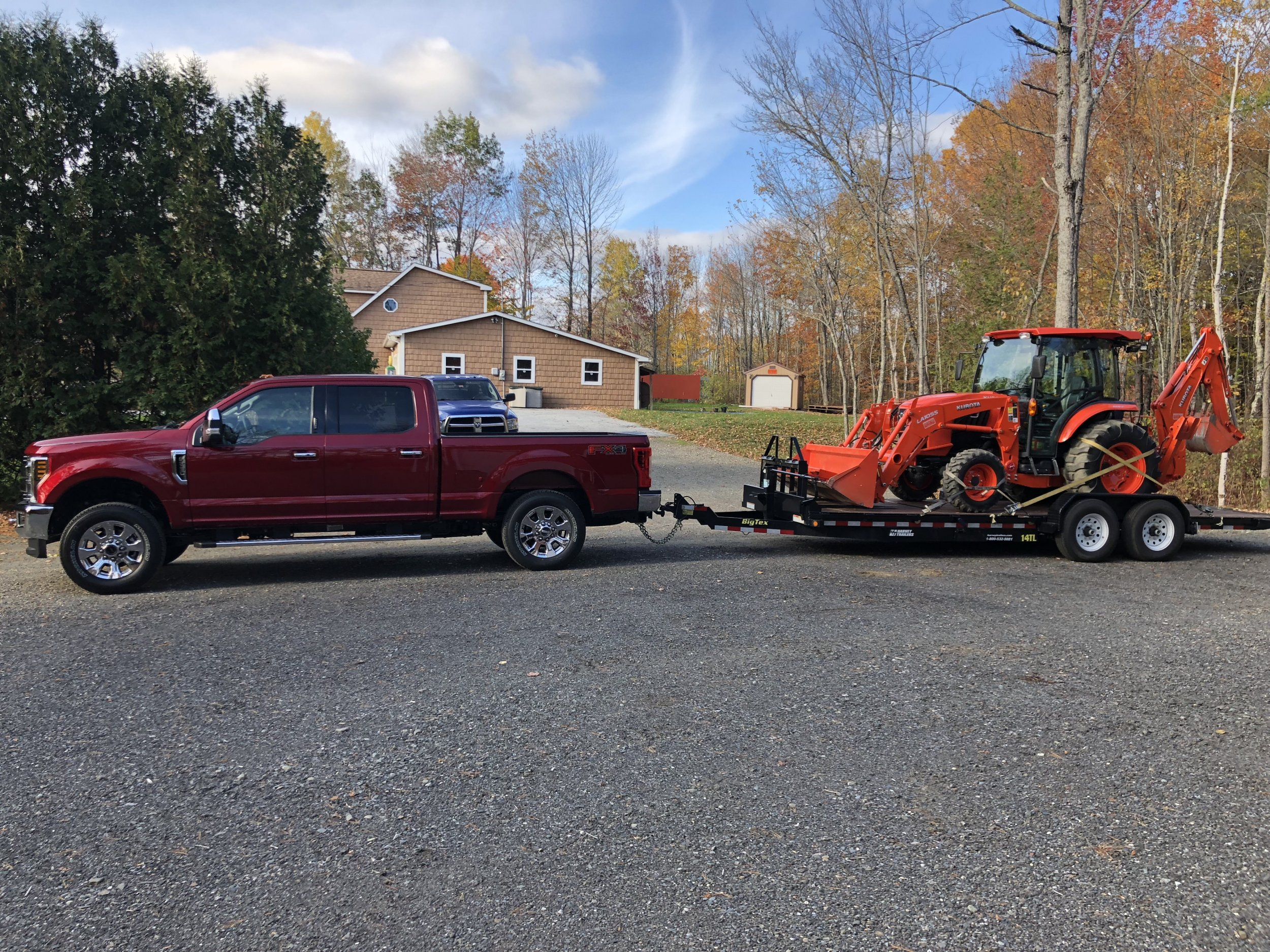

The kioti finally arrived!
This is my first time using chains, and securing something besides a car (wheel straps) regardless. I've searched and watched the YouTube's to no avail
Are my rear chains OK here on the axle? Until a big pin shows up in the mail I can't attach to the draw bar.
My concern is that any emergency lateral load will be basically entirely on the wheel -
  • Could unseat the bead, and all chain tension lost
  • Full side-to-side load carried / torqued on the hubs, since its pulling sideways from the outer tire diameter
Also, ion the front, I would prefer to just chain to the axles, but the steering linkage appears to make that impossible... Ideas?
My best advise is to go by DOT standards. While you might not be required to do so by your state for private personal hauling, you are also liable for what you do if you end up in an accident, or worse a court hearing. At that point your best case will be to have followed DOT guidelines. In a nut shell (do not rely on this for legal advise), you need 4 tie-downs to the main vehicle. Each attachment (FEL bucket/forks, implement, backhoe, etc) requires a separate tie-down. Each tie down must be rated at its lowest rated item for at least 1/4 of the weigh. Someone mention adding eyebolts (they need to have a WLL rating stamped on them, or they will be derated to the lowest possible load rating for the hardware).
If you are familiar with strapping cars down, many of those techniques can be used with tractors—rim slings can be adapted to go through many tractor rims.
One finally caution would be to know the true weigh of your tractor. Filled tires, wheel weights, fuel, oil, antifreeze, hydraulic fluid, may all increase the true weight of your tractor beyond what data sheets will indicate.

I use a strap on all 4 tires. It will actually squat the tires into the trailer as I ratchet them down. I use to use chains from and rear but I like the straps better, holds front to back plus squats it down and no chain damage.
FYI, if you set the backhoe on the deck after tying down, there will be less bounce of the tractor while towing.
