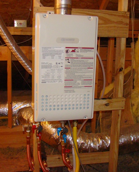

I have been away for a while. Sure happy to see I stirred some conversation. Have had the heater installed for several weeks now and no problems at all. Still waiting to see how much my propane usage drops.
Our house had 2 water heaters. Both were the same age so I'm sure the second one is on borrowed time. Today I started installing prefabing the gas and electrial. This way it won't be down more than a day once I get to rip the old 1 out.
Here is a picture of the first one install. In this picture I'm still making sure I have no leaks so the insulation is not completely install.

   / Noritz Tankless Water Heaters #50
kenmac said:
Did anyone have to up the propane supply pressure to the house to keep from having starvation when the water heater and the furnance is operating at the same time?
You shouldn't have to up the pressure. these things need volume. Run the correct size line & you shouldn't have a problem
The main issue with going tankless in an existing house is the cost of retrofitting either the gas or electric service to supply the high peak power/BTU demands (in addition to any plumbing changes to move it closer to an outside wall for venting). Depending on how things are set up in your existing house - this can be the dealbreaker as it could cost far more to make the changes than what could ever be gotten back with the energy savings. For new construction, however, I think this is the way to go. Glad to see that yours was an easy one to put in. In my case it was a no go due to all of the required changes.
