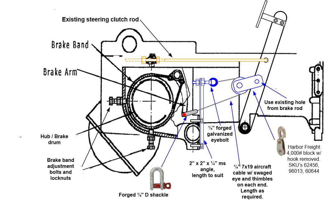

I’m willing to work on it, if it’s no trouble to you to send the drawings I’ll at lest will have something to work with and going by your knowledge I should be able to get my dozer steering solution repair thank you

Here it is as best as I can recall. You will have to do your own measuring. This configuration allows the brake band to be completely slack along with some mechanical advantage. The take-up rate with the cable and block is approximately 1-1/2 times faster than a direct linkage pull. This brings the sequence more in line with what it was intended to do.
Just so you know, I did work up drawings for hydraulic, pneumatic, and electrical systems, and also hydrostatic drive from a skid steer, but those all got lost too. At least I was thinking about it.
Good luck.
PS: The left side is the easiest, suggest you start there and just do one side at a time.

I think you sir, I’ll try this

I haven't tried Bobs modification it looks like a much better system but a much easier option that I have done that works for me is to enlarge the slots in the floor so the steering pedals have more travel this makes it easier to adjust the steering clutchs to disengage before the brake comes on and still have enough travel in the pedal to fully engage the brake

Maybe Franken should try your mod first. Nice!👍👍👍 Did you have to leave the steering clutch rod slack?

My Yuchai has also become problematic, as regards the clutch/brake adjustment, and despite attempting to adjust it per instructions, I really could derive no "feel" for what was going on, until I disconnected the linkage and manipulated the two components (clutch and brake) separately.
Then, it became apparent that the throw of the pedal is insufficient to effect the movement needed.
The answer, for me, was to install a pully and cable system which doubles the effective movement of the linkage, at the cost of additional pedal force needed:
a fair trade.

Correct, David. Hahahaha. Sounds like you adopted my pulley system. Glad to hear it.
The only way to determine how much your clutch plates are worn is to compare clutch linkage measurements from new, like measuring track pin wear (which nobody here does). Clutch disc replacement is a time consuming task without a shop manual, to be sure.
