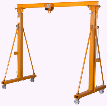

Just a simple update, started pulling things apart, been kind of a pain working on it in between nasty weather. I'll try and get some pictures this weekend. Today I hope to have it spilt just trying to figure out the best type of hoist. I was going to use a mini excavator but figure I'd like a little more control and be able to see what I'm doing. I'm not so worried about splitting as much as getting it lined up and back together.

FYI, a gantry crane works best, even outside with heavy plywood to roll around on.

Well I got it apart used the mini ex it was nice and easy with no problems, just took my time. I'll probably try to get some help lining it back up, the mini seemed to do okay. Well things didn't look horrible just rusty and covered in clay film{expected it}. I did get some pictures hopefully I'll get them on here in the next couple of days. I believe my problem was that I tore out the throw out bearing, the clutch didn't even look that bad. I did order all new parts{allmost $500.00} rather do a complete job and have piece of mind.
