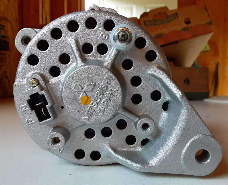

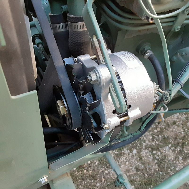

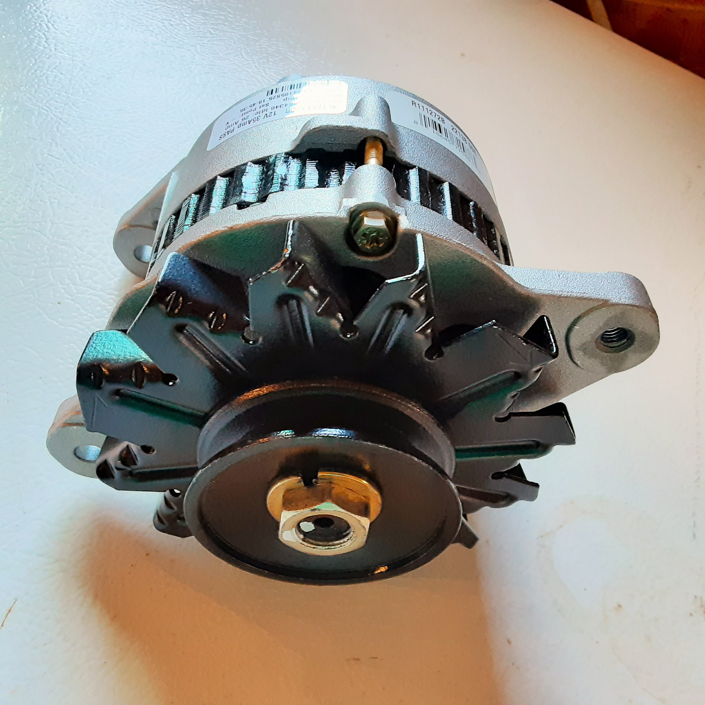

Picked up the autostore alternator for the 1973 Datsun 1200 1.2L turbo. Err ah, my Yanmar tractor. :)
That Altima actually is the Mitsubishi 35A brand. Fits and works great!

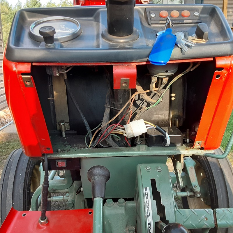

And the new VR-550 in solid state is now in there too!

Did you have to swap pulleys? I had to as there was a good bit of difference in them.
Also was this a rebuilt? Reason I ask is that it's not going to be a Mitsubishi anymore, just the china guts in a Mitsubishi case.
When I worked in auto parts our reman suits might say anything. It was our house brand but they would say Delco, Denso, Motorcraft, or aftermarket brand...just whatever case was in the pile that they used. They obviously would usually match the OE supplier for the application but that MotorCraft alternator was no way rebuilt by Ford or a Ford parts supplier!
It was pluG-n-play, nothing to swap nor move around. A perfect fit for mounting, pulley and all wire connections.
I took the old Hitachi unit in as a $15 core. Everything matched 100%.

It was plu-n-play, nothing to swap nor move around. A perfect fit for mounting, pulley and all wire connections.
I took the old Hitachi unit in a a $15 core. Everything matched 100%.
That was my experience too. There was a trivial difference in pulley diameter, not so much that it needed a different belt. NBD.
It's been in use without issues since 2004.
