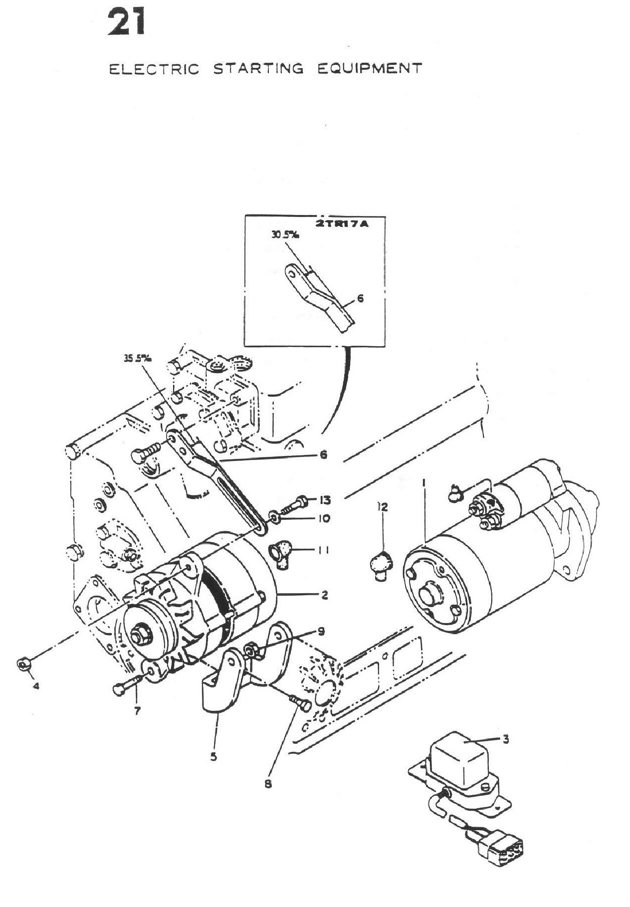

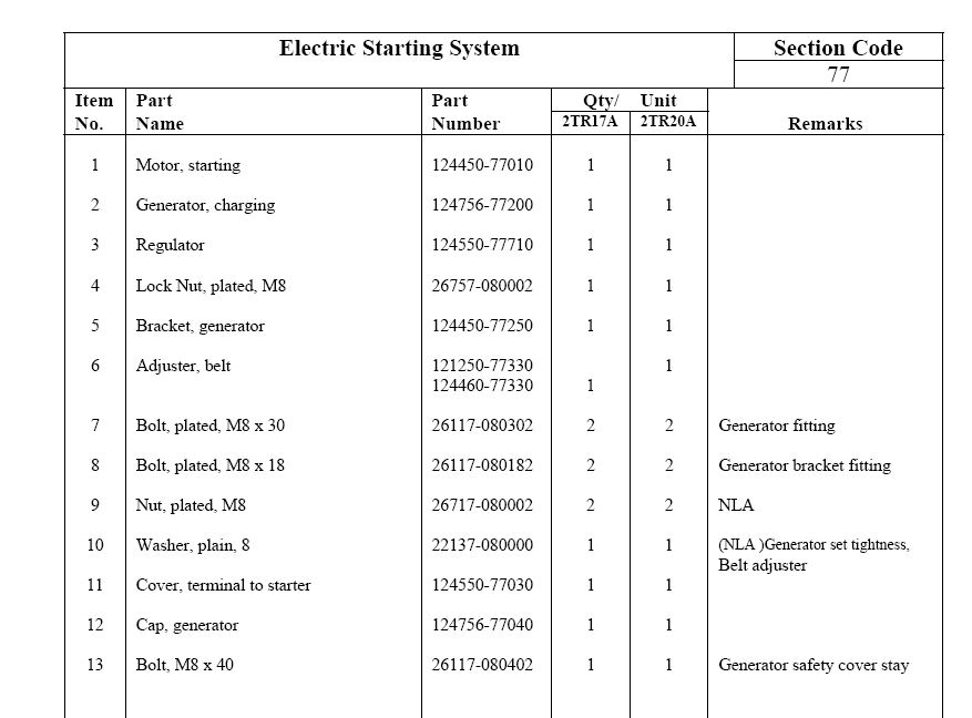

Not sure it's the same alternator. Here's the YM2610 page for the engine side of the electrical.

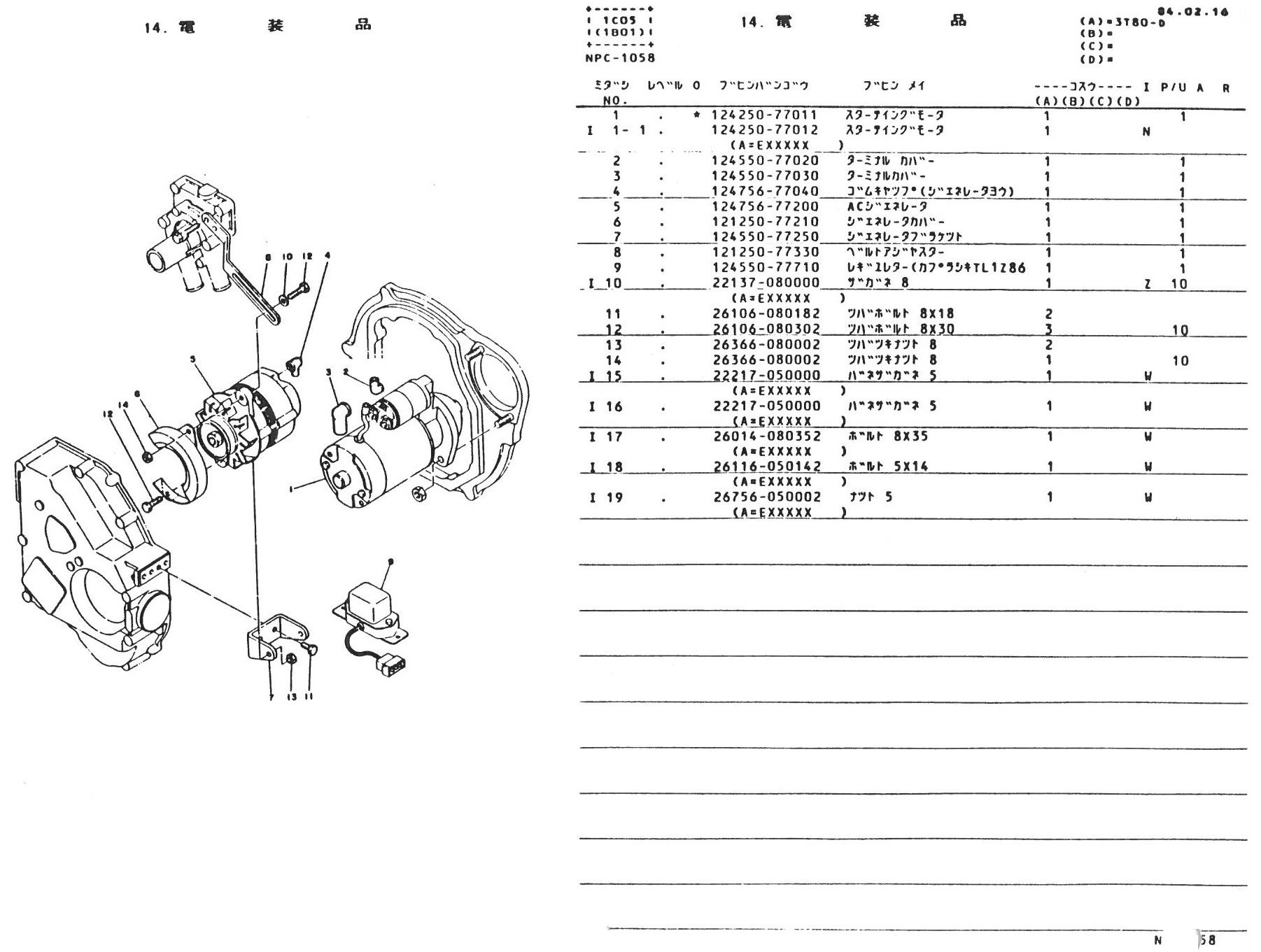

And here's the YM1700/YM2000 page also for the engine side electrical.
YM2610 124759-77200
YM2000 124756-77200

I would almost bet that the larger alternator would fit. I am sure the 35 amp version would fit. ...Probably would take some research. I would look up each of those alternators or listings for the correct application...
Thanks. That was my thinking too. The YM2610 has the 35A version. I was hoping for a 50A or 65A to replace it.
Google shows 0 zero hits for the 124759-77200. The DUCK search shows 17 hits like Startpage.
Fredricks on-line store shows:
Description: Alternator, 12v 35 amp
Applications: 195, 240, 330, 336, 1700, 2000, 2210, 2500, 2610, 3000, 3110, 3810, 4300 (also 1600,1900,2200,2700 but needs different wire ends)
Part Number: 124756-77200 (124756-77210)
So, you are RIGHT. This fits yours and mine. LOL
