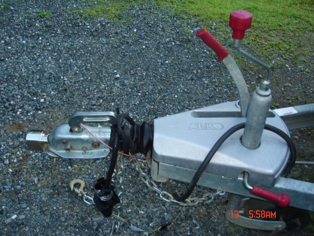

My wife got a super deal on a barely-used T@B camper. It has an AL-KO coupler with a telescoping section that applies mechanical (?) brakes to the single axle as the tow vehicle slows.
I have to admit it never occurred to me about the backing-up issue until my younger brother (medium-sized sailboat driver) mentioned it just last night. He also mentioned the lock-out pin, though this camper doesn't appear to have one, and I don't recall reading anything about it in the manual. Guess I'll start doing some more homework, but if anybody has any ideas I'd welcome them! :D

Never seen a coupler like that one but I am guessing one of the red handles is the lock out mechanism. My best guess is by pulling one of them it prevents the coupler from sliding making the brakes inoperative.
Also, what is the red cable that is sticking out from the brake actuator section of the coupler? Looks like it may be a broken off Surge Brake Safety Actuator or Brake-Away. Its hard to tell in the pic but all Surge Brake Actuators have a cable that attaches to the tow vehicle. If the trailer becomes separated it pulls the brakes on and holds them set. I have replaced many of these due to people un-coupling and removing the safety chains and driving off forgetting to remove this brake-away. Come back to the boat next weekend and it will not move due to the brakes being locked up. If you have to replace make it a length that will allow it to set the brakes before the safety chains are fully extended. If too long it will not do its job.
You could also have a lock out solenoid. It will be just aft of the master cylinder and have 2 wires going to it. One wire going to ground, the other going to the wiring harness. It closes via a signal from the reverse lights on the tow vehicle and prevents brake fluid from flowing to the brakes from the master cylinder. If it does have one of these the wiring adapter you have will not work. Its been taken from a 7 round plug to a 4 flat and the 4 flat does not support this type of wiring. You will have to have the tow vehicle re-wired to 7 round to support the trailer and get rid of the adapter. All the 4 flat supports is running lights, brake lights, and turn signals. By going to 7 flat you add the ability to run a reverse lock out solenoid and a charging circuit for the campers on board battery via the tow vehicles alternator.
