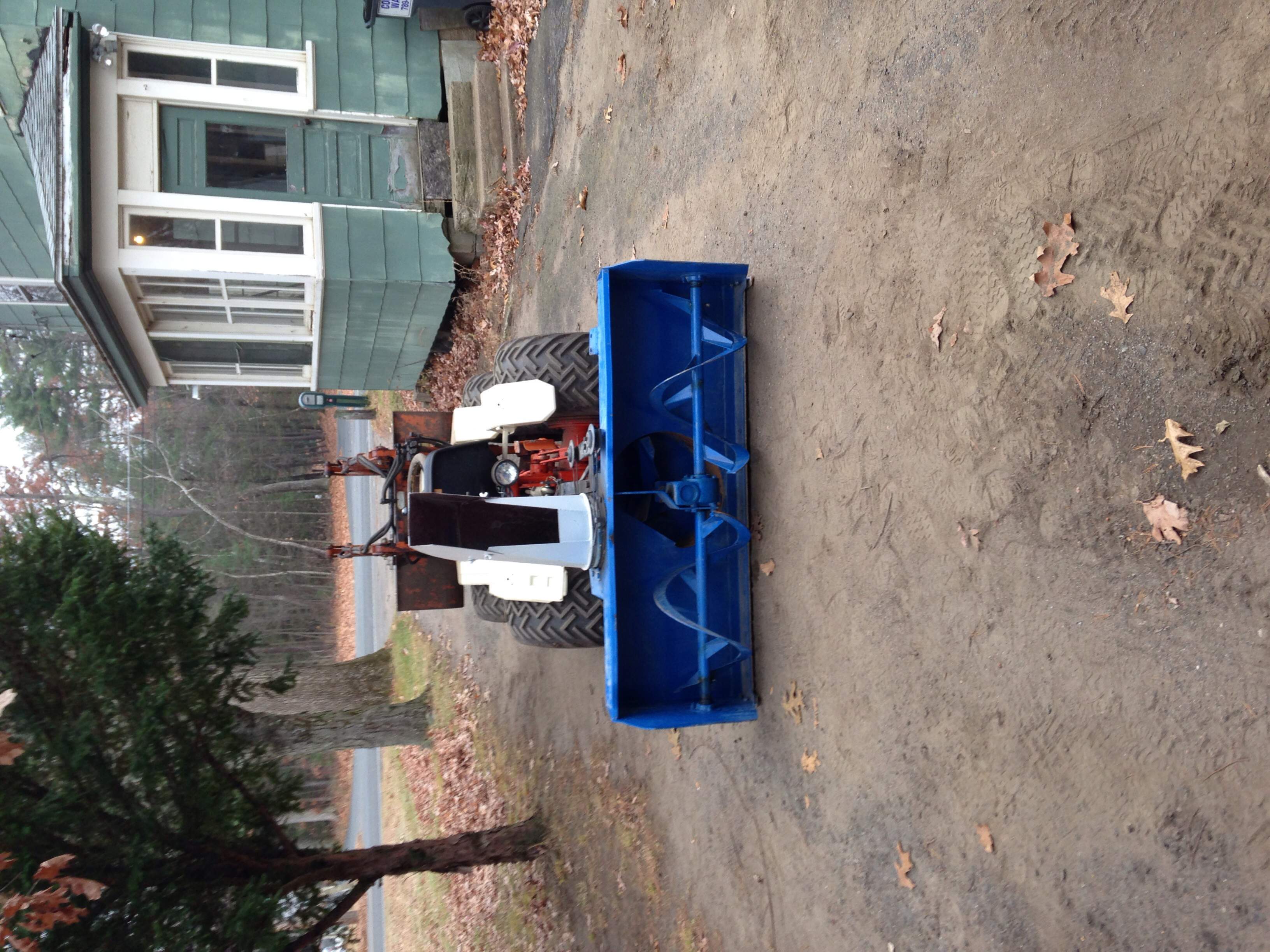

I just bought a n.h. tc18. It came with a aftermarket blower. The problem I have with it is its not blowing very far. PTO's say 540 on the tractor. Its only blowing snow 5-8 ft. Is this normal. Also should I leave the pto engaged on the blower as I pull forward. And one last dummy question.... how high should I lift my blower when its on. I have heard lifting it too high wears out the pto. Any help, advice or suggestions you can offer is greatly appreciated. This is my first real (well small real tractor) and I'm learning on the run. thank you. Any suggestions on where to get decals for my tractor. The pto' lift and 4 wheel drive don't have any decals left.

Type and depth of snow can be factors like mentioned above . The gear ratio of the gear box for the impeller , the clearance between the impeller and outer chamber , the number of blades on the impeller , can be factors . My guess is you are trying to blow to little snow at one time or it is wet heavy snow . Pointing your chute deflector up as far as it will go will help to get more distance .

Not sure if your unit is like this but I had a old Ford blower (510 model I think) and it would only blow 5 to 8 feet also. It was just the design of the unit. The fan was only 3 blades and something like 16 inches across. Not wide enough and needed 4 blades it through the snow. It is like shoveling snow with a short handled kids shovel.
Check your fan size against other units the same size at the dealers. you could fine they have more blades and have a much wider fan. My new Puma a 22 inch fan and 4 blades and will send snow 20+ feet.

Tdejong302,
What make and model blower are we talking about? If you don't know pics please.
What is the fan diameter? Fan diameter will dictate the maximin distance the unit will throw.

Thank you for the added link. My blower has a 16 inch impeller that has 4 wings on it. Its a meteor blower that is 45 inches wide. Its pto driven no belts involved. Thank you all for your help/suggestions. The tractor is a New Holland tc18.

I would say this is ONE job to ignore the 540rpm speed and run full throttle it will make a big difference and not hurt the plow .With only 15hp at pto speed the tractor may be laboring and not even up to speed .

I have a meteor blower on my m5700 , although I am happy with it , it doesn't blow snow nearly as far as other blowers I have had in the past on same size tractor . Not sure if it's the fan speed or to much clearance from blades to outer chamber or both. It works ok for my needs so I haven't needed to try and improve it .

I am assuming this snow blower you have is used ?
If it's a used blower, your throwing distance could have dropped off due to an increase gap between the impeller blades tips and housing.
