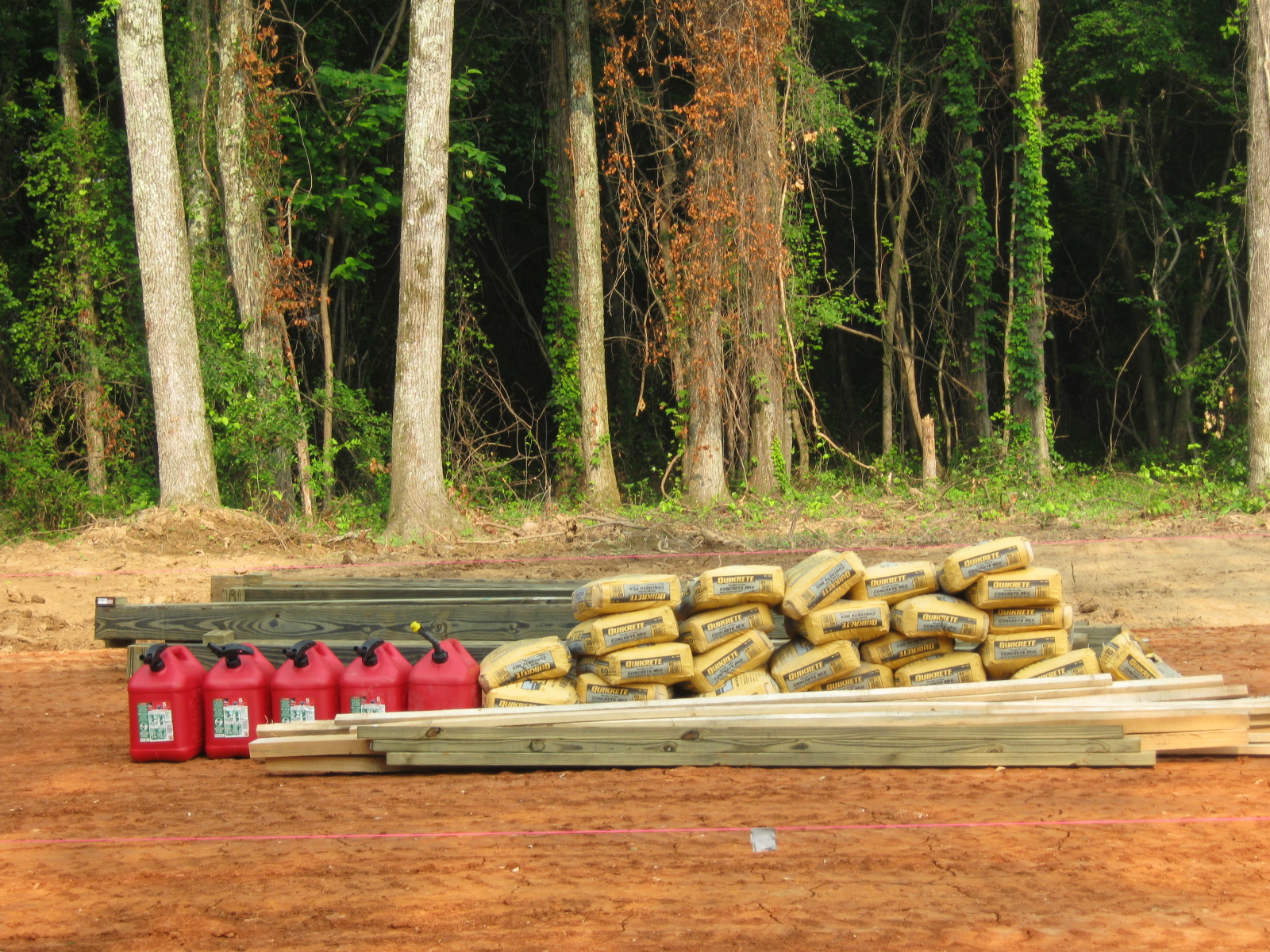

I waited until the roof is on to start this thread. Hope to have the barn finished by November. Its 26 x 32'.
Posts...

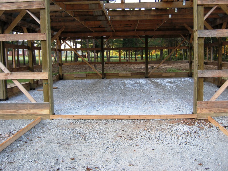

8' OC on the sides. ~10 OC on the end walls. When we first started there was no water on the property, hence the red cans -- there is now.

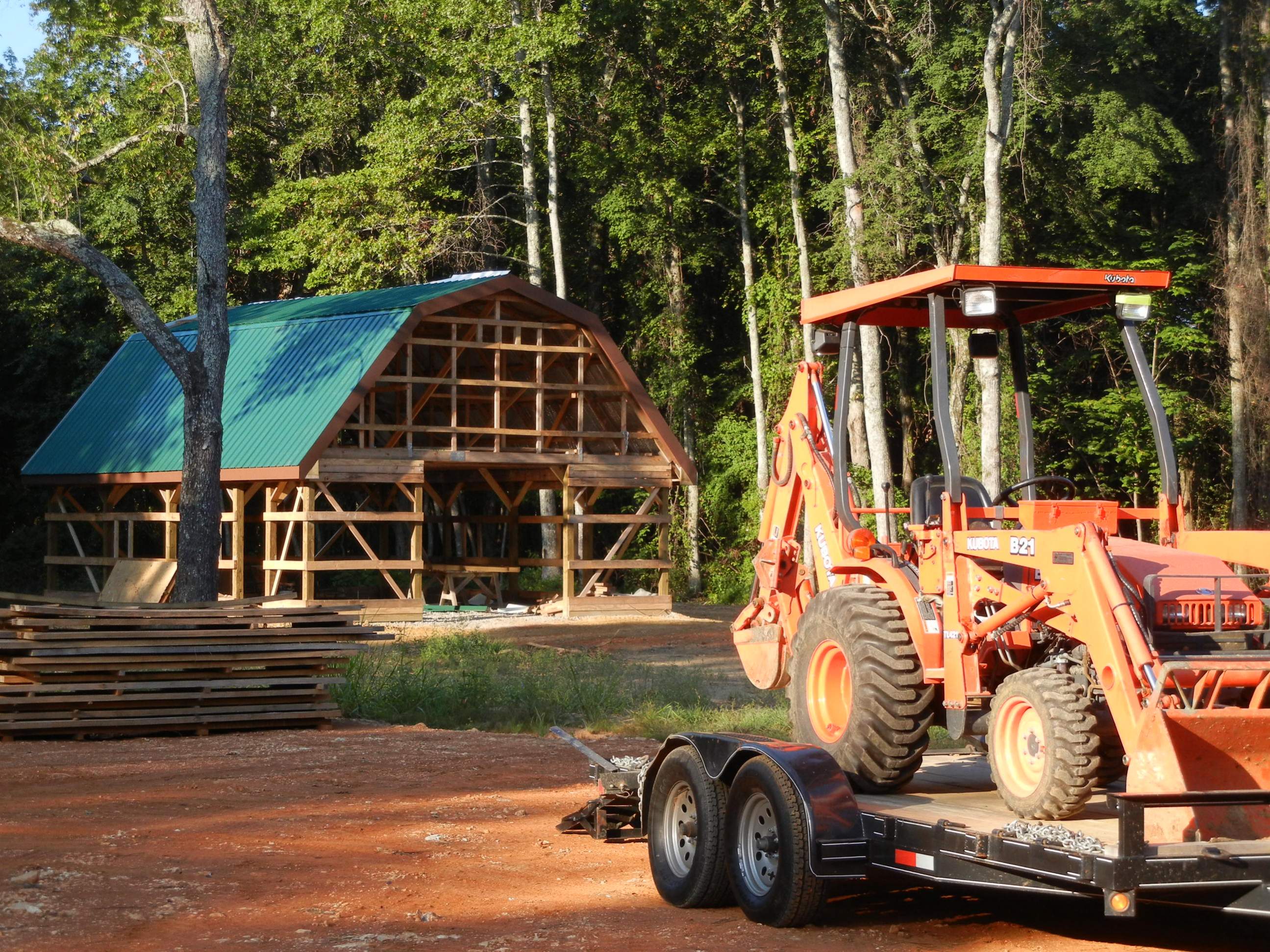

Beams....
Double 2 x 10, lag bolted to the posts. There is little snow load here, and as steep as the roof is, nothing going to stick.

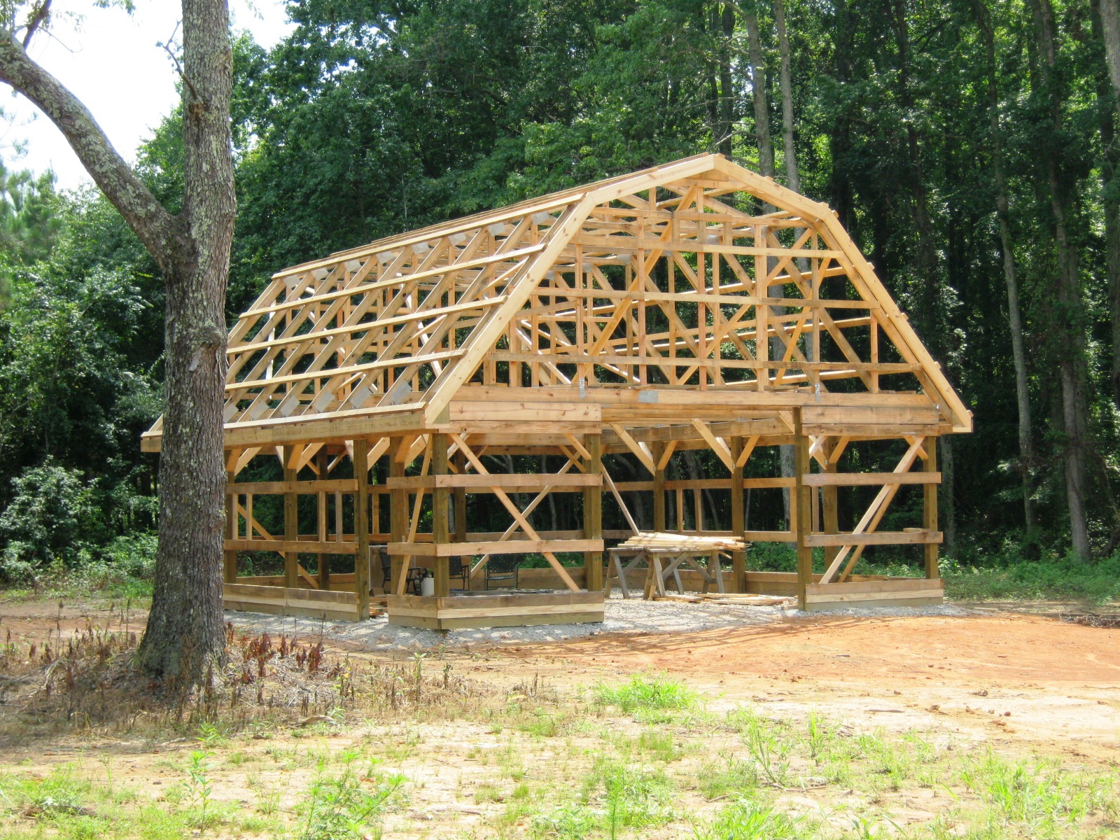

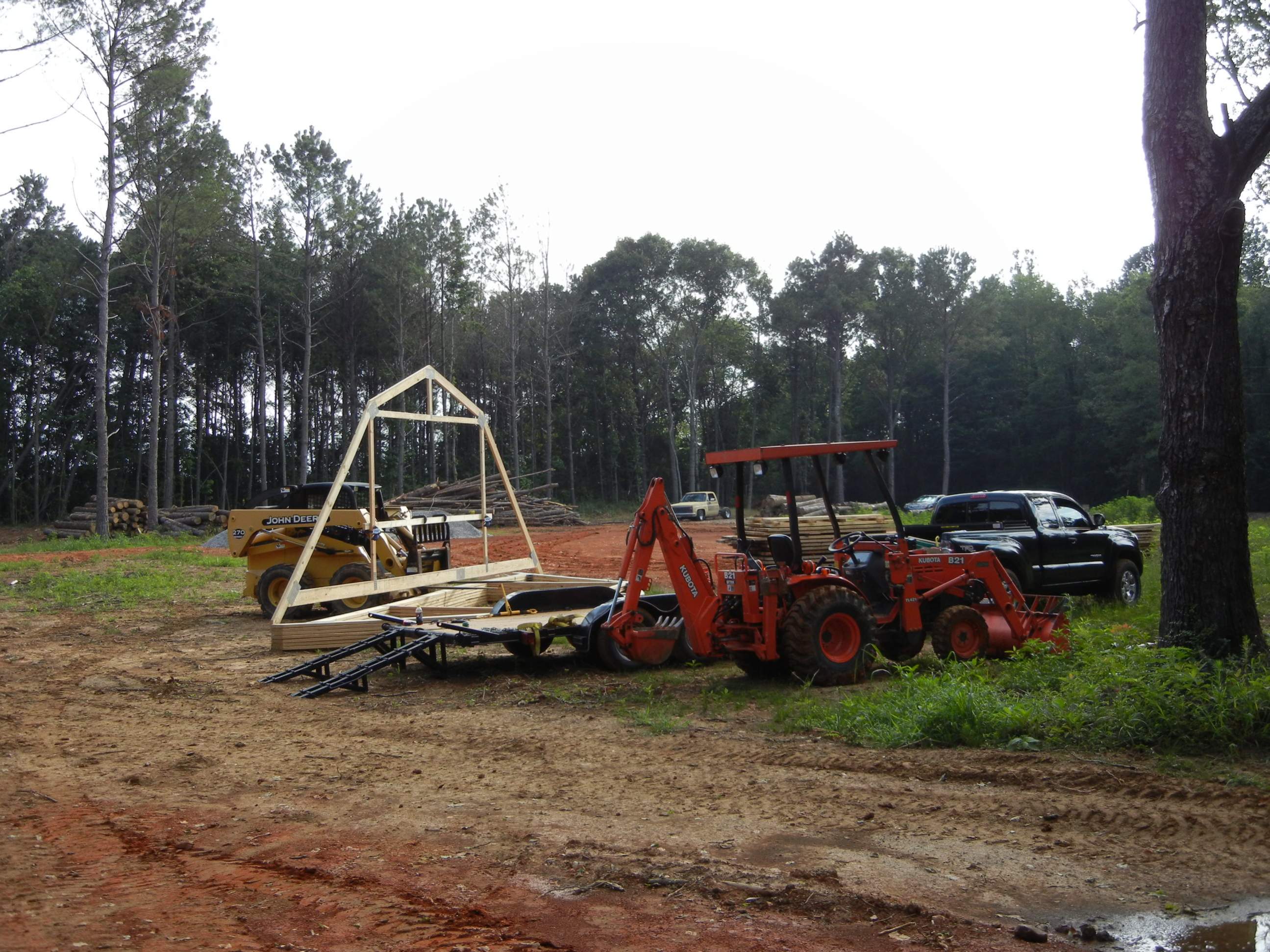

Trusses...
4' OC, rated for 30 psf "light storage load" and 90 MPH wind rating, which is in the F1 range.

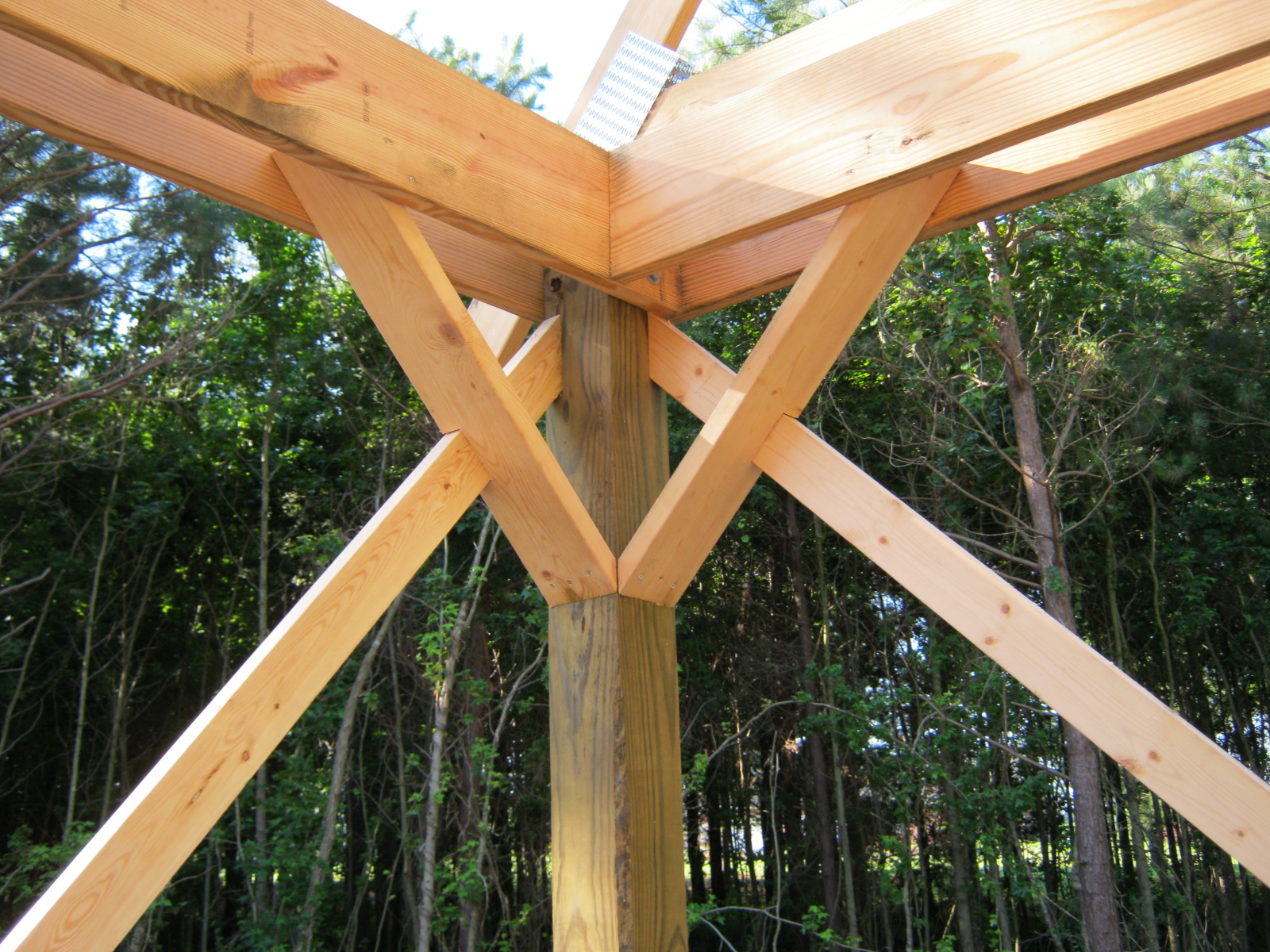

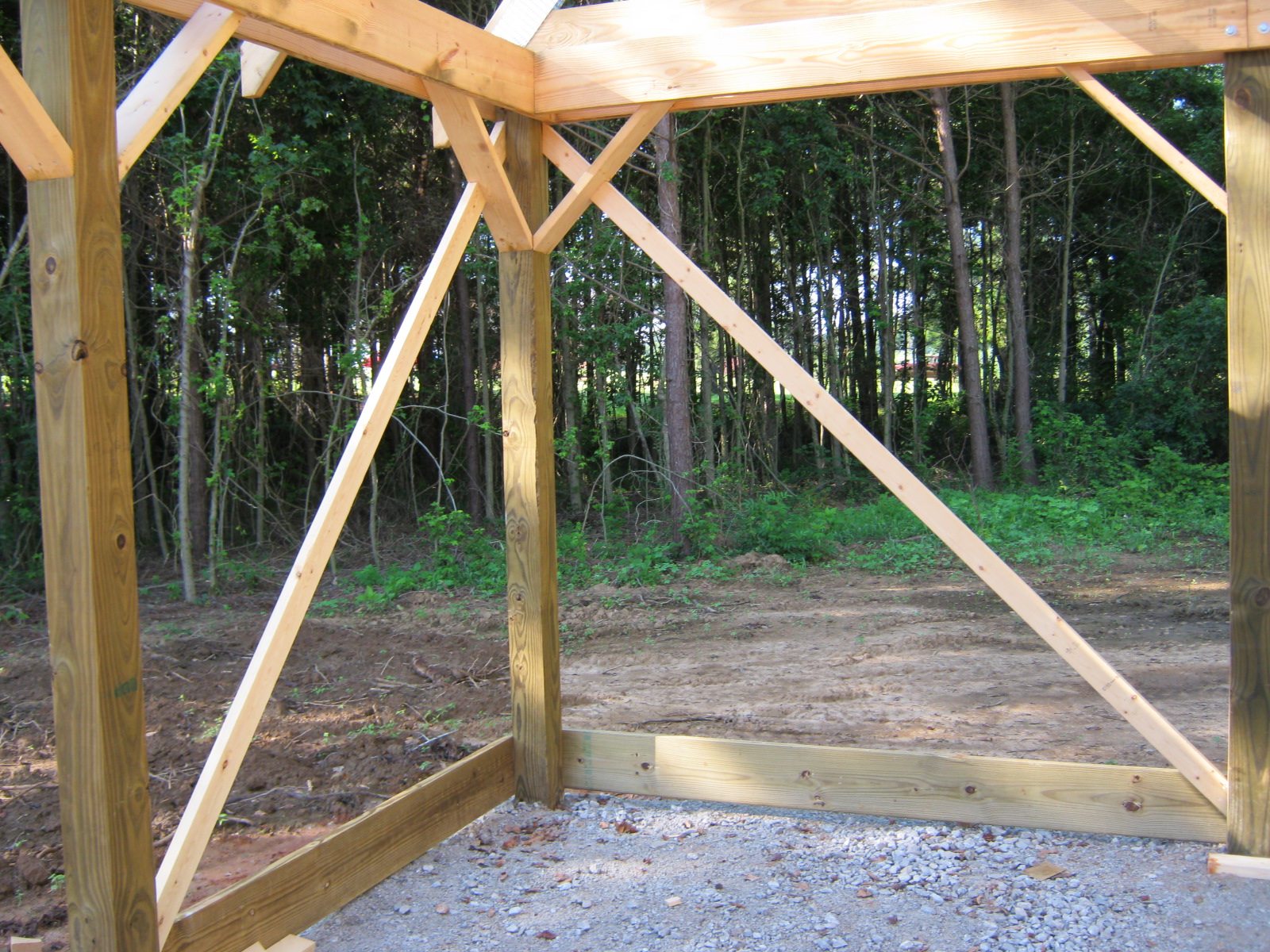

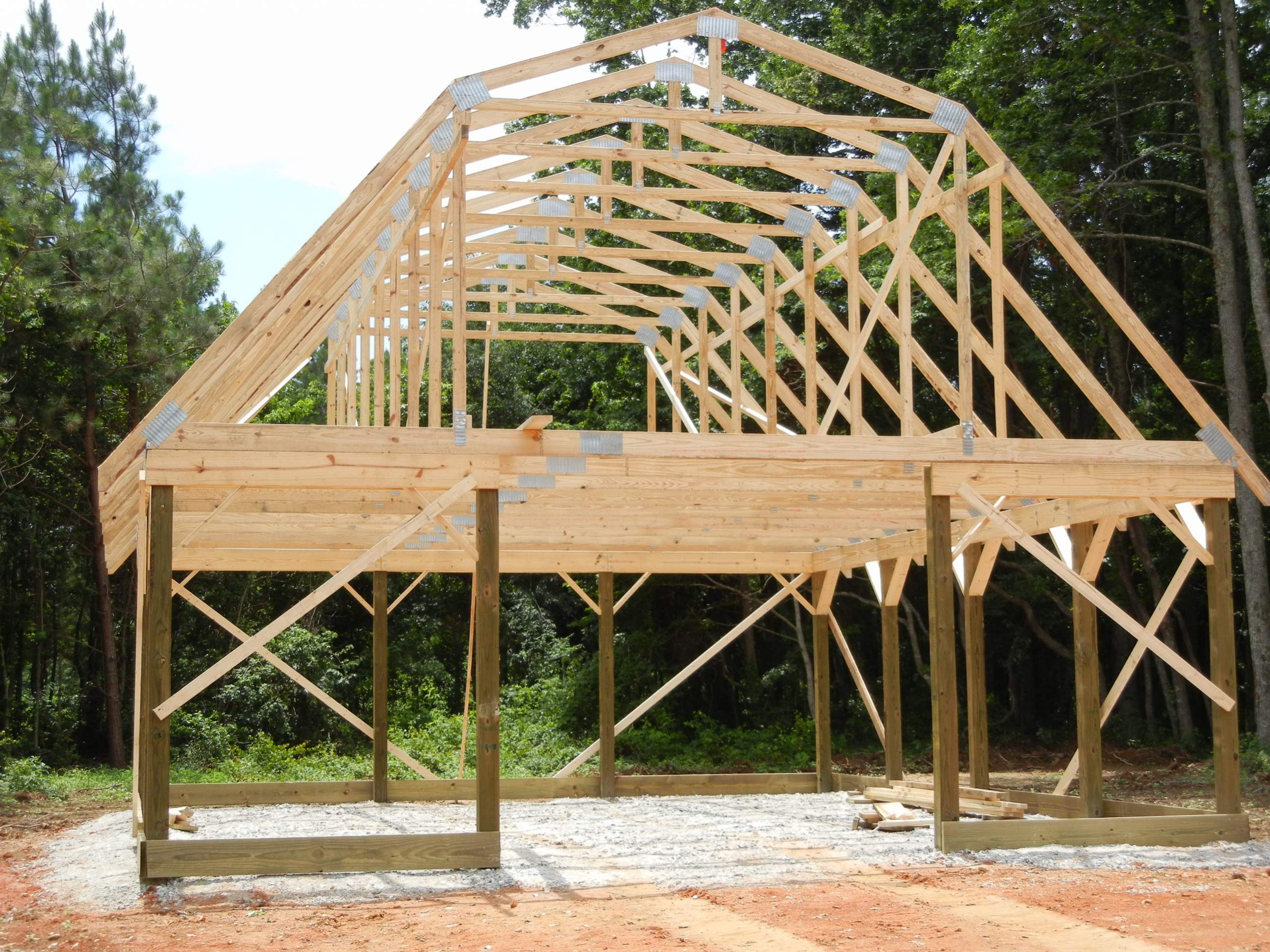

Frame and Braces...

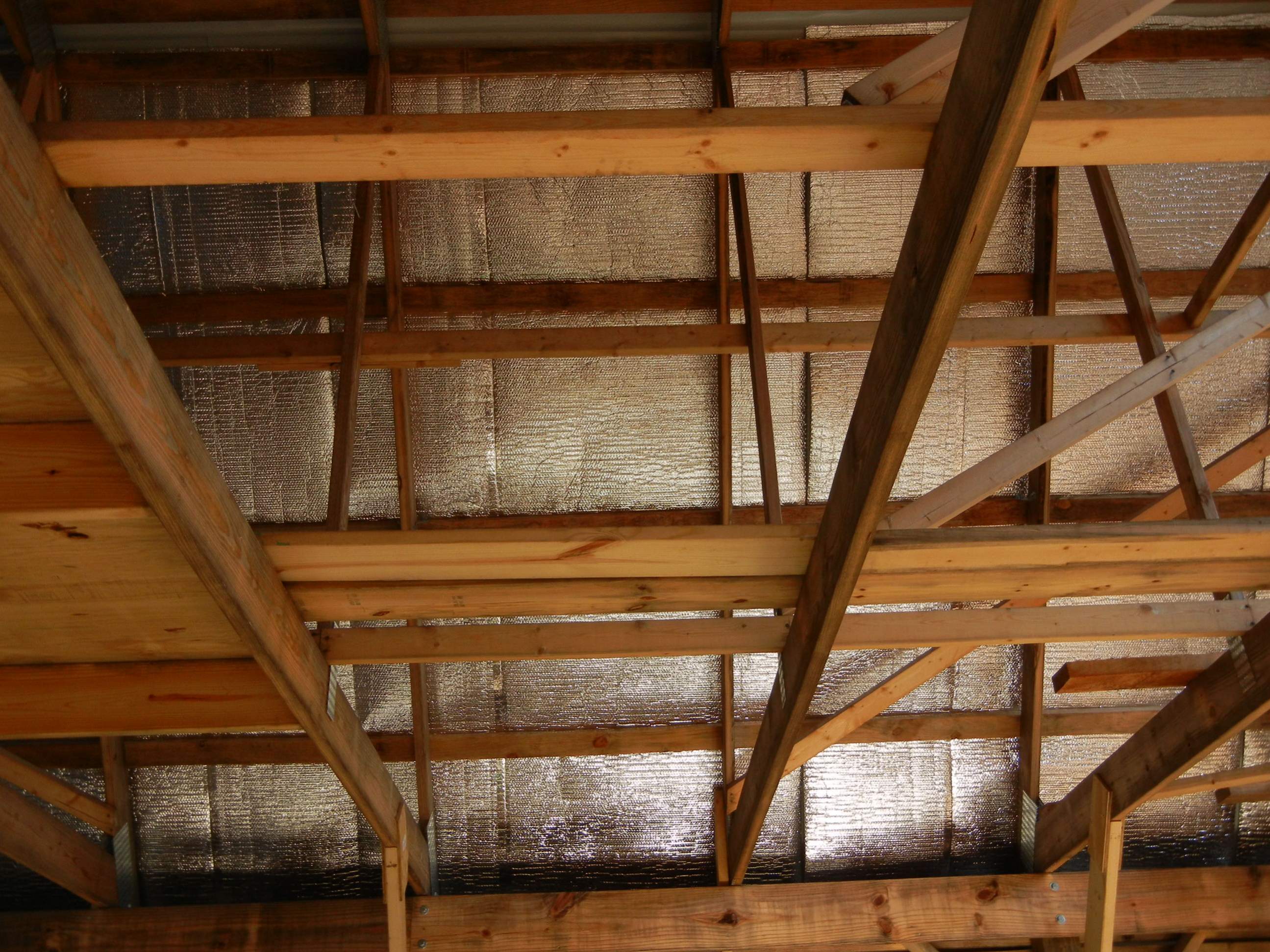

Bubble insulation to help prevent condensation - the seams are not yet taped in the photo.
The roof pannels are double screwed to increase the wind rating.
The soffits and fascia are covered in brown metal.

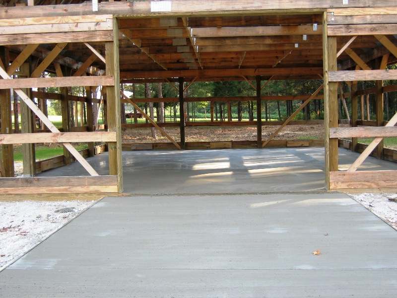

Floor is 4000 psi fiber reinforced concrete, vapor barrier, 14 yards. No wire or re-bar.

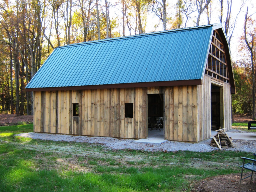

/ 'nother pole barn

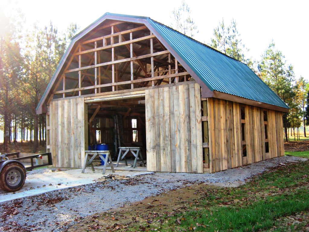

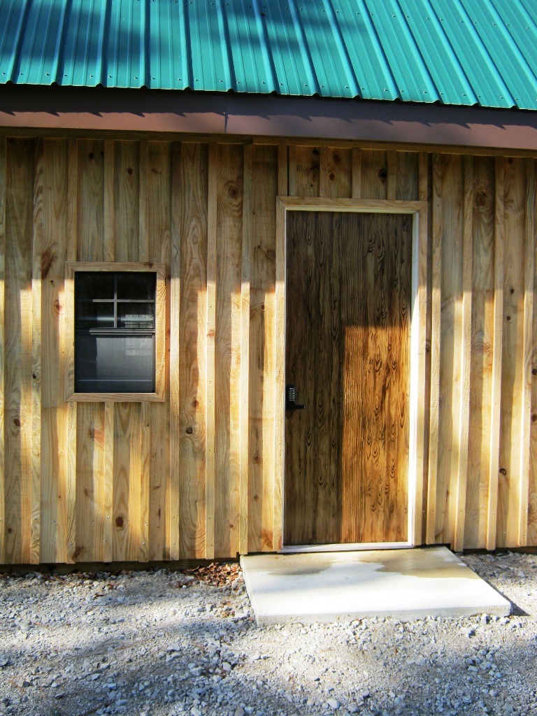

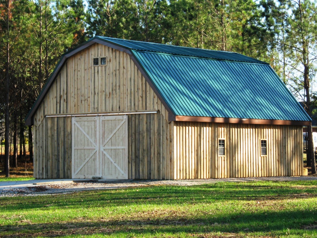

Siding is on, door awning remains to be done, along with the door latch hardware and some adjustments. The one side has been cleaned in preparation for borax treatment and stain.

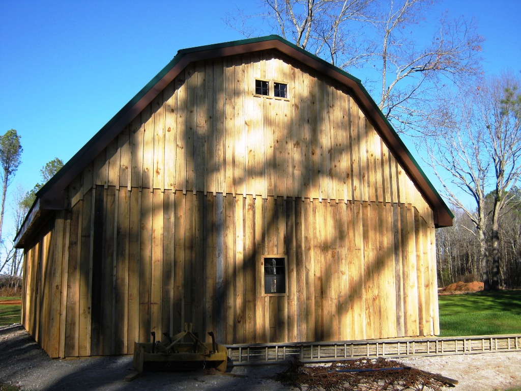

The siding has been cleaned. I used bleach with a few squirts of Murphy's oil soap. Sprayed it on and let it set for about 15 minutes, then rinsed.

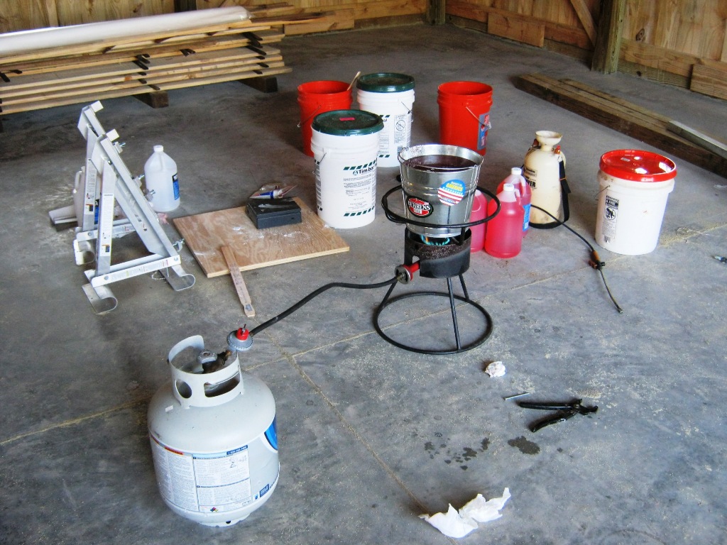

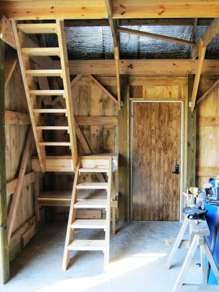

Cooking the borax and Rv antifreeze, just warmed it a bit so the Tim-Bor would better dissolve. 1 coat of 15 % soultion inside and out. We applied a faux wood finish to the metal door - its chestnut brown gel stain with Rustoleum sand color as a base. Steps lead to the loft. Next week, weather permitting, we'll apply the Woodguard stain.
I got the rescipe for the Tim-Bor here...

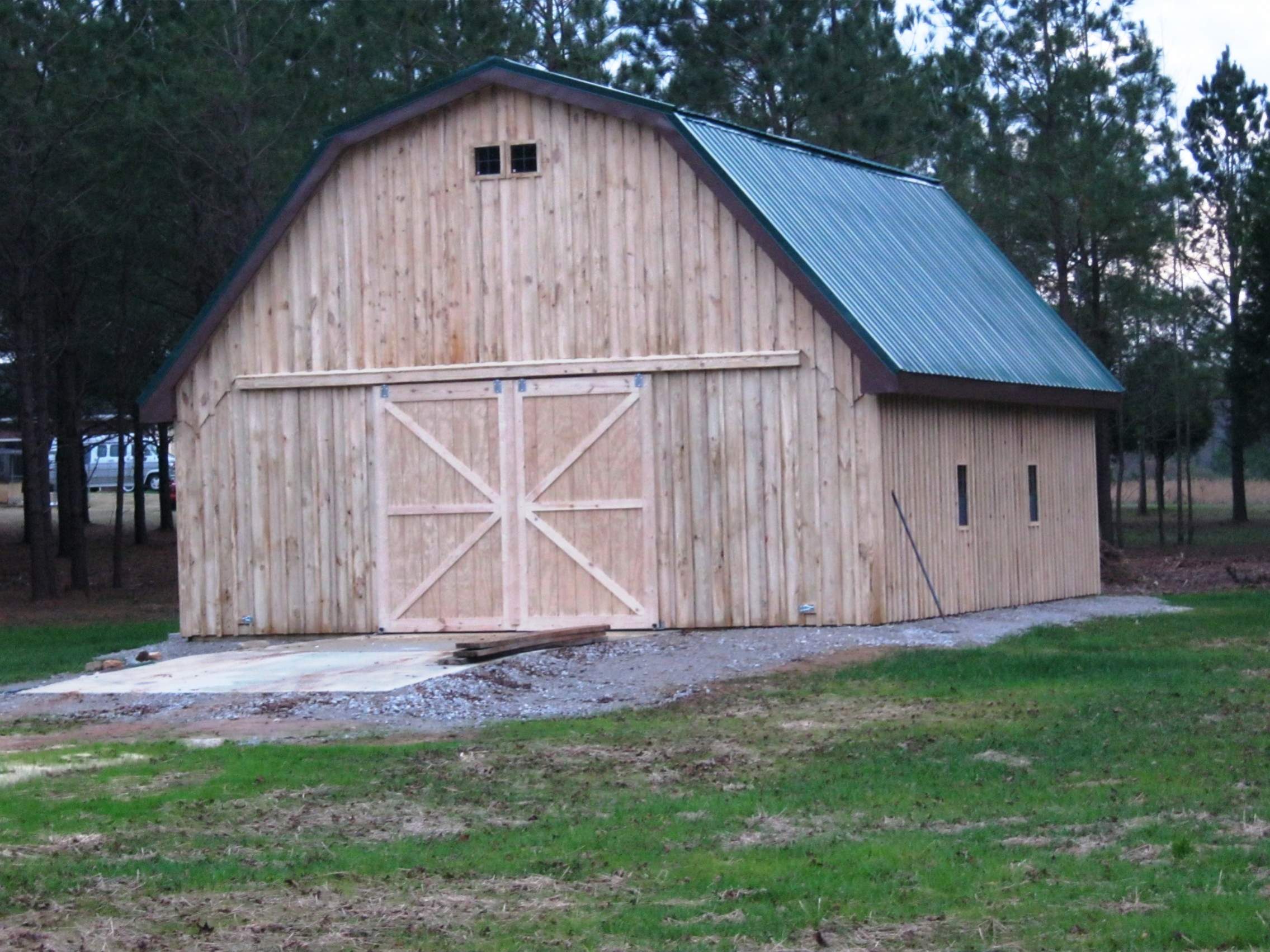

Stain and gutters on -- finally! Need the gutters to protect the siding from the roof run-off splash.
11 gallons of Woodguard Warm Pecan. Next month I'll do the clear -- after its cured for a month or so.
In the spring, I'll bury the black drain pipe.
Tony
