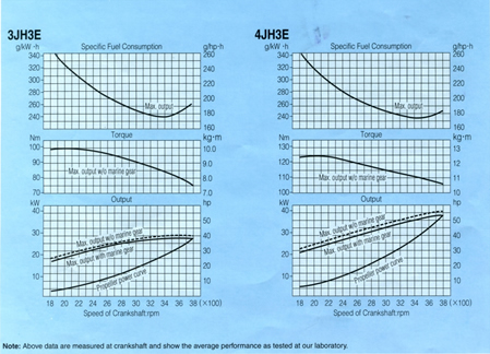

For anybody interested in actual facts about fuel consumption for tractors of varying horsepower, but the same displacement, we can thank the Nebraska Tractor Test protocol for absolutely refuting the kinds of nonsense some folks claim.
The Deere 4x20 series all had the same engine setup....4 cylinder, 2.4L, turbo-charged engines. Three of the four were tested, with the following results:
4720 - 51.77hp PTO, and 3.3gal/hr.
4520 - 46.58hp PTO, and 3.0gal/hr.
4320 - 41.58hp PTO, and 2.9gal/hr.
For those really quick folks, you'll notice that the bigger engines made more horsepower for each gallon of fuel used per hour.
4720 was 15.68hp per gallon, per hour.
4520 was 15.52hp per gallon, per hour.
4320 was 14.33hp per gallon, per hour.
Yep, the 4720 was more efficient than the smaller engines. Dial it back to make the same power as the smaller engines, and the fuel consumption would be either identical, or so close as to be a non-factor. Even if you ran them at PTO speeds and "wasted" power because you sized your implements wrong, and it's still not going to add up to a massive difference for folks who use their CUT the typical 100-200 hours per year.
Go from the 4320 to the 4520, and you're going to "waste" 20 gallons per year if you ran at PTO speed all the time (200 hours which is on the high side), and didn't need to because your implements were the wrong size. In reality, you're not going to be at PTO speed all the time, so it's going to be less than that....holy, moly, it might be $30 a year or some other catastrophic figure!
great post
- i couldn't help but notice in that original Yanmar graph that was posted earlier,
it appears they had left out actual kg per hour fuel use at RPM ... Actual fuel use increases with higher RPM
