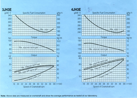

People automatically assume higher horsepower engines burn more fuel at all times, but that isn't always true. In many cases the higher horsepower engine burns more fuel at all times because it has a larger displacement, so pumping losses are higher and larger components have more friction, parasitic losses, etc. In this case, the Kioti NX engines are all the same size....same pumping efficiency, same friction, etc. The higher horsepower models are tuned differently (injectors and turbo settings), but that isn't going to make a big difference in fuel efficiency to put out X amount of horsepower. If you put all four engines on a test stand, and set them for something like 35hp at the PTO, they're going to be using about the same amount of fuel. In practice, the larger horsepower models will use a touch more fuel because they will be making more power at PTO speed than the lower horsepower models....but it's not going to be a huge difference.
As noted in my recent post, this is wrong. A 60hp engine will use more fuel than a 45hp engine to produce any amount of power below 45hp. Engines are most efficient close to their max RPM which for practical purposes is PTO speed RPM. Here is the specific fuel consumption graph for a similar size Yanmar again below. Look at the left upper chart area which shows fuel consumption per unit of power by RPM. Note higher specific fuel consumption at lower RPMs. It isn't a minor difference. Looks to me like at 2/3rd power (compare to about 40hp with a 60hp engine) the fuel efficiency is 1/3rd worse per unit of power produced at non PTO RPM than at PTO speed (The Yanmar "PTO" speed is about 3400). These graphs come from a slightly larger Yanmar but the principle is the same. Diesels are most efficient at about PTO speed and operating them slower consumes more fuel per unit of power. A 45hp engine putting out 40hp will therefore consume less fuel than a 60hp engine producing the same 40hp. Daedong has these types of graphs too but they no longer post them on their website.
If you need 50-60hp most of the time then surely that is the size engine you should get. However if you think spending extra up front for the "insurance" of having extra power on a few occasions down the road, recognize that you not only pay more up front but you pay more at the fuel pump every day too.
