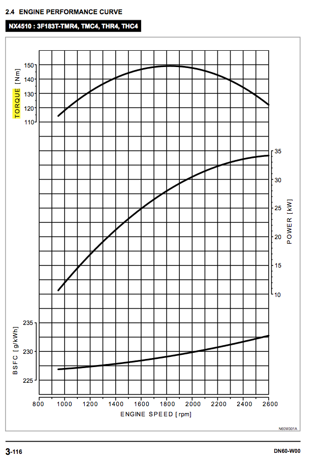

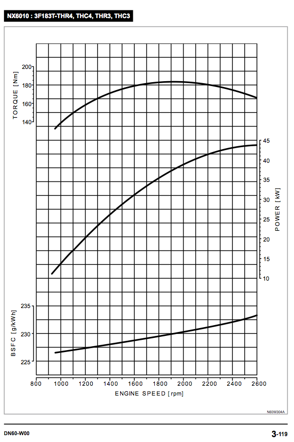

Kioti does publish specs on their engines. Simply because you don't know where to look, doesn't mean Kioti is trying to hide anything.
As you can see the 60hp version not only has more horse power everywhere, it has more torque everywhere. The 60hp version is simply a more efficient engine.
414601d1425320643-nx4510-nx5010-pricing-review-screen-shot-2015-03-02-a
414602d1425320660-nx4510-nx5010-pricing-review-screen-shot-2015-03-02-a
Power (HP) = 1kw = 1.341 HP
Torque (Nm) = 1 newton meter = 0.737562149 foot pounds
The 45 hp version offers a maximum of 109 ft. pounds of torque.
The 60 hp version offers a maximum of 140 ft. pounds of torque.
Basically, the 60 hp version offers roughly 30% more hp and torque. 30% has value. To frame how much more power the 60 hp version of the NX has over the 45 hp version, from 1050 rpm and onward, the NX6010 develops more torque than the peak torque of the NX4510. That extra power has value.
