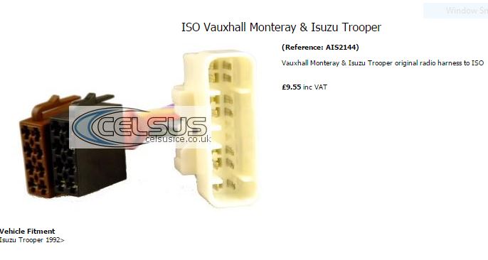

I know I'm coming into this thread - way after there have been many answers - but for anyone in Europe (and possibly the US too) looking for a plug and play solution, then the answer to convert the Original Radio Harness in the Cab version of recent Kioti Tractors To ISO connectors is the Celsus AIS2144 connector.
Just search Google for "Celsus AIS2144" and you should get lucky.
Mine worked like a charm.
If you can't find that, then search for "ISUZU RODEO, TROOPER 1995 ONWARDS ISO WIRING HARNESS ADAPTOR"
That should give what you need.
Below is a picture from the Celsus website.

Diesel, I just looked at the factory OEM connector that I snipped off when I hardwired my aftermarket radio. Comparing it to what you linked to, I can't tell from the picture whether it would mate up. Instead, I think I'd order one of these, which sounds more like what Mudplugger referred to: Amazon.com: Scosche Radio Wiring Harness for 1995-Up Isuzu/Honda/Acura Connector - Sport Utility Vehicles: Car Electronics It's for Izuzu Rodeo Troopers 1995 on. At $4.95 incl. shipping, you wouldn't be out much, and the reviews are better.
Can't help you on the speaker question, but I'm sure someone else can. I recall a TBN thread on it somewhere, awhile back. I think the stock speakers are fine for a tractor, even with a cab. Especially while wearing ear protection! But since you'll probably be removing the cab roof for access to install your radio, now is probably the time to switch them. BTW, you'll need a second person to lift the roof clear. It's heavy. You may also be able to get enough access, at least just for installing the radio, by propping up the roof. I did my install from inside the cab, but my radio is light weight, so I didn't need to use anchoring hardware on its backside.
