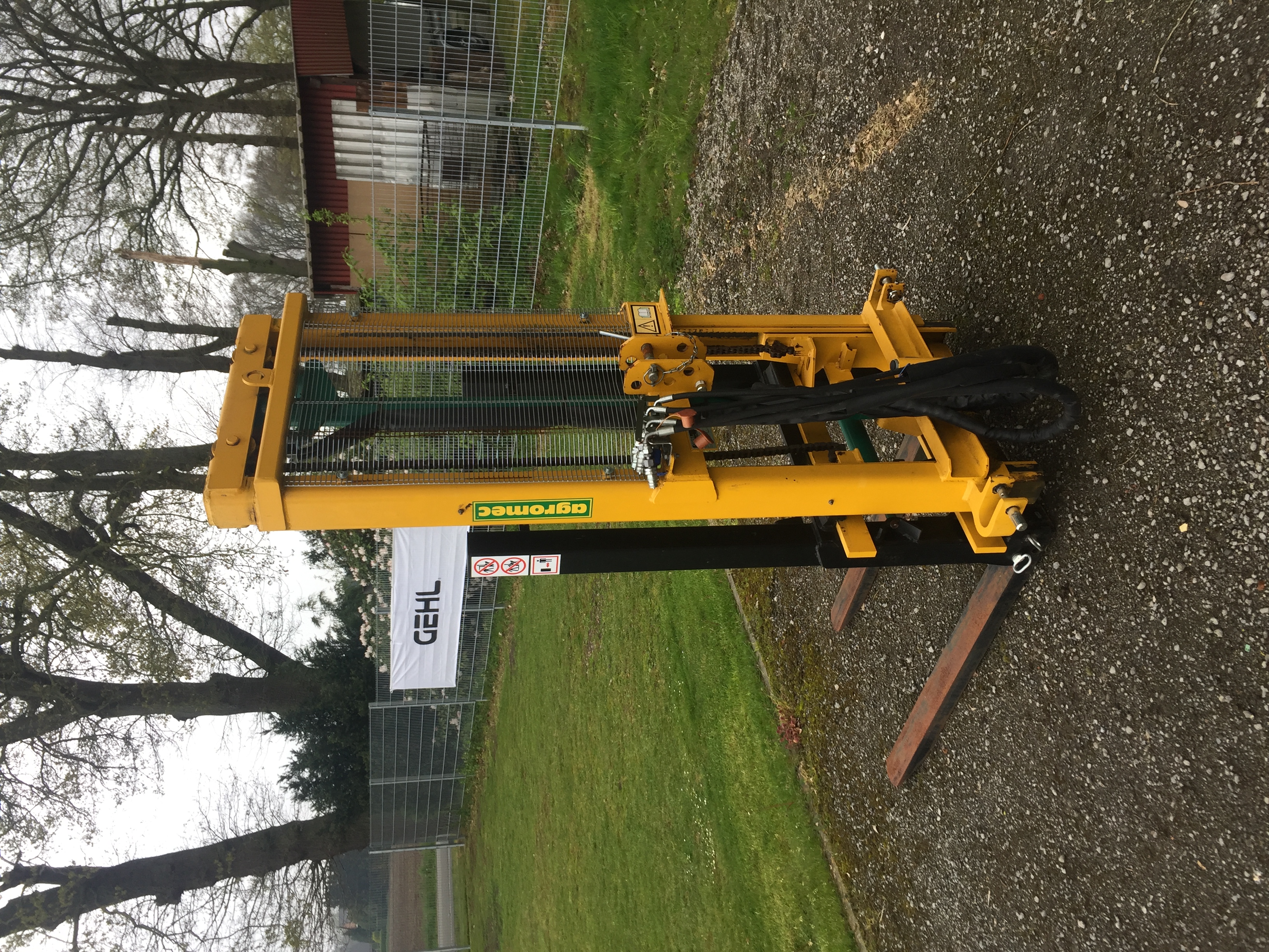

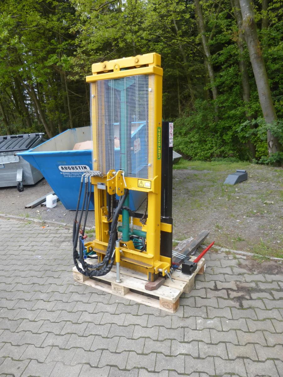

Probably a new topic here really, but I'm pretty sure it's a function of having the load hung out so far in front of the front axle and the "effective weight" of it at the FEL pivot is therefore multiplied and at, or just above the limit.
Not only that, but without at least 600kg on the back of the tractor, I end up lifting the back wheels... The size of the load coupled with the distance on a big pallet - is just too heavy, and hung out too far in front to be safe..
So I searched t'interweb as we call it here - and found a 3 point hitch forklift in Germany - not much wear, and at the right price... palletised shipping did the rest and so now I have a solution..
This solves the problem, with the weight at the back of the tractor and close to the rear wheels.
Greater lift capacity, greater height and with "rear wheel steer" - far easier to get pallets into tight spots.. :
