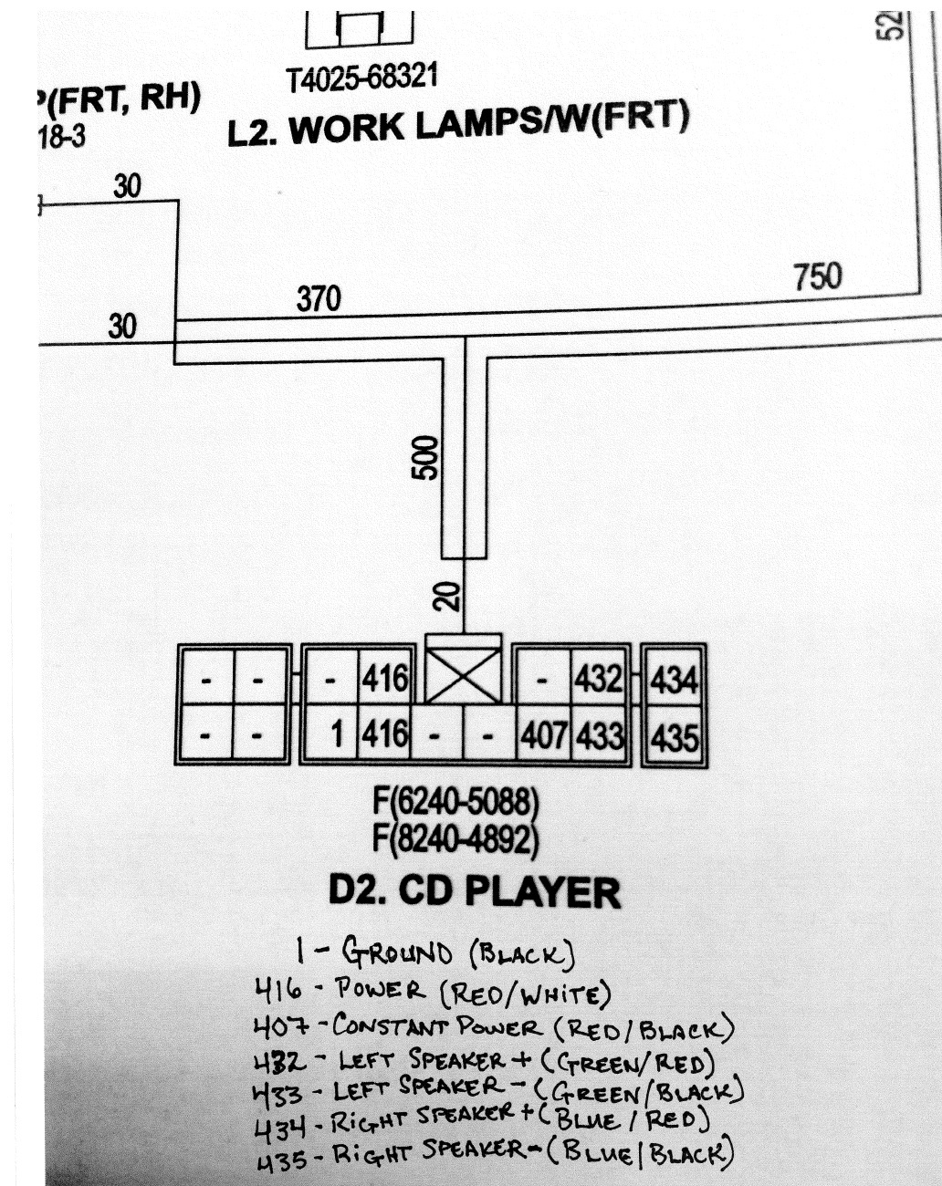

/ NX5510 radio plug?
#9
That appears to be the same form what I can remember, I just cut the factory plug off and wired on the new radios plug.
/ NX5510 radio plug? #10
I got here too late to mention this. I put a radio in my LS cab tractor. I didn't even bother trying to locate a plug to mate with the LS radio plug. But I didn't cut it off. I installed small red male spade crimp connectors on the radio wires and plugged them into the tractor factory radio plug.

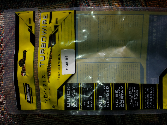

Best buy this is plug fits nx series
Bobfarm41, thanks for this, and welcome to TBN! I pulled up the manual for that plug on the Crutchfield.com website (pdf attached below), and from the diagram it indeed appears to mate to the Kioti plug on the NX series, with corresponding terminal functions, plus has some additional terminals that would not be used by the Kioti harness. Have you confirmed this with an actual installation? I ask because things sometimes aren't what they appear from the import manuals.
