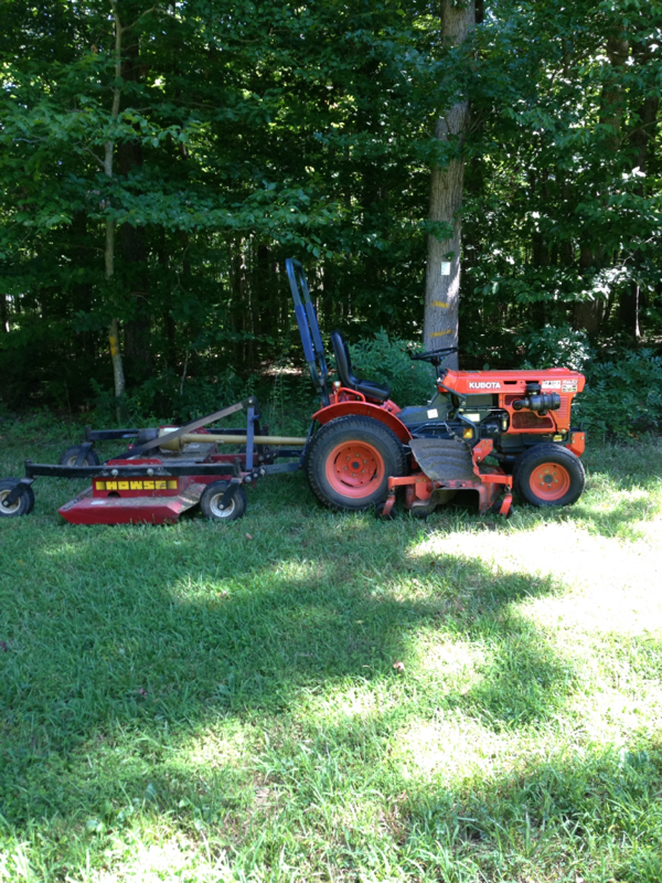

I have a finish mower and a belly mower. The finish mower does a better job because it has a blade tip speed of 26,000 FPM. The finish mower is also easier to remove than a belly mower. The belly mower is slightly easier to mow with especially if you have obstacles to mow around. I have a 72" finish mower bought for a L3240 which pulled it great. I have to keep the L3240 at another property to perform actual tractor work so we bought a B7100 to take over the mowing. The B1700 can pull the 72" mower ok as long as the grass is short and the ground is flat, but since it only has 17 engine hp it is a little lacking. As long as the ground is flat a BX25 should be able to pull a 72" mower. My finish mower has 7 gauge deck construction and weighs 750 pounds. Since the tractor only weights 1,200 pounds as you can imagine it doesn't do well on hills. The finish mower had been in storage since the L3240 was retired from mowing. I had to move it one day because it was in the way. The only machine I had was the B7100, so I hooked it up and pulled it out of the way. I decided while it was hooked up I might as well take it for a test run. I was surprised at how well it handled it, and I have used it to cut the field several times. image-3871745521.jpg
