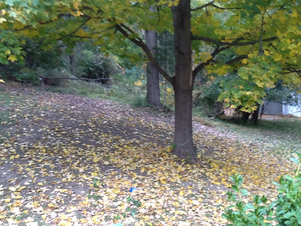

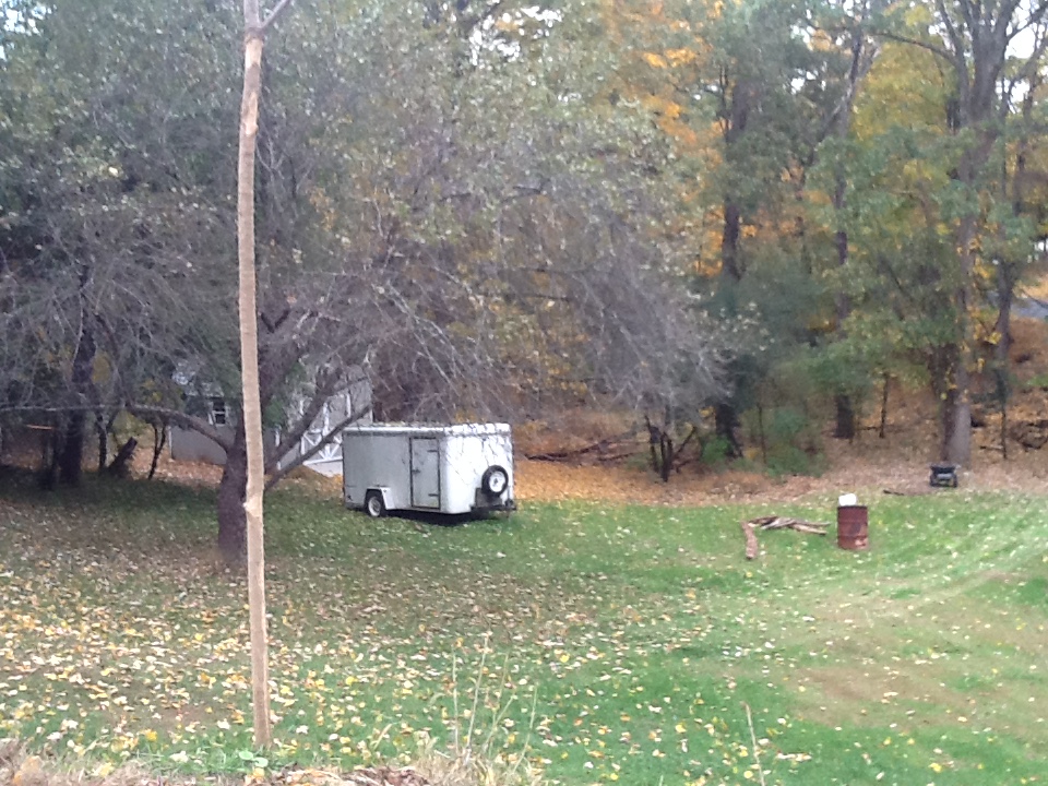

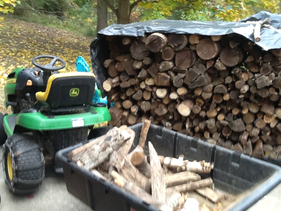

So id figure id put some pictures up:). Burning already :). The woods in the back is what i would like the clean up allot brush amd downed trees back their. As far as tires im guesing i need the easier on lawn ones. If you look closely kn my JD i have these kevlar attachments i use all year round, pretty awesome For me. Doesn't ruin the lawn or driveway. I am seeing some stuff online that i might go look at next week.
