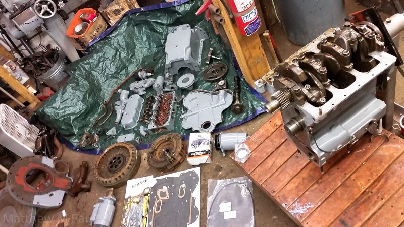

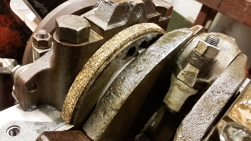

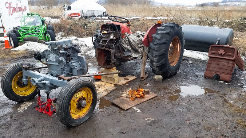

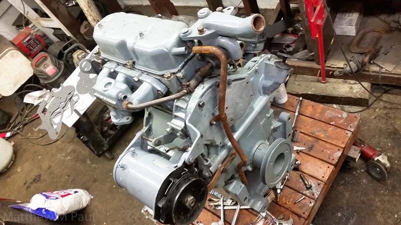

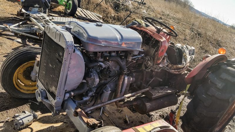

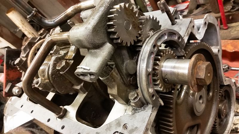

I got some more work done on the machine. I got most of the parts laid out, cleaned up and painted, and the gasket sets in. SO, I started putting the engine together. It's an interesting mix of seals and gaskets that they used. A two piece rope seal on the rear main, a one piece modern seal on the front main, cork strips on the end main bearings for the oil pan..
It turns out that the generator bracket on this engine is really an alternator bracket, so I had to make some spacers to make it work, You can see them in one of the photos.
I also found out the back story on the tractor. It just so happened that a friends father knew the guy that died that owned it previously and the guy that I purchased it from and verified the story. It came from less than a mile down the road from me, originally. The previous owner was taking it apart to restore it and passed away on the way to the hospital. I know his sons, but I did not know that when I purchased the machine.

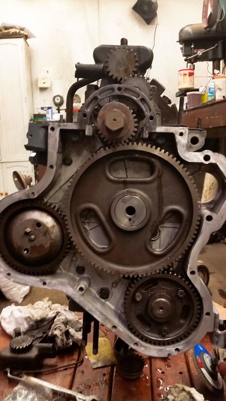

Anyway, I put a new oil pump in it.

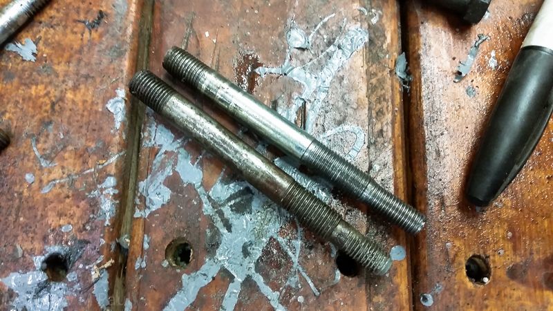

One of the studs for the valve cover were missing, and I could not find anything suitable, so I turned down a new one on the lathe. The top stud is the one that I made:

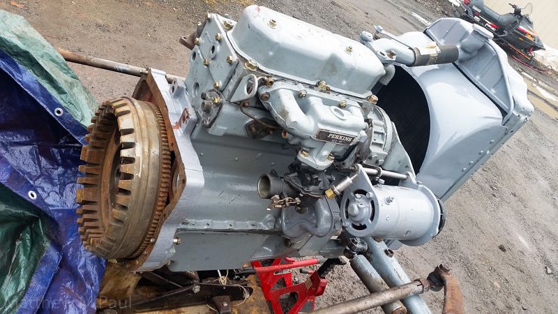

I got the motor mostly together.

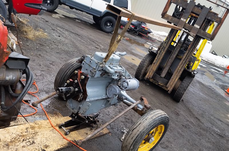

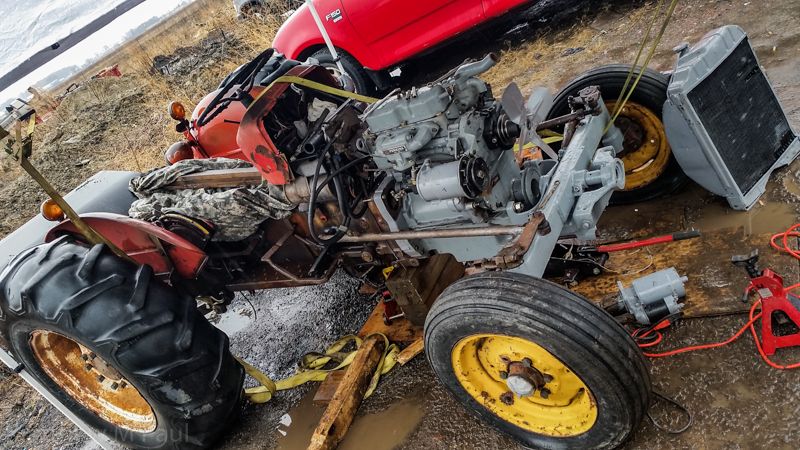

and pulled it out of my shop with a friends forklift.
I got the front end bolted to it. Im still waiting for the pilot bearing, otherwise I would have just hung the engine on the transmission.

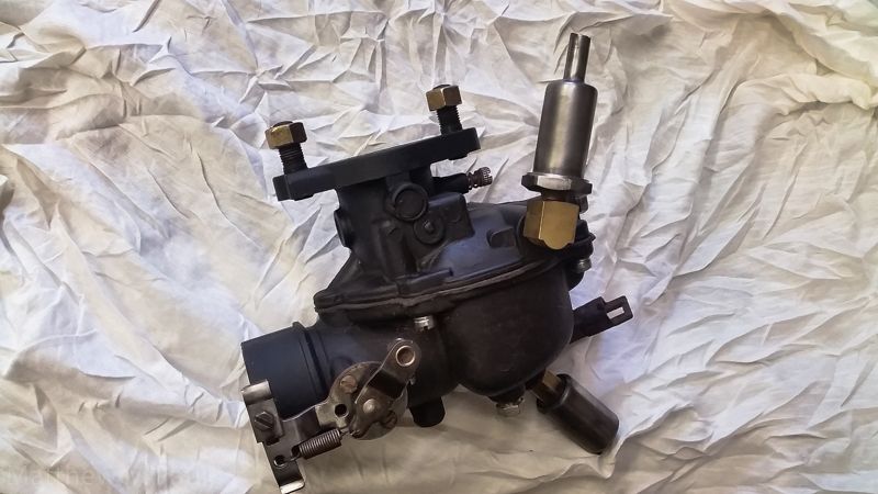

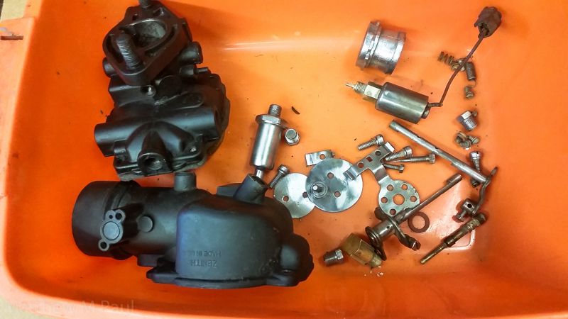

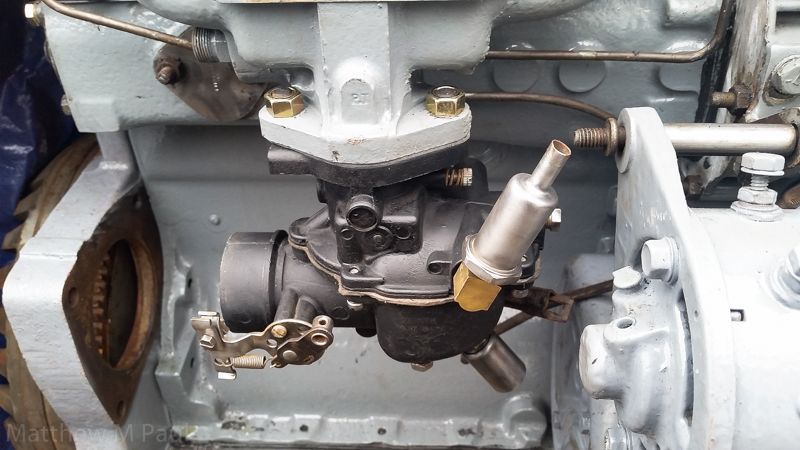

Then I got started on the carb. It seems as if you cant get complete kits for these zenith carbs, So I just refurbished all of the parts, and made a gasket.

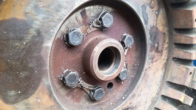

I got the adapter plate mounted, flywheel on, and since those silly keeper tabs for the bolts all broke when I took them off, I just cross drilled the bolt heads and wired them.

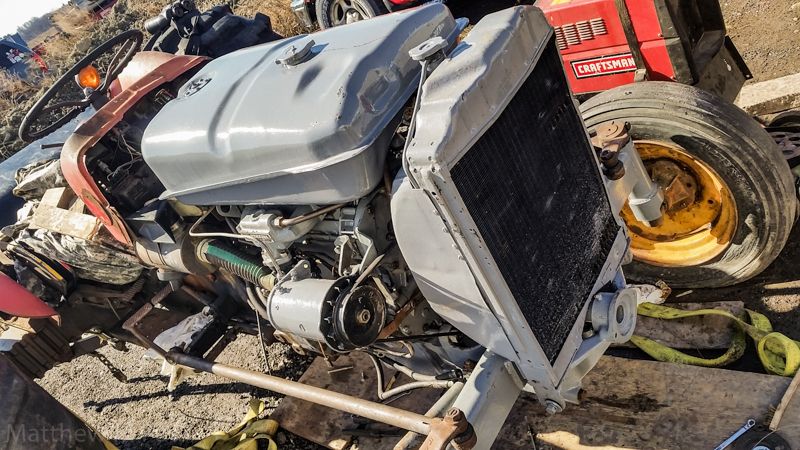

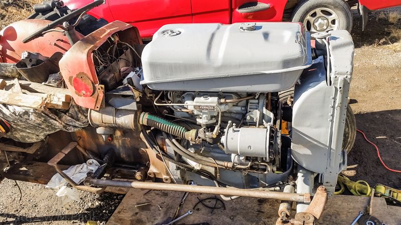

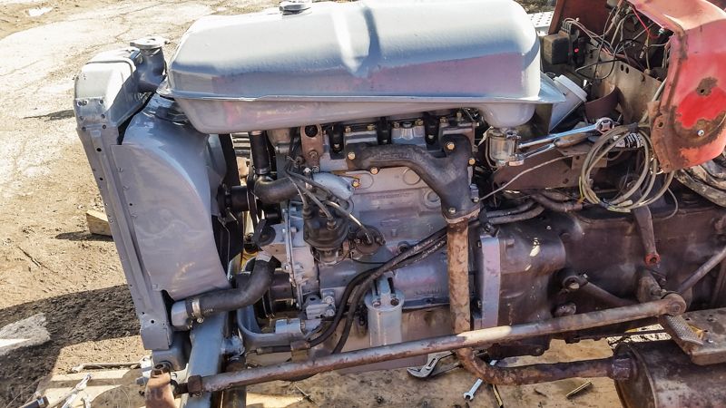

I got some more work done. I got the tractor back together, pilot bearing in, etc. and bolted the two halves up.
Waterpump, fan, coolant hoses, coolant temp sensor, new coolant temp gauge, Air hose, and so on...
Fuel tank, radiator, hydraulic lines for the steering, Welded one some muffler that I found in the dumpster (just temporary. Im not spending any more money until I know it runs), A lot of the wiring is in place. Base timing set, plugs in, wires made and on. Im just waiting on the starter, battery, and cables. Then we'll see what it does... The starter in the photo was the the correct one.

Neat tractor, great work, and thanks for the updated photos. It's odd that the top of the cylinder sleeves stuck up as much as 1/16 inch. They're supposed to protrude a bit in order to seal well with the head gasket, but not that much. I wonder if the block was decked once before, causing the new sleeves to stick up too much ? Did you remove the sleeves to check under the sleeve lips, and to replace the coolant seal O rings at the bottom of the sleeves ? It's possible that the engine was taken apart a second time to deal with coolant leaking past the O rings and into the crankcase.
( I'm using Ferguson TO-35 knowledge here, and I may not have my details correct. However, when I replaced the head gasket on my engine, I did not try to remove the sleeves , using the " let sleeping dogs lie" approach. It burns a little oil, but that's ok.)

BTW, from memory I think they are dry liners - no seals involved.

Thank you. Like Patrick said, I believe they are dry sleeves on these.

I got it running. This is the first crank and it started right up.
   / Oddball 135 Rebuild
#20
After it warmed up just a little bit
