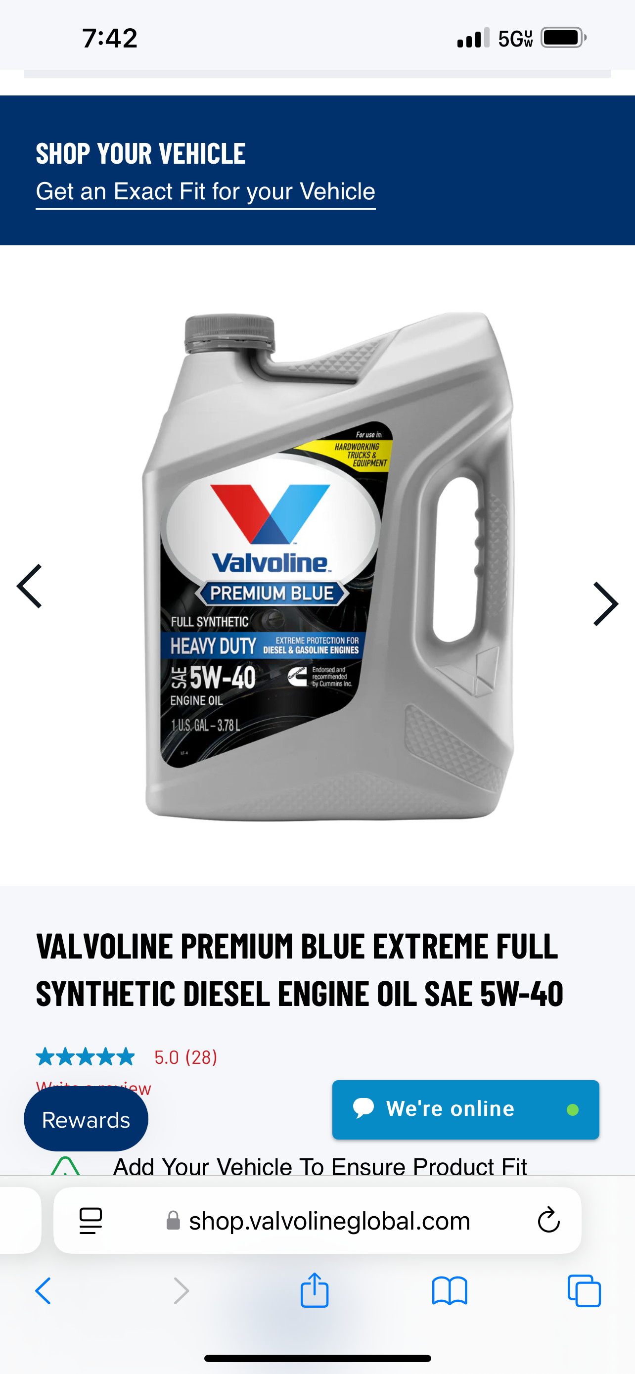

Good deal, and thanks. I might have to check it out sometime. I'm always shown the blue bottle from Valvoline in Googe searches. Right now I already have bought some synthetic Chevron Delo for my next oil change, as I found it on sale for a good deal last year, and bought it in bulk.
I've started running that new "Valvoline: Restore and Protect" oil in all my gas vehicles. Valvoline is definitely some of my favorite oil, and generally the brand I use for modern ATF fluids like LV or ULV fluids(I prefer Redline D4 for systems that use older, regular ATF fluid) and gear oils, etc.
