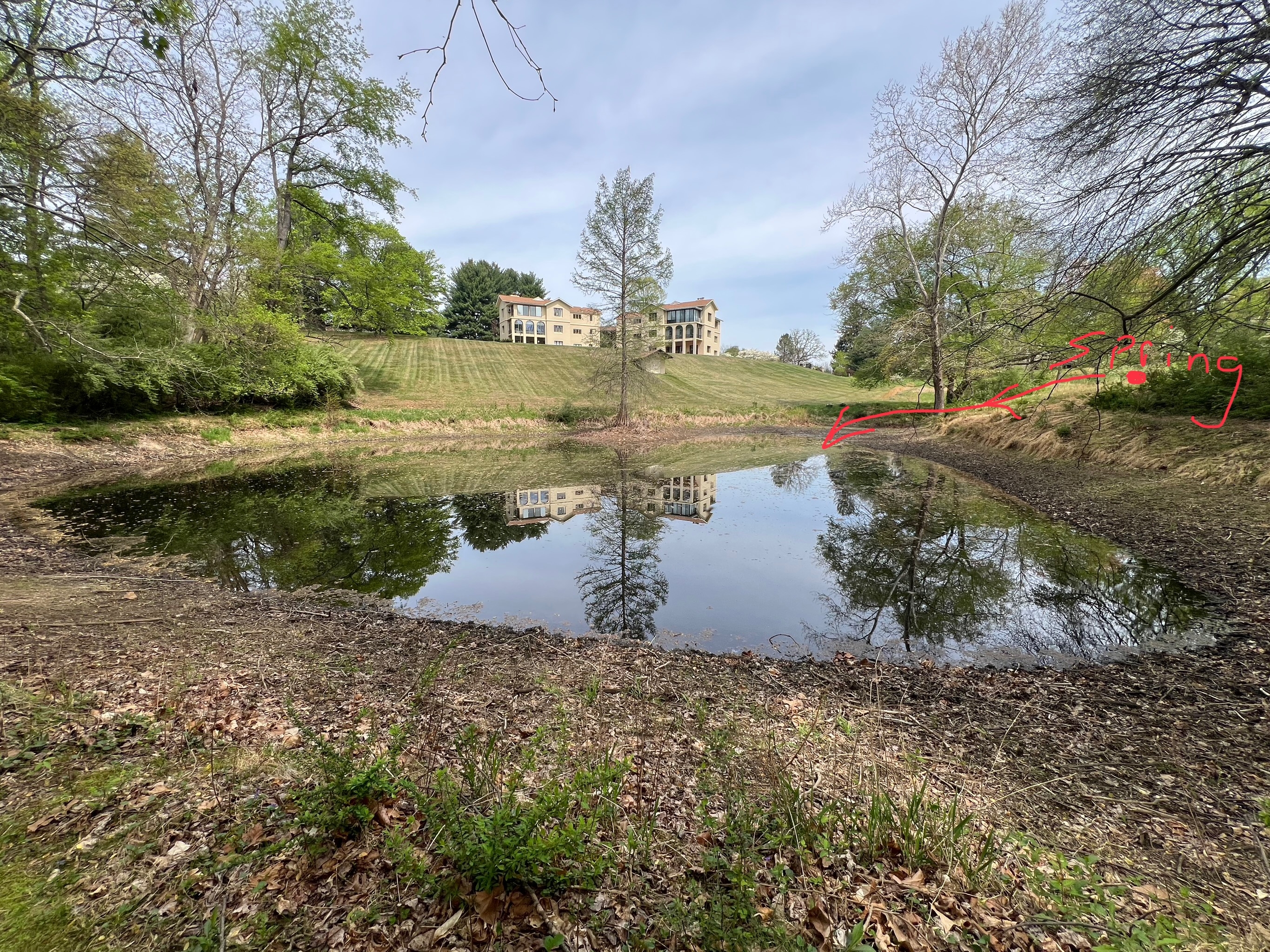

Have a long time customer. It's a large acreage HOA with several fields to be hayed and large grass areas to be mowed.
They also have 3 small ponds.
1 pond is spring fed. The spring has unexpectedly dried up. I dont know a lot about the life cycle of springs, so I don't know if they can also come back to life, but it's been on the decline for about a year.
The pond is down to 10-20% (best guess). Water is evaporating, so diminishing with each passing day. There is no other natural water source to replace it nearby. The property owners would like to keep the pond, but are not of unlimited wealth.
Here is the only 2 ways I can think of to replenish the pond:
1. Drill a well. But how much the well gives in GPH is anyone's guess. Very rough estimated cost is about $10,000.
2. The current building the owners live in is uphill from the pond, about 300-500' away in a PUD building of 6 condominium units. Only a small part of the building currently has gutters and downspouts. I was contemplating installing hundreds of feet of 5" gutter, with 3x4 down spouts on the building and running all the down spouts into a continuous rain water retention system. Rather than running the underground pipe into a typical large stone pit, instead run the water directly into the pond.
Realize there's no guarantee it'll rain enough to keep the pond full, but other than that, that's the only reasonable sources of water I can come up with. The roofs areas are pretty large. I suppose there's a roof water runoff calculator that can help calculate.
Another noteworthy point is the other ponds, about 1/4 mile away each, are also spring fed, but not low on water. So that tells me it's probably not a drought issue?
This is all in the "talking/ideas" phase. I have installed several rainwater retention systems, so this is nothing new for me from an installation perspective.
I just don't know if it's enough water?
Pond is triangular about 150' on each leg and averages about 4-5' deep.
Don't want to install something that won't work or lessen my reputation with customer. Another thing definitely worth mentioning is the customer also has some desire to have gutters and downspouts installed to get roof runoff away from the building, so there could be a 2-fer type of benefit in helping to keep water from damaging building foundations

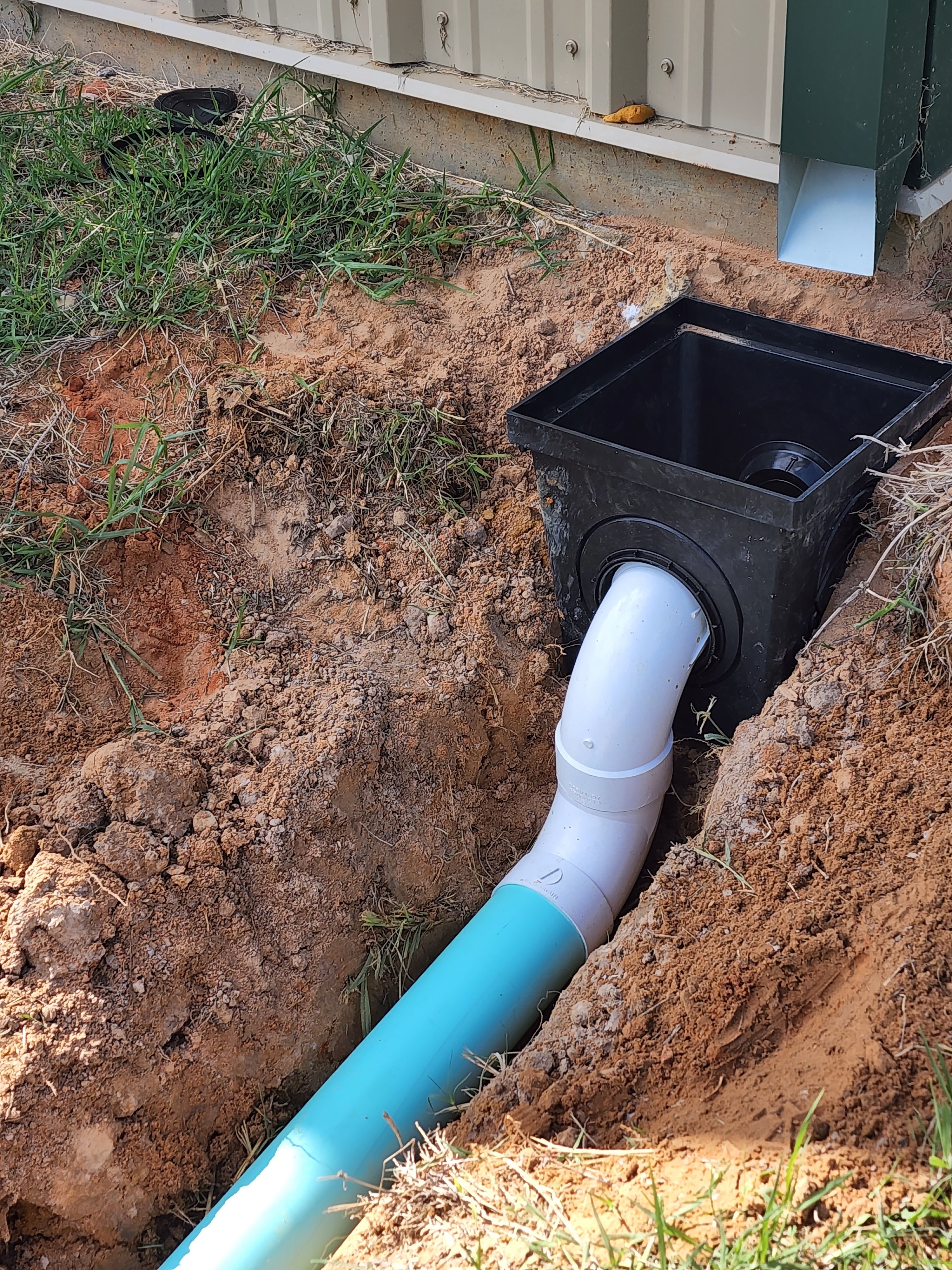

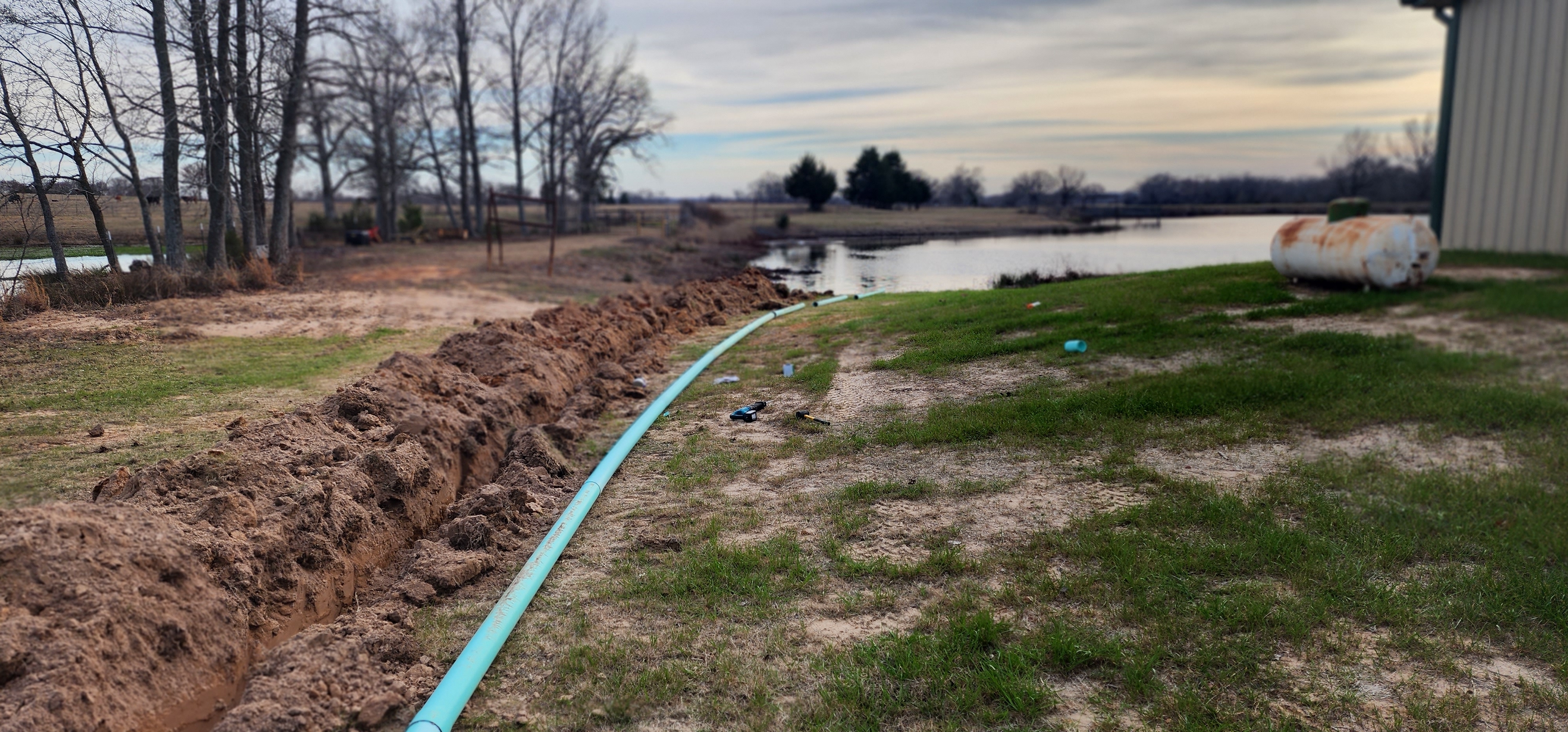

Here in East Texas the summers can be brutal on ponds.
Two years ago we had two months of 100+ temps and not a drop of rain.
We live on a 6 acre pond... shared with a neighbor. Runoff when it rains is plentiful as there's 100's of acres all around us in the local watershed but when it doesn't rain, wind and heat do a number on the level.
We see drops in water level of up to three feet sometimes.
We moved here four years ago and it had been a really rainy spring when we got here. The front yard was a swimming pool with 2" of standing water.
I was told that there was a spring but apparently it's not doing enough.
Long story short, bought a backhoe and installed catch basins under every downspout (12) and installed 3 12" concrete drain boxes out front.
It's all done... grass has come in and I notice that when it does rain, the pond fills quicker.
Front yard can get overwhelmed during hard rains but as soon as the rain stops it instantly drains out to the pond.

If the square footage of roof foot print is equal to the square footage of the pond, then assuming it had vertical sides like a pool, in theory you could potentially add 43” (PA’s annual rainfall) to its height—over 1 year’s time. Those banks look pretty shallow, so I expect the actual water height increase would be much less.
Does the spring originate in the pond or above the pond? If in the pond you may be limited by hydraulic pressure and won’t see any improvement. Likewise, if there is a leak/drain somewhere.
You’ll have to play with the math based on roof area and slope of the pond.
From the house foundation point of view, 100 sq’ of roof foot print will collect 62.3 gallons of water per inch of rain—when it’s not coming down so fast it runs over the gutters. You need to move that somewhere else anyway.

It doesn't look to me like the rooftop water will make a dent. You seem to have a nice size natural drainage area. I suspect a leak. My suggestion; 1. drain the pond and see what you have. (preferably with a syphon.) 2. Look for a leaking area and the possibility of opening up the spring.
If you do route the rooftop water, consider using an open ditch (maybe with a liner or just a concrete bottom) to get the stormwater there quickly before evaporation or absorption.

A third option would be to line the pond. It would probably cost less than a well.
/ Offered another unusual project #58
I'd go up above where the spring surfaces and dig perpendicular to the hill and dig a ditch 20 to 40 feet long. I'd put schedule 35 or 40 four inch perforated pipe on plastic and gravel. I'd tee off the perforated pipe with solid wall schedule 35 or 40 four inch pipe.and trench it to the pond. Also pour a concrete headwall at the perforated pipe/solid pipe junction.
/ Offered another unusual project #59
I was thinking the same thing. Dunno about cheaper tho. There used to be a Bentonite type powder you could fan across the pond to settle on the bottom to prevent it from leaching out. Both methods would mean you have to know at what elevation the pond is fed from to avoid corking off your water supply.
