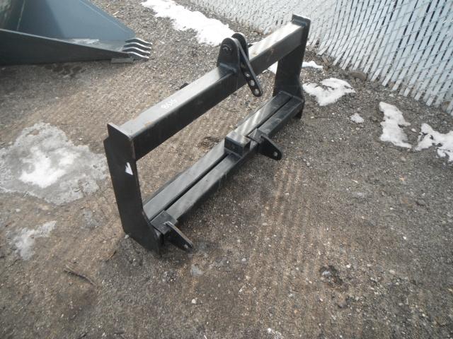

You may gain enough offset to be useful by adjusting your lower link stabilizers to swing the arms as far as possible to one side.
Or:
Make a frame like this skid steer 3-point adapter, but make the top attachment slide like the bottom ones.

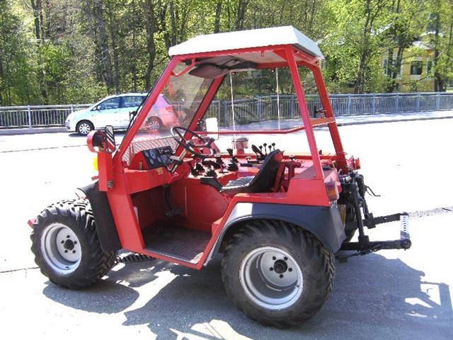

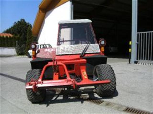

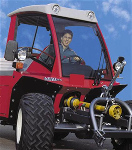

I think it is a good idea, I was responding to your request for "thoughts or suggestions".
AEBI put one on their front 3 point, for mowers.
Mähtrac Aebi TT 80 (Small).jpgMähtrac Aebi TT 80 48 hp (Small).jpgTT75_large (Small).jpg
These are very similar to what I was thinking. One could make a sturdy frame with two parts that slid on or against each other with the ability to lock them together. All one would have to to is unlock the frame slide mechanism, then raise the three point hitch and give the implement a good kick to slide it into a new position. Alternatively, some sort of mechanical or hydraulic slide movement mechanism could be used.
The second image closely resembles an idea I was playing with in my mind. BTW: That tractor (???) looks like it would be one handy little machine to have around the house.
