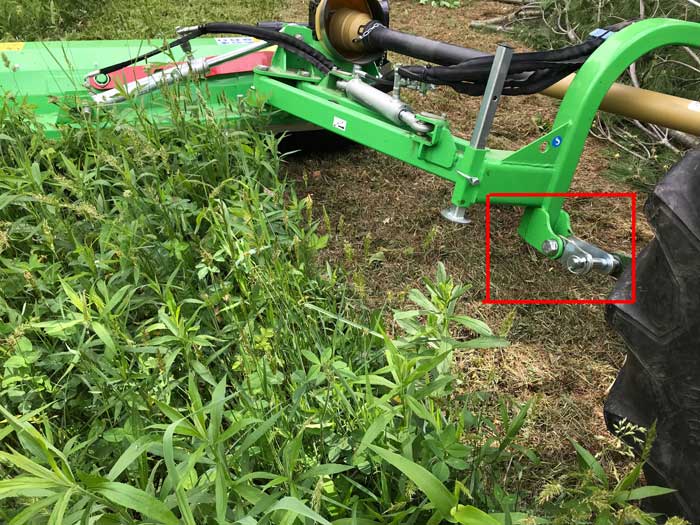

I posted earlier in this thread about my results with my new Peruzzo Fox Cross 1600 Ditch and Bank mower ... in short, it does a great job with that after one gets over the challenge of learning to move the three different controls in the right direction. :eek:

- I find the "safety link" to be a total waste, and an inconvenience. Peruzzo claims it will let the mower swing back if you hit an obstruction. But it only lets the right connection to the 3-point drop back 4 or 5 inches, so the mower, if extended will drop back a foot or so. But that's only if the link is in it's normal fully down position. In use it never is - there is no latching function so it's at least on a 45 degree angle most of the time when driving forward, and when going up hill it's fully back. See photo:
That changes the angle of the frame, as shown in the photo, and if you pull up to a tree or whatever with the mower offset and stop and lift the mower to back up it wants to swing forward as the link resets. A really bad design.

My Berti offset ditch bank mower has a very similar swing shackle. What I found is that if that shackle is running horizontal like in your picture, the three point is too low.
Try removing your top link while the mower is in the full extended position. Then drive forward and raise the three point arms up until that shackle is leaning forward only about 20 degrees while moving at your preferred mowing speed. You may also have to adjust the tilt a little to get it to track right. Then without moving anything, put the top link back on and if the top hole is a slot, adjust the link so it’s riding in the middle of that slot. Set the down stop on your three point lever so you can return to the same setting every time.

Thanks, 3Lfarms,
I had initially put the 3-point in float and the top link in a round hole thinking that would stabilize the cutting angle of the mower. I finally realized that won't work with the link, so I put the top link in the slotted hole and set the height so the mower is level on the shop floor. That caused the link to mainly set at a 45 degree angle when mowing.
When it drys out enough to mow again (we had heavy rains yesterday and the remnants of Alberto are due here the first of the week) I'll try your suggestion to see if I can get it to stay a bit more upright.
