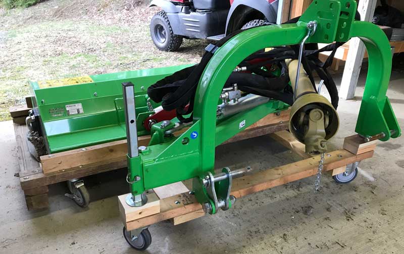

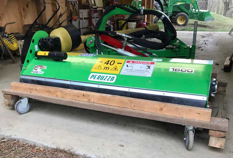

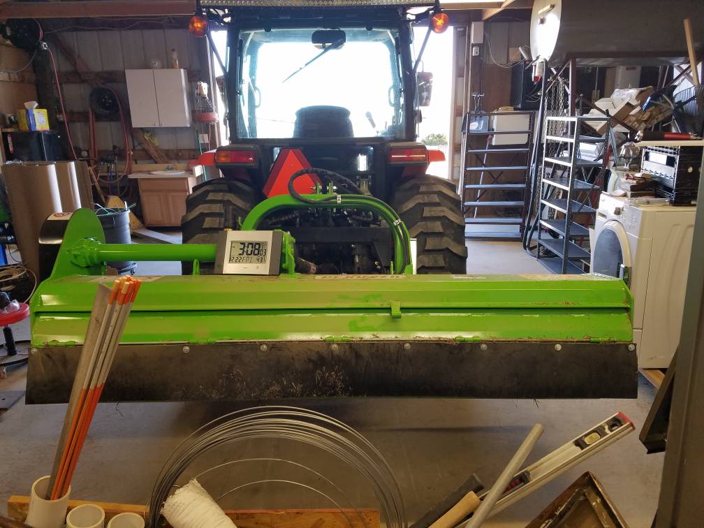

The calendar may say "spring" but it's still winter here, so nothing to mow yet. But it did get warm enough to work in the shop so I built a dollie for the new mower. It's a bear to hook up sitting on the ground, but very easy with these wheels under it. Here's a couple of shots, front and rear:

Thanks, Roy. I don't have welding equipment nor a stash of steel, so wood is my material of choice. On this one I started with the dolly from the tiller I sold this winter and extended it front-to-back to fit the body of the mower. Then I added the front part to support the front frame of the mower.
